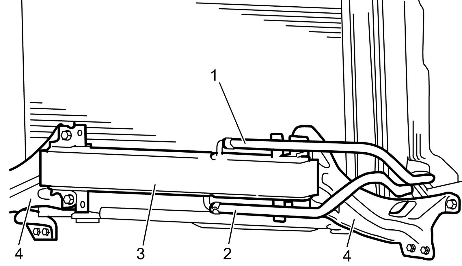

KuroNekko wrote: Vehicles that have dedicated transmission coolers tend to be full-size trucks with a towing package like the Silverado 2500 HD. In fact, you can see their dedicated radiators which look like mini radiators in front of the engine radiator. A car like the Kizashi would not have this as it's not intended for towing.
The Kizashi has both the integrated "in radiator" cooler and a separate dedicated trans oil cooler in front of the engine's radiator.
See below - item number 3
cvt cooler.jpg (153.5 KiB) Viewed 9390 times
Perhaps that might say something about CVT's and oil temperatures? They've certainly gone to a lot of trouble to cool things down.
murcod wrote: Perhaps that might say something about CVT's and oil temperatures? They've certainly gone to a lot of trouble to cool things down.
Another little tid-bit supporting the notion that the CVT may be a wee bit too small for the size car aye? Works harder and generates more heat that needs to be dissipated. Dual coolers...interesting. Murcod's the FSM guru 8-)

Thanks for that diagram murcod. I know from owning three cvt equipped vehicles that they do generate a tremendous amount of heat, especially during the summer months when you feel the fans blowing the heat beneath the car.
I appreciate these diagrams because it now tells me for sure that coolant could have gotten into the transmission OR it could again be a overheat issue for the fluid.
I didn't know that the Kiz had basically dual coolers though. Good to know. In truth we should all be servicing our CVT's every 30,000 miles or 50,000 kilometres. Would probably extend the life of the cvt a great deal. Mine just happened to break well before 50km lol
What even more interesting is that RRM made a upgraded module for their Kizashi. :?
I know keeping it too cool would be a problem, but I wonder if upgrading to the RRM part would be a bad idea on a daily driver...
KuroNekko wrote:Yeah, the fact that it has 2 cooling apparatuses is a bit scary. In comparison, a manual transmission has... none.
This isn't too scary to me. Auxiliary coolers are kind of commonplace in any situation where there might be additional load on the transmission. My Corvette actually had one installed by the previous owner.
With the CVT driving the awd drivetrain, I think it was easier to do this than have two totally different radiator designs. Besides, the cooler in the radiator isn't anything special--it's just a metal pipe:
Any external cooler will be much better.
Manual transmissions don't need a cooler since the fluid isn't the medium that transmits the power like in an automatic. That's why the slipriness and viscosity of the fluid is so important.
