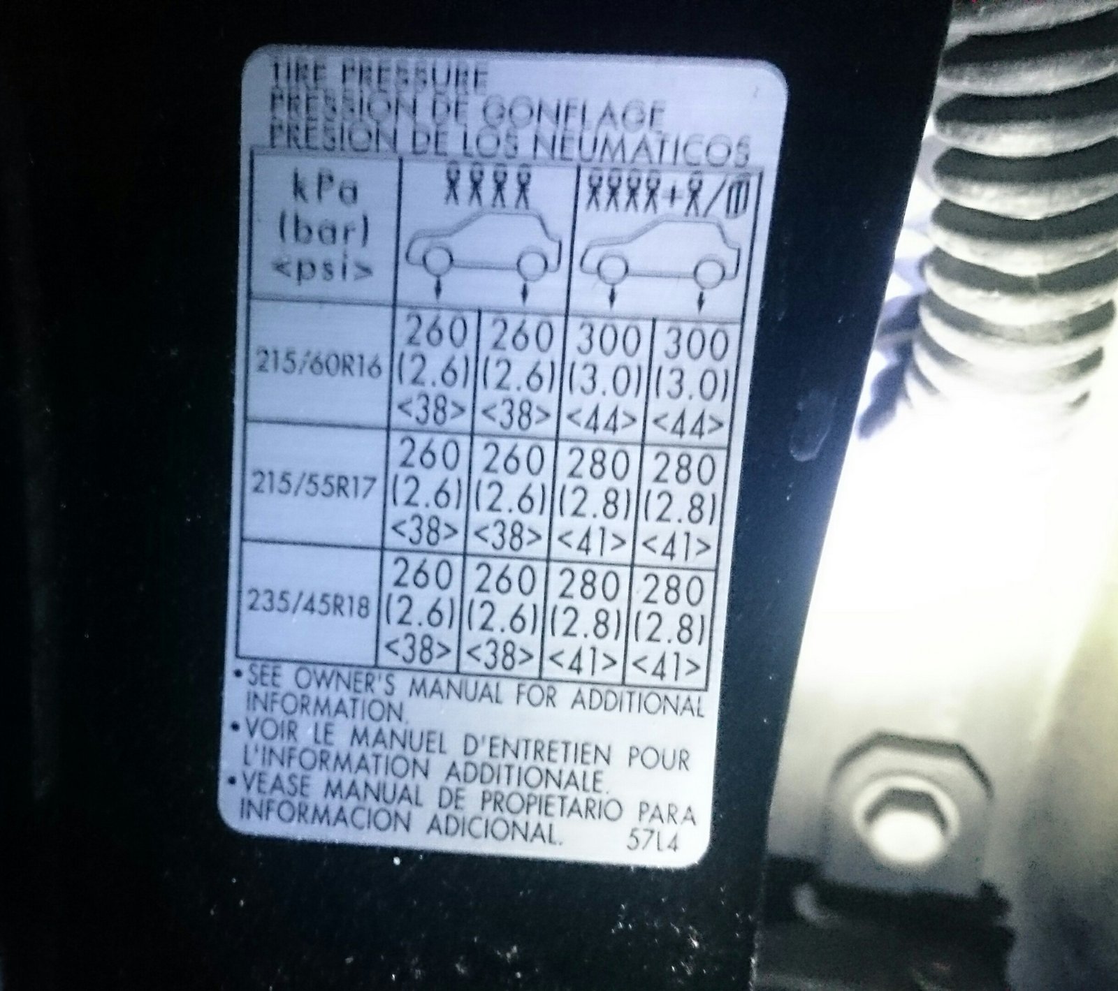

Obviously Suzuki has thought about it too. This tag can be found in my car.
16 inch rims are included here.
Sorry for the blurry picture.
