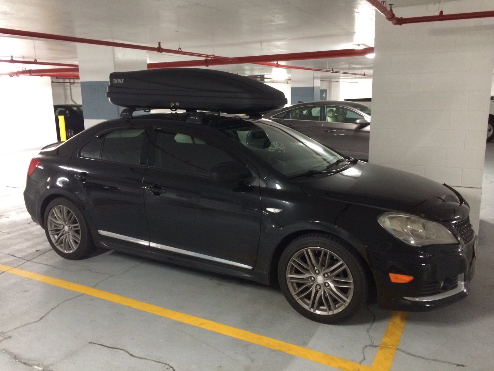

Update:
I purchased the Thule Force Alpine. After considering the selection from Yakima and Thule available from REI, I decided that the Thule Force Alpine fit my needs the best while also having higher ratings than comparable Yakima roof boxes. The main deciding factor was that I wanted to be able to haul my bike module next to the roof box. This meant that width was important. The Force Alpine is about 25 inches wide and 6 feet 9 inches long which is ideal for my case. In terms of gear capacity, at 340 liters, it's rather comparable to wider but shorter roof boxes. I didn't want to get one that's narrower but longer because these can cause rear hatch clearance issues in future vehicles I may own.
The main issue to consider now is the weight load. The Kizashi is rated to have a maximum roof load weight of 110 lbs. Considering that the cross bars themselves seem to weigh 10 lbs together, a working load of 100 lbs. The Thule Force Alpine itself is 36 lbs. The Mont Blanc bike module is about 7 lbs. If I carry my bike (35 lbs), I won't be able to carry much in the roof box. Hence, I'll be hauling my bike for my move in a separate vehicle (I'm making two trips due to various logistical and scheduling issues). This will then free up considerable weight I can carry in the roof box. While it may seem like I should have purchased a wider box due to these weight issues that rule out simultaneously carrying a bike, in uses other than moving, I think the roof box will have a lighter load and I'll be carrying my bike on the roof alongside it. Items like tents, sleeping bags, and sleeping pads can be bulky, but are generally lightweight.
As for the roof box itself, the build quality is quite good and it's not very noisy at speed. I've had it on for about a week empty. Only at speeds above 65 MPH is there wind noise that's noticeable beyond the norm. Even then, it's not disruptive. As for fuel economy, I haven't been able to measure a difference yet, especially given my commutes are often in heavy traffic. Despite the heavy rains, there have been no water leaks inside in the times I've checked. The cross bar latch mechanism is very easy to use and consists of circular knobs you rotate to tighten or release the latches from around the cross bars. They work very well with the Kizashi's accessory cross bars which are Suzuki-branded Whispbar Flush cross bars.
Lastly, garage clearance is good. My work parking garage is a low clearance garage with many overhead signs, pipes, and tubing. The Kizashi with the Force Alpine clears everything so max height is under 6 feet 8 inches.
