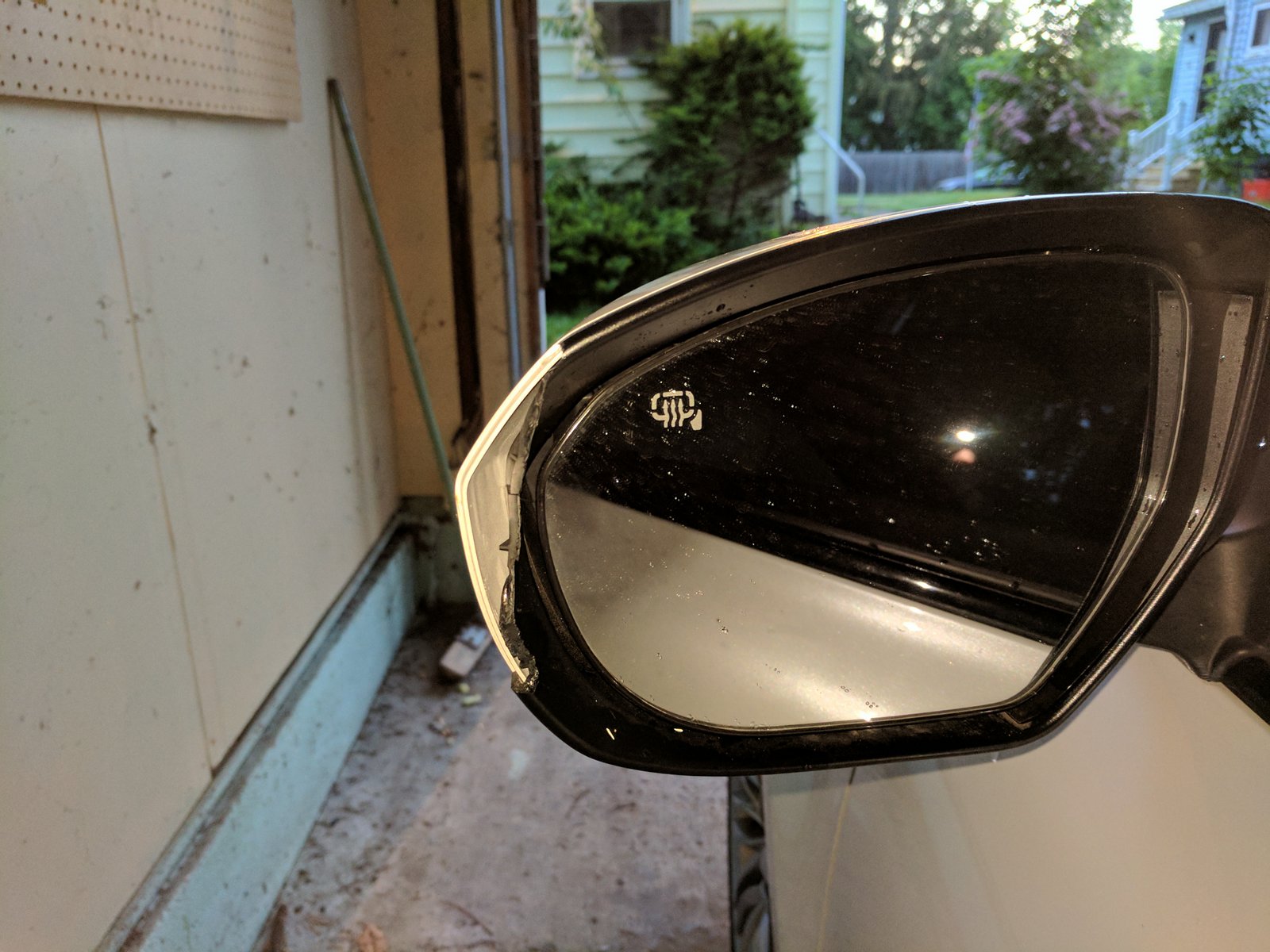

Hello all, does anyone know if it's possible to remove the black interior of the mirror my garage side wall decided to take a bite into my mirror and was curious if would need to replace with a whole new mirror or what, it isn't to bad but I'm thinking there's a reason they had plastic covering this area.
- IMG_20170601_054339.jpg (261.95 KiB) Viewed 4418 times
- Posts: 171
Parts for this car are sometimes hard to find. I would assume you're looking at replacing the whole thing. Or if you're not a huge stickler on aesthetics get some black epoxy to fill the gap in.

A little bondo a small piece of sandpaper and some flat black paint and you can touch that up in less than a hour.
