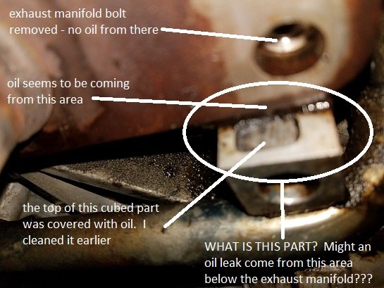

Does anyone know what this cubed shaped part is below? I've developed an oil leak that's obviously been going on for a while unnoticed until I smelt burning oil inside the car when at a stoplight and tiny bit of smoke from under the hood. I've got the car parked in the meantime because to me it's a fire hazard; dripping oil near on the manifold. So the leak is NOT coming from the valve cover gasket. The valve cover is dry and clean. It seems to be above or around this cubed part that sits just below the exhaust manifold. The empty hole in the photo is the bolt I removed from the exhaust manifold, no oil leaking from there. I know there is a recall about cracked engine block, but I don't have any leaking coolant issues. Just trying to get this oil leak resolved. Otherwise, the car idles and runs as good as it did brand new even with the oil leak. So I don't think I have anything major like a head gasket issue.

The cubed part that you’re asking about is just part of the block. There is an oil passage near that which would be going through the head gasket but it’s not a pressure line. I don’t think it’s the head gasket that’s your problem. I think possibly you’re getting oil from the back of the camshaft at the semi circle plug which is integrated with the valve cover gasket.

Interesting. There does happen to be some oil seepage inside the semi circular plug and little around the corner of the VC cover/gasket. But no drip going from there to somehow making its way to the top of the metal cubed place on the block just below the manifold. There is a lot of oil gunk on the side of the cube and bottom of the exhaust manifold flange/gasket. But I don't think oil is actually coming from the exhaust manifold of course. I did try cleaning it all up last week and then driving it to see if I could better locate the oil leak. After driving, I'll see some fresh seepage right on top/side of the metal cube area. I might end up just trying to replace the VC gasket and semi circle plug to see if that takes care of it. I kind of want to drop the exhaust manifold too so I can get a better look since the area is so tight and hidden between that and the metal cube. I used a dental mirror and could see the oil gunk right in between the exhaust manifold flange and the metal cube
......….but at the moment, I'm starting to lean towards an oil leak from the head gasket because all of the oil accumulation gunk is just right below the exhaust manifold and I don't seen any smoking gun higher up on the side at the VC or semi-circle plug where anything would have been streaming downwards or dripping. I cleaned it up a little tonight, drive tomorrow, then get a better look afterwards now that I have a better idea of the areas to be looking at.

So last Saturday, the kiz was admitted for surgery to replace a VC gasket and receive new spark plugs. I performed the surgery in a surgeon-like methodical way. It was a success. Even added Permatex in the areas that the service manual recommends. I went ahead and added a bead of Permatex around the perimeter to help ensure a better seal. The new VC gasket was installed and VC reassembled to the approx. 2lb ft torque. Waited about 36 hours, then re-torqued the VC bolts to about 5lb ft spec. The kiz pulled through surgery and made a full recovery and is running like a champ with no oil leaks. It's at 100K miles, so I even added a bottle fuel injector cleaner with a full tank of gas because the kiz deserved it for being a good little car!!!! Been driving it to work all week...it's back in action on the roads!!
