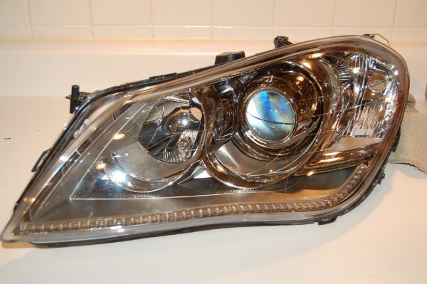

Are you referring to the Orange bulb which is just a parking/running light?
Each headlight housing has 4 bulbs in it.
Ill describe them right to left of this image.
1 : Turn Signal bulb, which is furthest to the out side of the car.
2 : The Regular Headlights/LowBeams
3 : The Daytime Running(Low Voltage) and the High Beams (High Voltage) bulb.
4 : Just below the DTR and High Beam is an amber type bulb which is for Parking/Running lamp
