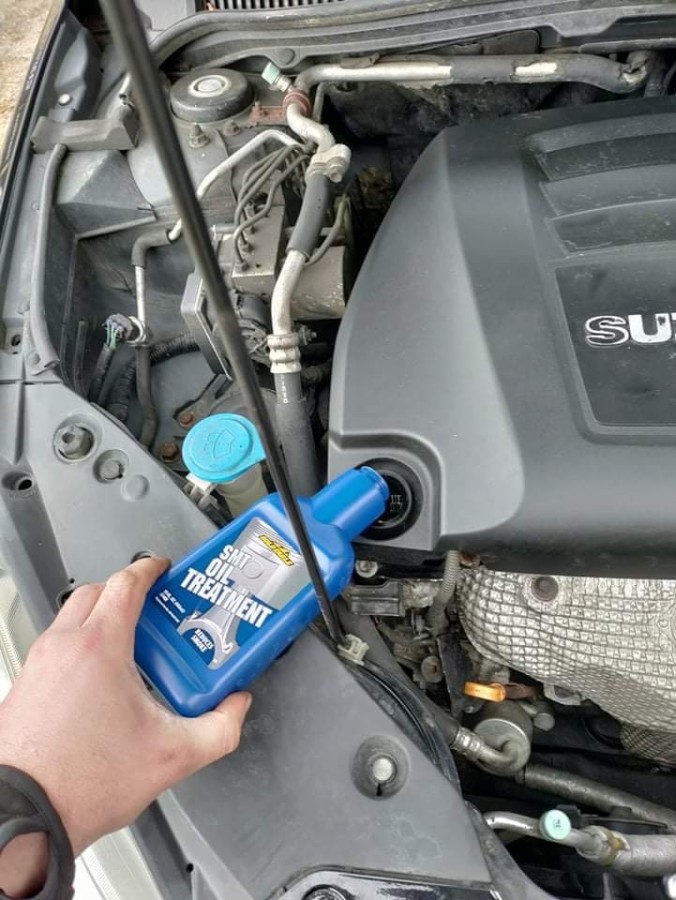

Good point! Yesterday we add this to oil, it might little help, before the next step
