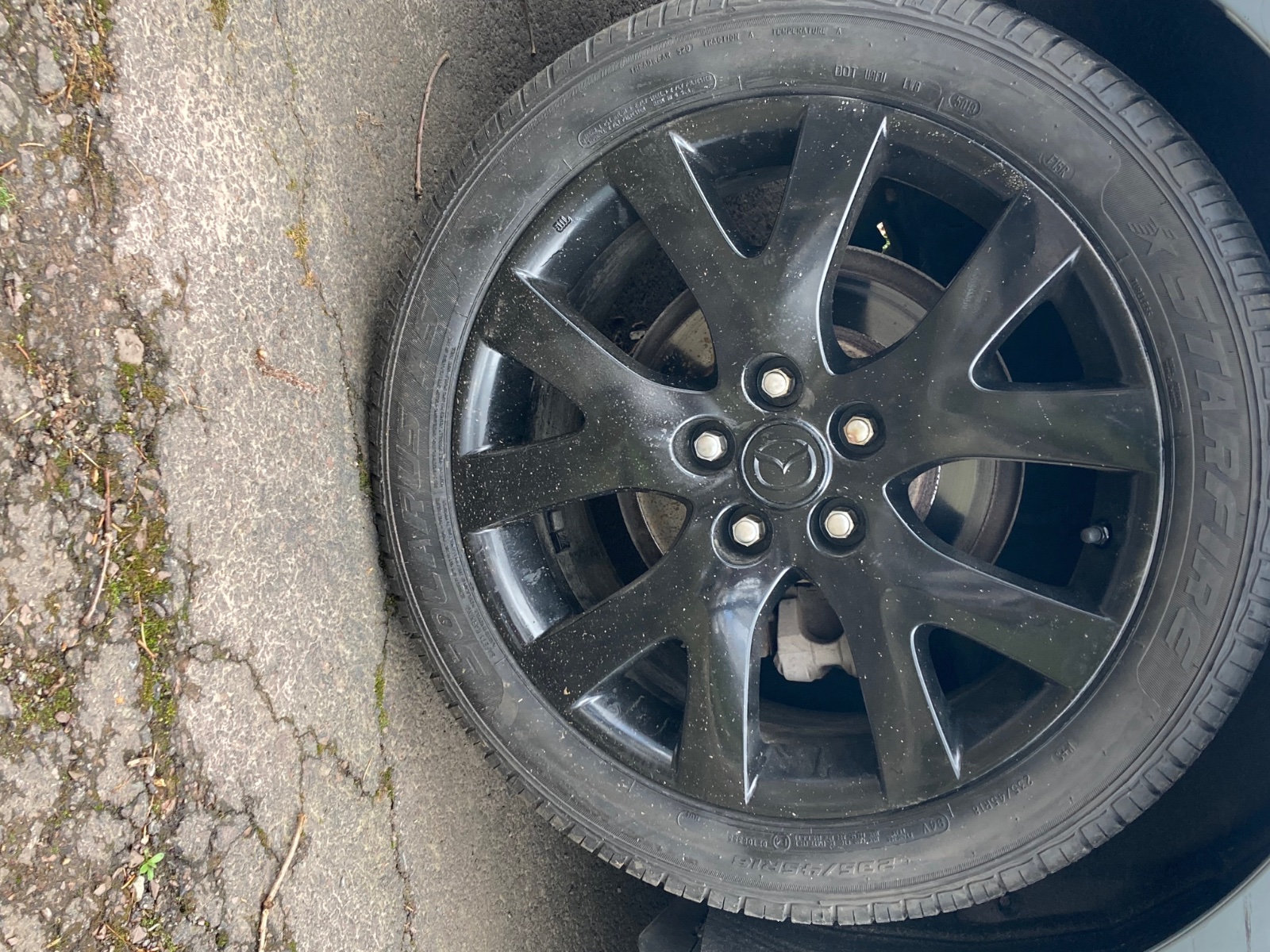

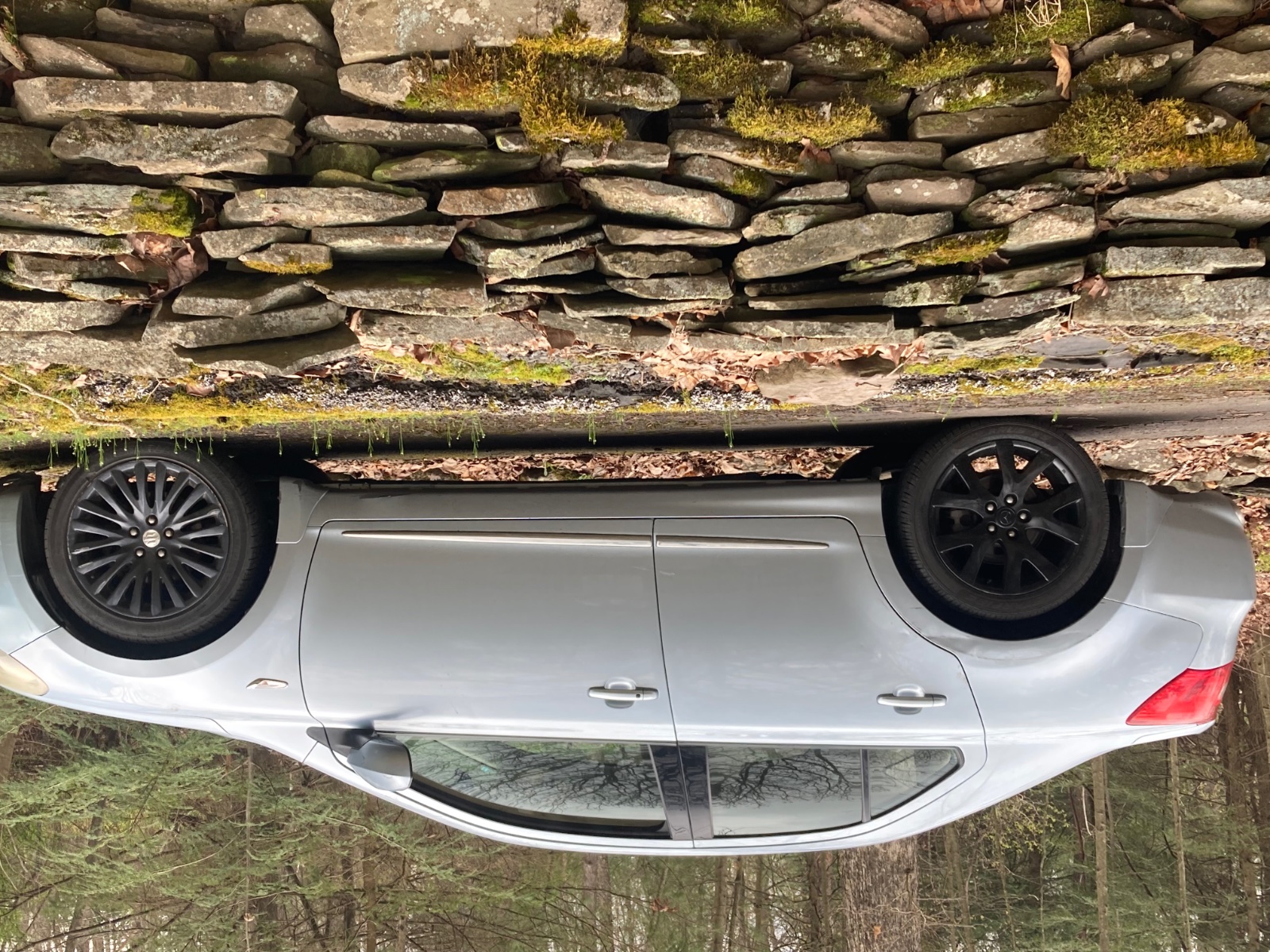

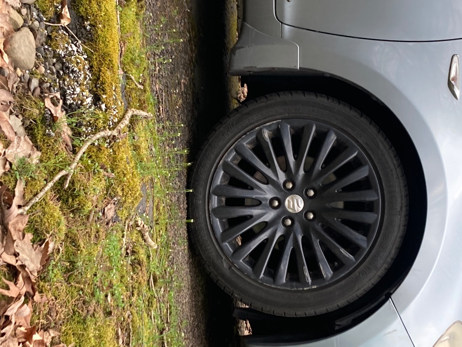

Welcome back and thanks for posting the pictures.
Your old wheels are 100% the original silver wheels that were painted black by the prior owner. This is not surprising as the Kizashi actually has a paint issue with certain colors and all wheels are known to have weak paint that flakes off easily. The prior owner of your car likely just opted to paint the wheels black for this reason or style preference. Either way, this is why you could not find black original wheels for the Kizashi.
As for the mismatched wheels, you gotta do what you gotta do for the interim but make sure that the wheels and the tires are similar in size and wear to the other set if you have AWD. Mismatched wheels and tires of different sizes can cause long term damage on your AWD system. This is not a concern for FWD vehicles as the front and rear axles are not connected.

I will dig up one of my wheels that look the closest to your color. Ill post a pic. If you want it, I can probably have it dropped near you as I have a guy from Stroudsburg coming to get a cvt trans in about a week . $60 for a nice straight original Suzuki 20 spoke wheel
