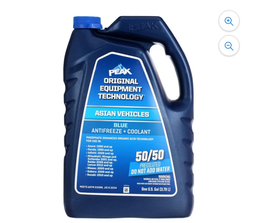

I also bought this coolant for it. Is this okay to use in my model?
Posts: 5277
Yes, that coolant is fine to use in the Kizashi. It's premixed so don't add water.
As for the coolant replacement, you can't just drain and refill like motor oil. There is coolant in the engine too so you need to circulate it to really get the old stuff out and the new coolant in. The process will also flush out contaminants. The original coolant from the factory is specified to last about 90,000 miles and be changed with the blue coolant after every 45,000 miles since, I believe.
