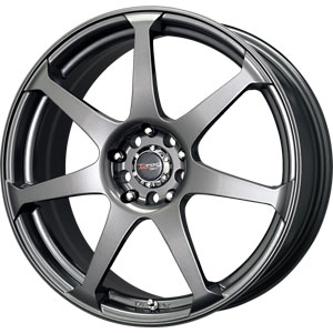

What does everyone think of this. It says to have a +48 offset though.
- drag33 wheel.jpg (22.51 KiB) Viewed 6192 times
Suzuki Kizashi SE AWD
You can imagine it this way: 48 offset will be tucked 6mm further "in" than the factory 18.

If you can't get the same offset of 42mm you'd be better off with a lower offset - even just for the appearance of the vehicle (so a number less than 42mm.) The further the offset is away from the factory 42mm the more likely you are to get the tyres rubbing- depending on how much extra clearance there is on the Kizashi?
What width is that wheel too? You don't really want to go narrower than 8".
