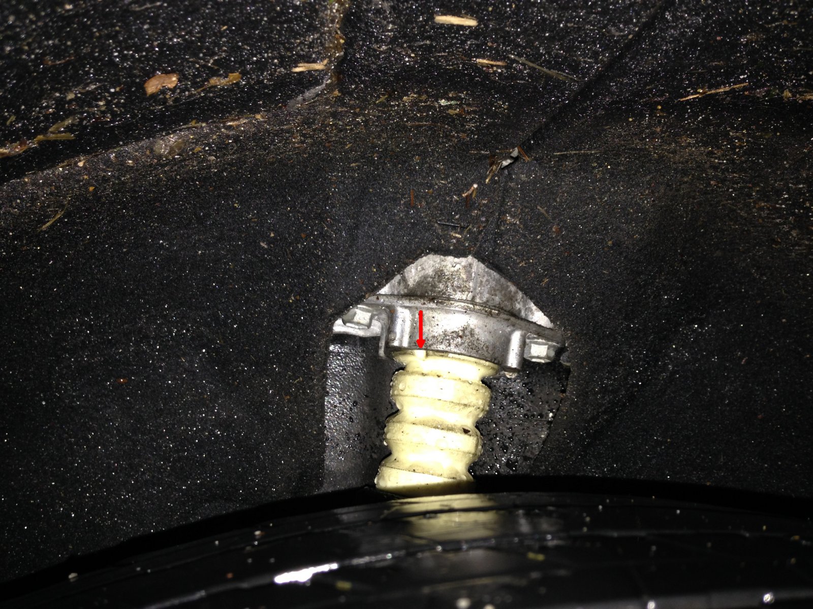

I also checked the service receipt vs. the TSB print-out and made sure all the parts codes matched up as the Sport models have different shocks than the other Kizashis. I also made sure they used the revised bump stopper and not the original design to prevent the issue from reoccurring. Everything looked good on paper.
I noticed that my shift knob was a little greasy, but overall fine. Everything else was fine in the cabin. I then test drove the car around the dealership neighborhood to make sure the issue was resolved. The car was quiet and smooth. The problem was fixed.
I then got out and checked the actually shocks carefully. I could see the new bump stopper and verified that it was the modified designed because the grooves were visible. However, both bump stoppers on either side were covered in grease from the mechanic's hands. While not a problematic issue, it's irritating to see a pro who does not even change gloves when working from old parts to new parts. I even do that to prevent soiling/contaminating new parts.

Here's a photo of my new rear bump stopper. You can see the groove (marked with a red arrow) that is part of the new design to prevent water from collecting and corroding the shock piston rod. Shocks were also replaced as old ones were faulty.
