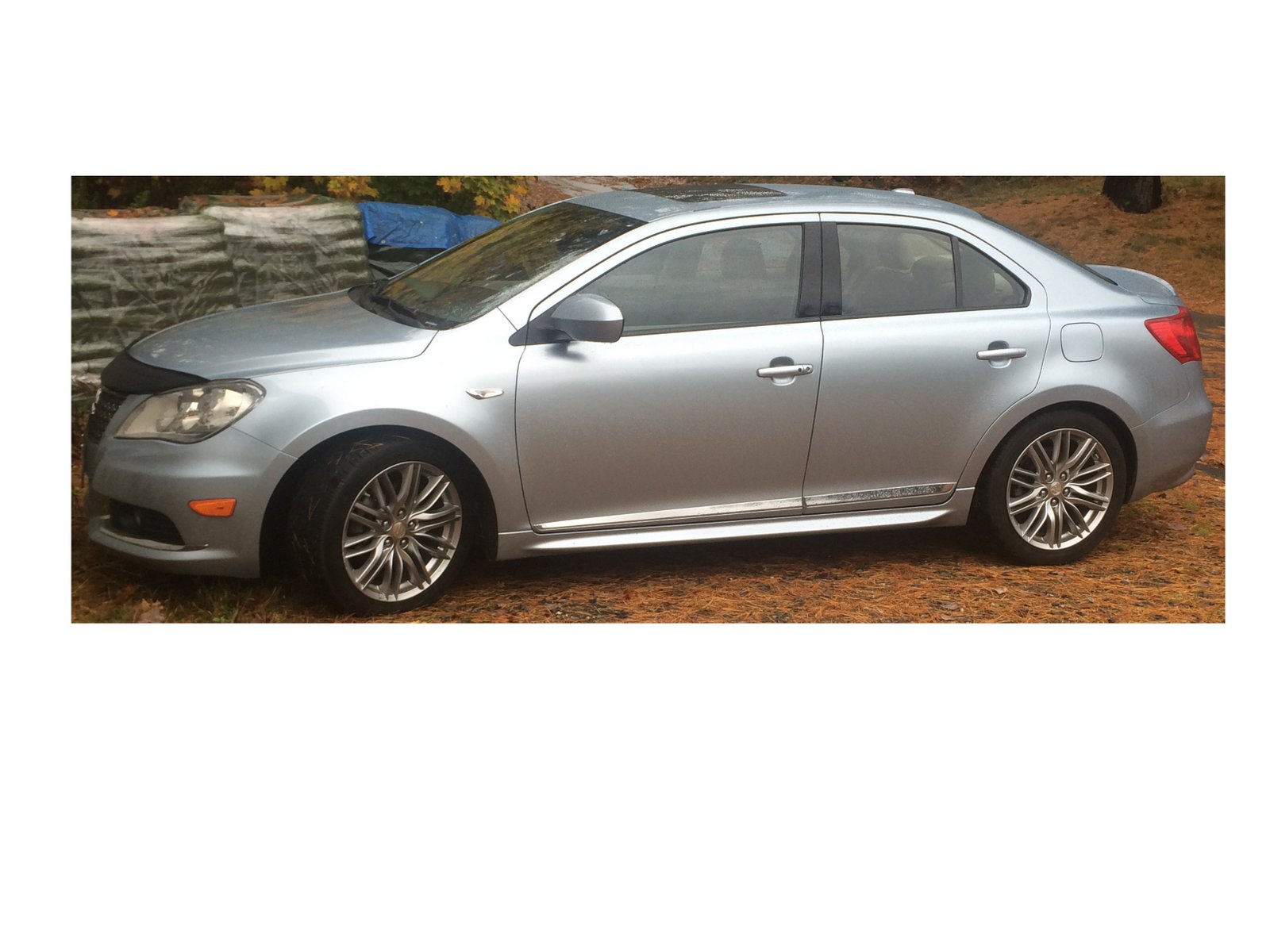

For sale.... anyone interested contact me.
Pictures to come.
