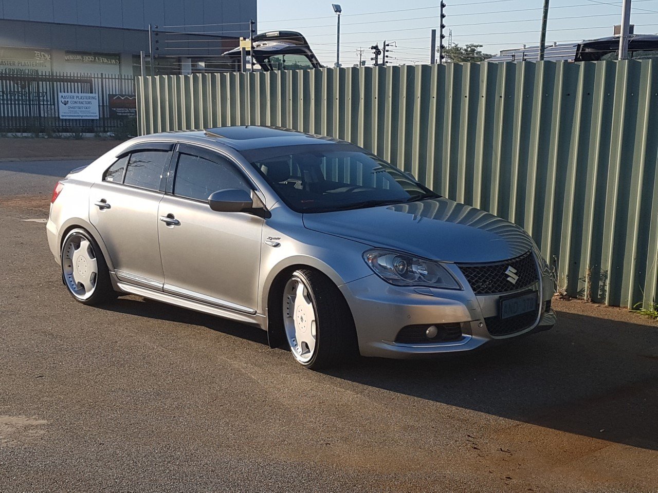

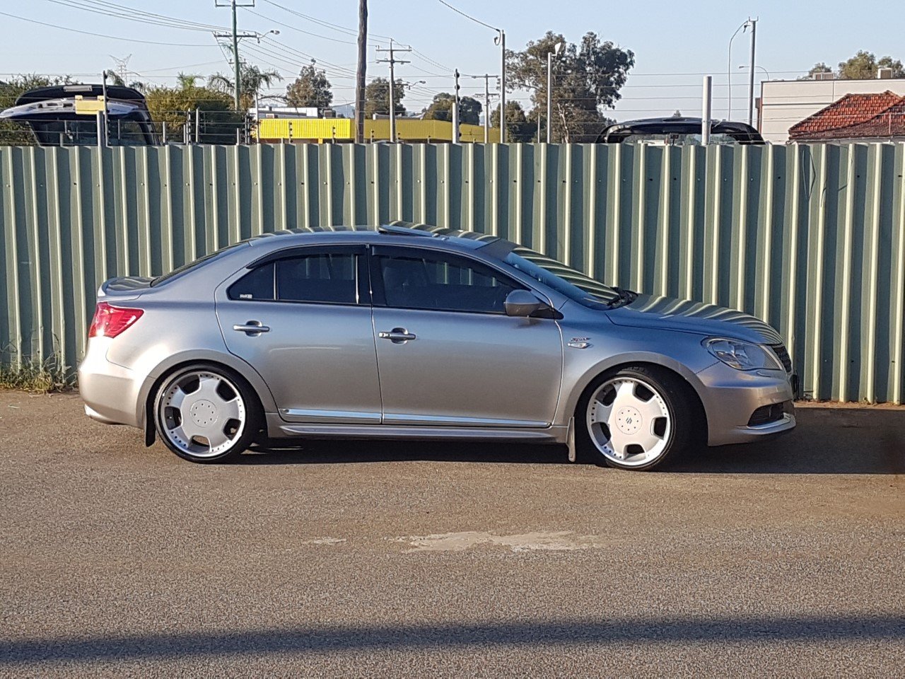

Finally got around to putting my rims on. These are 20x9 with a 35 offset and 245/30 tyres. Overall size is only 14mm shorter than the factory 18s. The car has the H&R lowered springs (1.6" front and rear) and no, the photo isn't reversed, this car is an Aussie :D
Zook 1.jpg (341.75 KiB) Viewed 11387 times
Zook 2.jpg (320.54 KiB) Viewed 11387 times

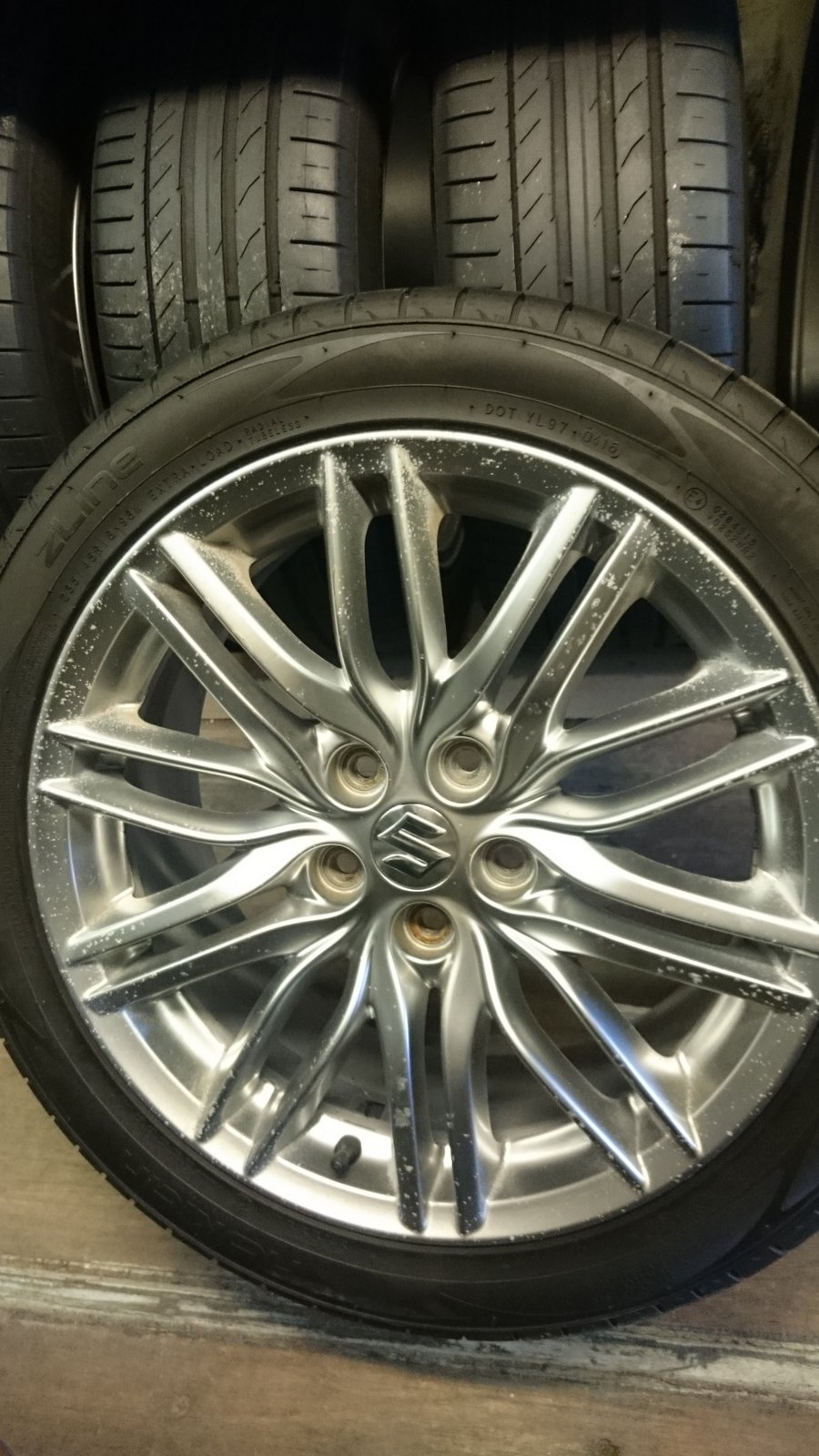

Went by the shop today, to have a look at the damaged paint.
This is what they look like.
Will post a picture when the new paint is on.

Thanks for the pictures, people. Great looking cars!
Gobster, your ride looks slick!
