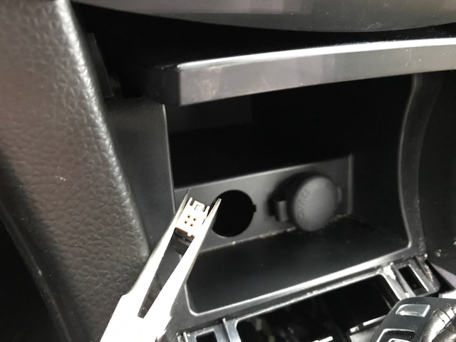

Ok, having difficulty installing the Axxess AX-SUBUSB. Loosened up the old USB connector in the dash panel, and thought I'd be smart by inserting a Lightning USB charger cord in the old connector so I could fish it out if it fell down. Well it fell down all right, but wedged itself impossibly behind a metal part with a hole that doesn't seem large enough to take it. So now that little USB connector is stuck there, and pull as I might on the charger cord I can't get it to budge. I also removed the gear shift fascia and pulled the soft material up over the gearshift, but it did not budge there either. Put everything back and now I've got a lousy looking hole with a useless Lightning cord sticking out. There must be a better way . . . but I'm not seeing it on any threads here. Anyone with experience on this issue - could use your help!

Ok, idiot me. I finally was able to get the lightning cord out and pull the corded usb receptacle up using one of those plumber's claw pickup tools. I pulled the usb corded receptacle out under the space vacated by the shift lever collar. Pulled the plug for the cord out (required a mighty pull) and not only did the cord come out, but the usb receptacle came apart in two pieces. Looked at the back of it I was puzzled to see a female end for the cord on the back of receptacle which looked just like the female end of the AX-SUBUSB adapter. It then finally dawned on me that the AX-SUBUSB adapter should be connected to the other end of a stray Kizashi USB cord hanging around somewhere back of the new Alpine head unit, not anywhere to the usb receptacle, with the male end plugged into the head unit. Going to check all of the wires back of the head unit now.

Ok - the Axxess AX-SUBUSB works very well. You plug one end into the Kizashi's connector back of the head unit, and the other into the head unit. You do not try to connect it in the little storage compartment USB port. Having done so, I now have a USB Apple Lightning charger sticking out of the hole, connected on the one end to the old USB port rolling around in the bottom of the dash and the other is available to connect to the phone. Much better than the the connector being in the glove compartment, but I regret the hole. Even if I pull the USB port up to the hole, I can't make it stick there.

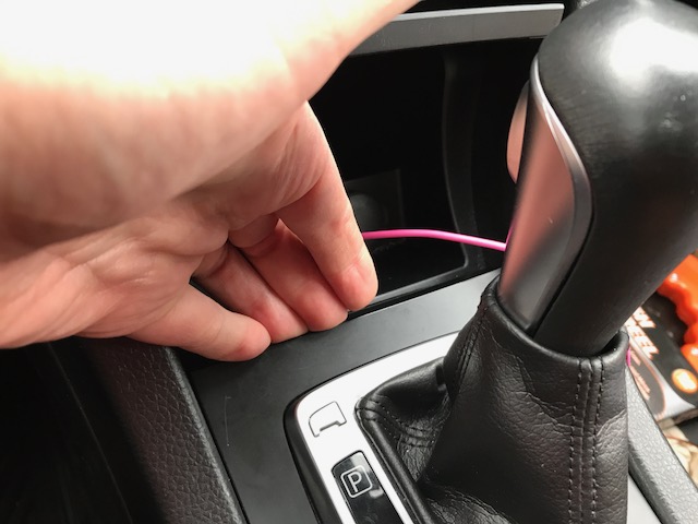

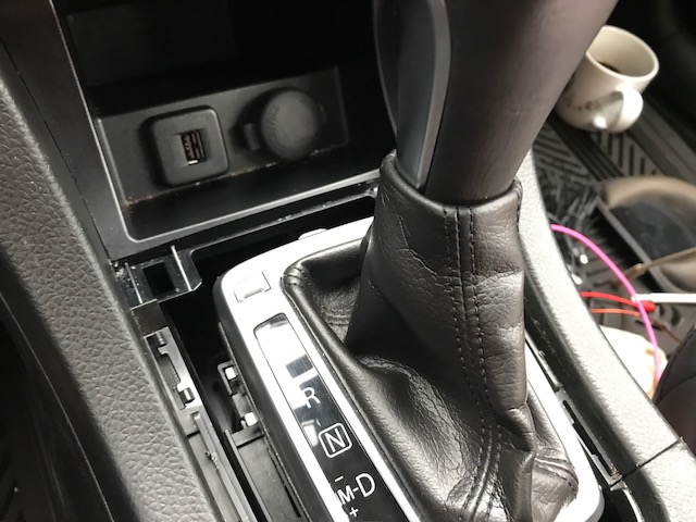

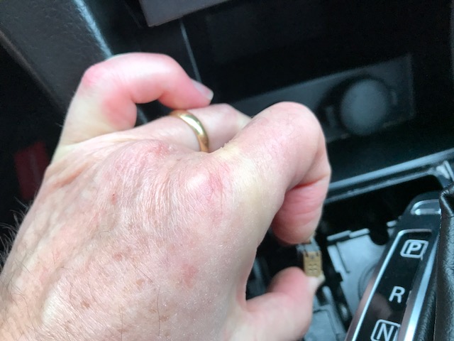

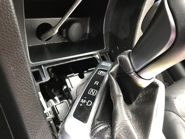

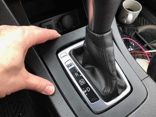

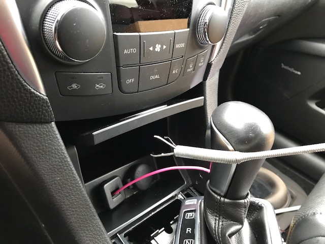

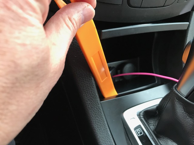

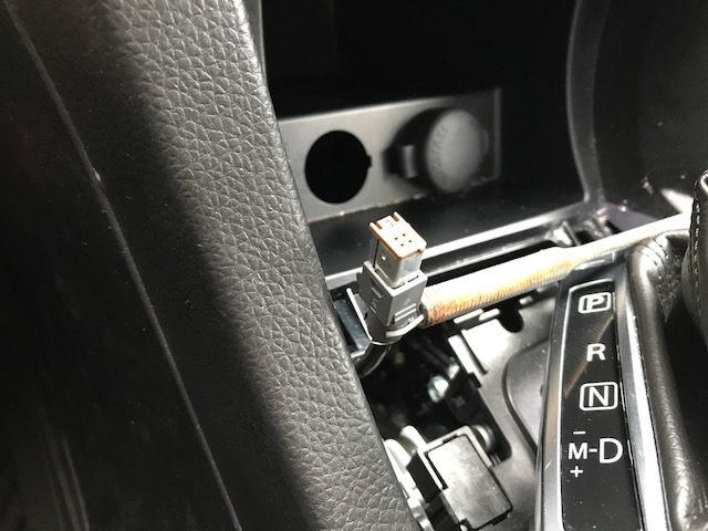

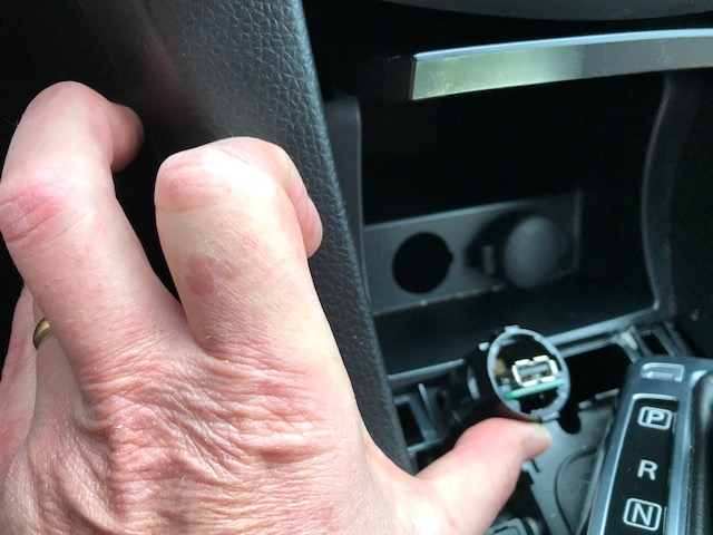

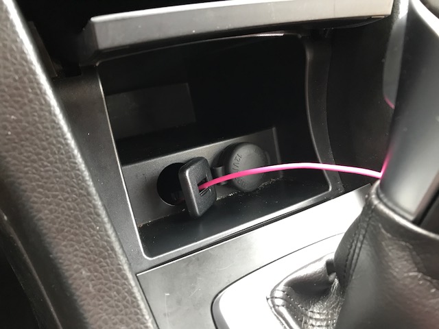

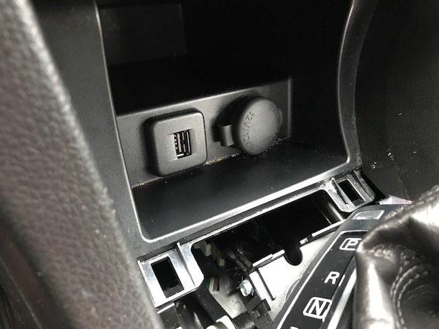

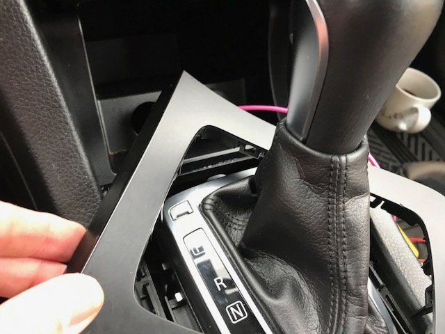

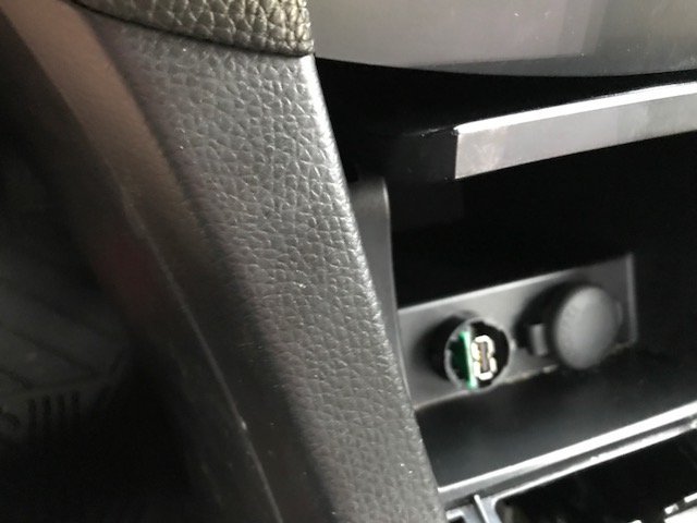

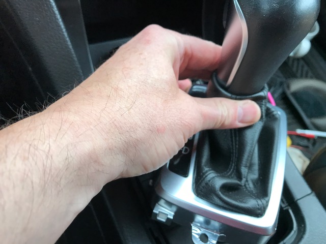

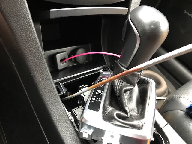

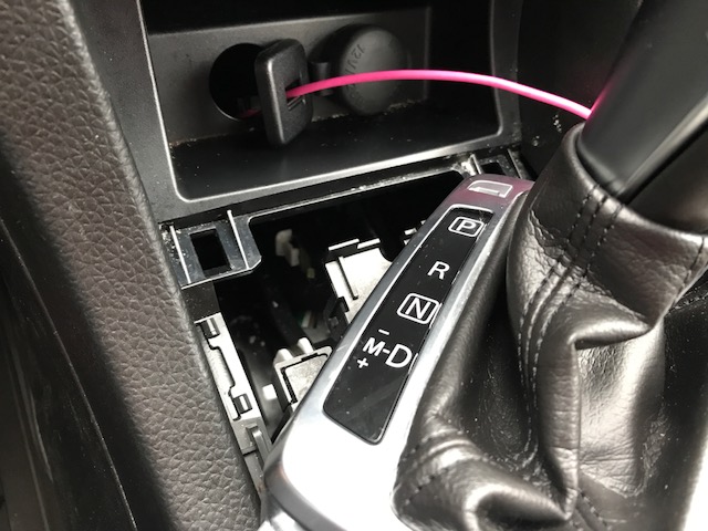

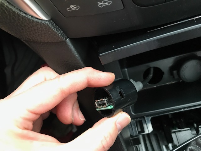

Ok, now I've got the USB port back in its original spot and able to take the Lightning plug as might have been anticipated by Kizashi engineers. Attached are the pics. Basically, what I did is use a plumbers grabber to fish up the downed port in the larger space under the bottom lip of the bin (moving the gearshift fascia to get there), disconnect it from the Kizashi host wire, fish the line back up through the hole using the plumbers grabber and a needle nose pliers, reconnect it, attach the USB garnish, and pop it back in. Reassemble stick. Pics in this and the next posting.

The pics, by the way, are for some reason in reverse order. Start at the bottom.

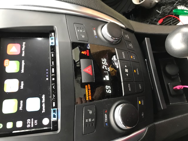

The head unit looks great and certainly gives your Kizashi an updated look and function. I wish the screen was bigger though to fill up more of the space. It's nice that the Scosche trim is designed to match the angles of the Kizashi's interior trim.
- Posts: 405
Thanks, and interesting observation. I had been thinking that with the icons presented by Carplay and experience pressing those same icons on the phone, that the screen was marvelously big enough for its intended purpose.
