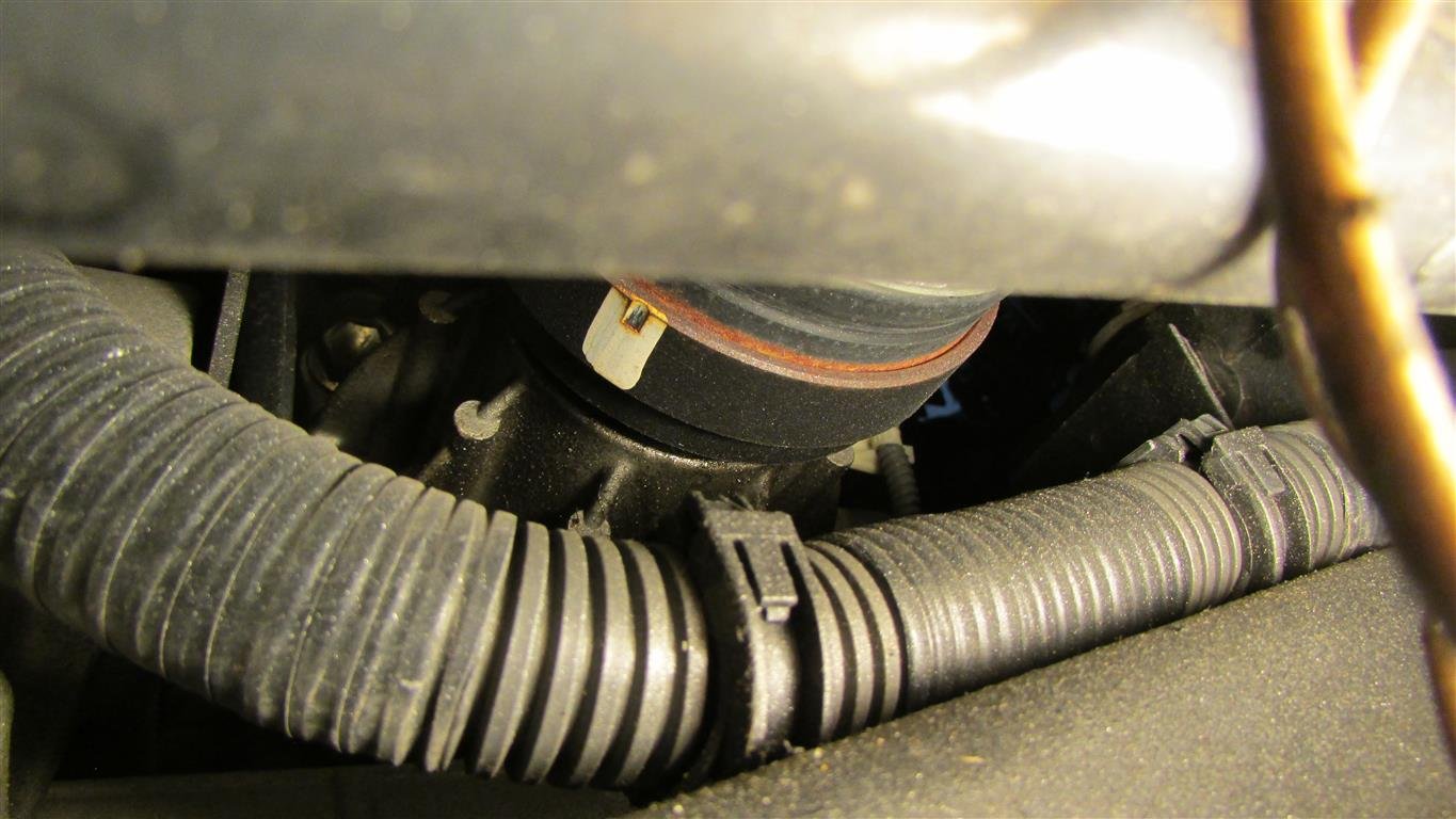

Changed the engine oil and filter, 61,683 miles. While I was under there, I removed the driver's side under cover, which has only ever been off once, and had a good look around with the trouble light. Noticed that there's some oily moisture on the bottom of the transfer case. Followed it up to the source...transfer case output shaft seal has a slight leak :( .
IMG_1320 (Medium).JPG (138.29 KiB) Viewed 8700 times
It's not dripping or anything like that yet, simply moist. It will get worse over time, so I'll need to get that dealt with under warranty between now and next fall, when my powertrain warranty expires at 7 years. Not an easy place to try and replace a seal w/o a lift lying on my back w/ no room to work. As much as I hate to turn it over to the professional monkeys, this one is definitely going in for a warranty replacement. Easier to do battle with their BS than it is for me to try and replace it...I don't contort as easily as I used to :roll:. Hell, I cramped up twisting around under there just trying to get the camera in position to take a couple pics of the source of the leak!
Checked everything else up front that could leak and everything else is dry.
If you've never popped that driver's side undercover off, or haven't lately, I suggest doing so and having a look see at things especially if the cars age is such (2010) that your powertrain warranty will be ending very soon.

Interesting. I had an input shaft seal leak on my MT Kizashi. This happened with less than 30K miles.
