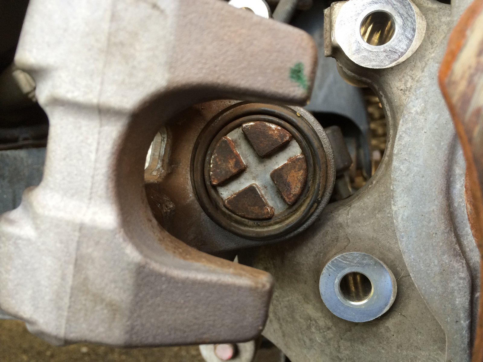

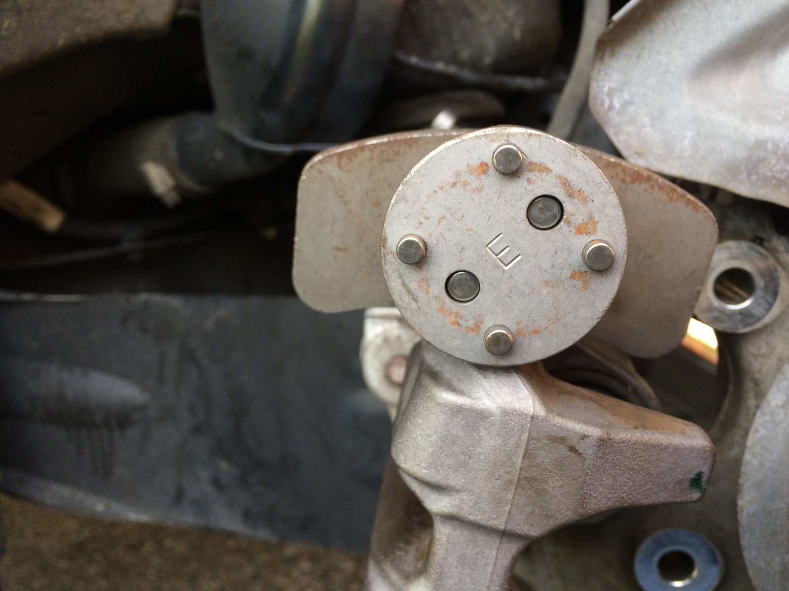

Also, maybe this can help you remember if you changed the rear: The rear caliper piston has a special design that looks like a + symbol. You need an appropriate tool to insert into the caliper piston to rotate it back into the caliper to fit the new rear brake pads. Do you recall this process? The front ones don't have a special pattern and can be compressed with any caliper piston compression tool.
The pictures below are from when I replaced my rear brake pads and rotor. The top image is of the caliper piston with the + design. The bottom image is of the tool I used to compress it.
