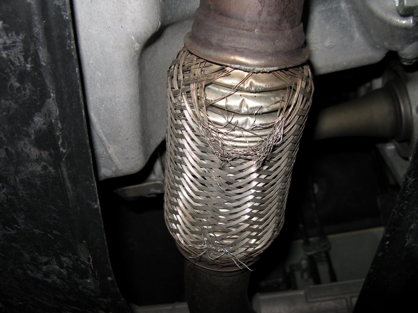

Regarding the flex pipe scrape:
I took a good look at it when I had the car up on ramps for the LED headlight installation.
This was what it looked like.
As you can see, the wire mesh was damaged and a bit of the pipe was too, but no serious damage or punctures to the actual pipe.
I also noticed that some of my plastic undercovers were cracked and a bumper screw was missing. I checked the area where I ran over the parking block but could not find the screw. Thinking back, I did hear an odd noise of what sounded like a small object falling from my car. That was on the freeway. No recovery of that screw. I may look around for a replacement on the internet, but reallocated a less important bumper screw in place of the one that is missing.
Overall, not too much damage no real issues to worry about.
