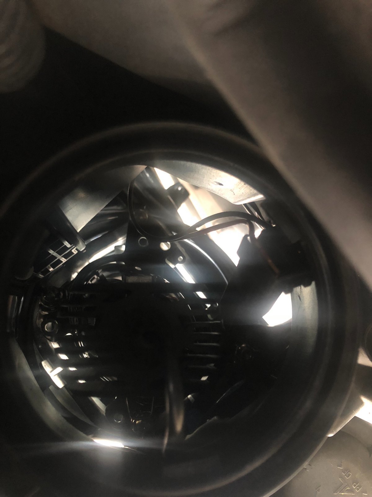

Alright horrible picture but here they are mounted in the car. Weather cap has no issue closing. No wires pinched or anything like that. I do drive into work in the dark but this morning I left late and didn’t have time to take a picture of the lights on. I’ll try to wake up earlier tomorrow.
They appear a tad brighter but I haven’t figured out if that’s true or if it’s just me not being used to the light being white. Instead of the yellowish White the halogens produced.
2010 Kizashi GTS FWD
DiggerDerrik wrote:Alright horrible picture but here they are mounted in the car. Weather cap has no issue closing. No wires pinched or anything like that. I do drive into work in the dark but this morning I left late and didn’t have time to take a picture of the lights on. I’ll try to wake up earlier tomorrow.
Thanks for the photo. There looks to be a lot of clearance. Also to confirm, these don't have external drivers, do they? In essence, it's just the harness that comes out of the heat sink that plugs into the headlight's OE socket, correct? Everything is contained within the headlight cap?
DiggerDerrik
Posts: 171
Correct. It’s all one unit that fits inside the headlight assembly. You don’t have to drill or run wires outside of the assembly.

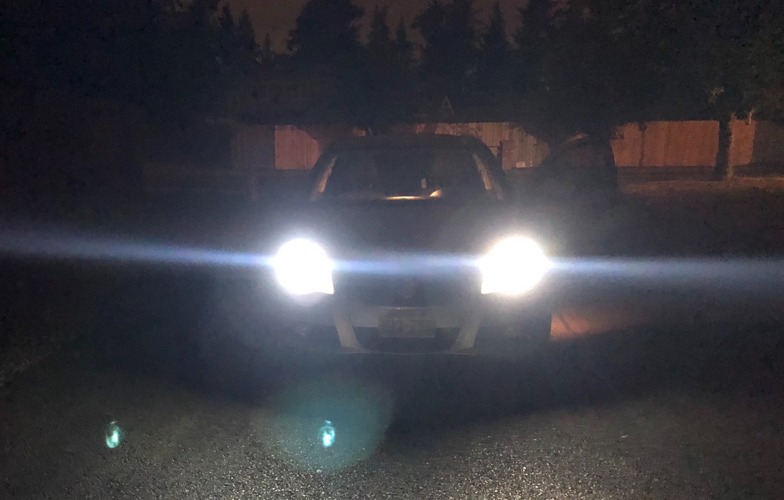

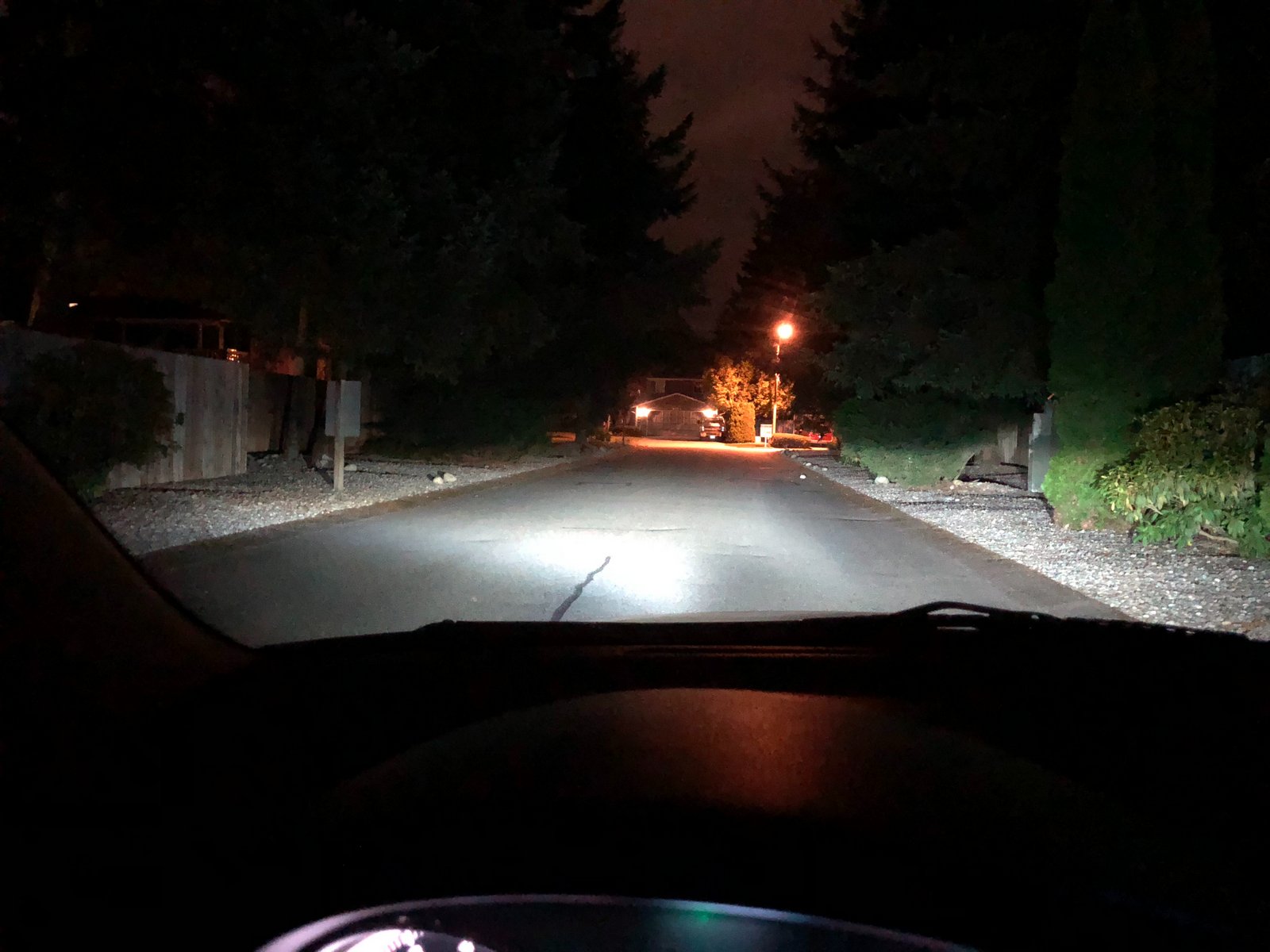

Stopped and took a couple photos this morning. The lights aren’t aligned very well. I’ve replaced the bulbs probably 10 times and over the years I’ve put less and less bolts back in to make the process faster. So the that’s the reason they don’t shine perfectly straight anymore.
