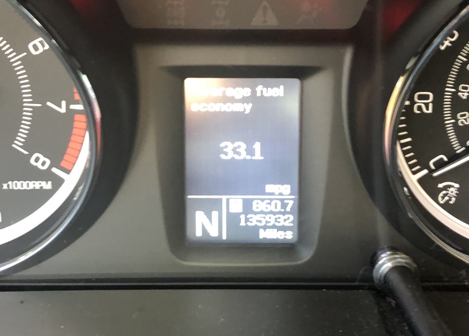

Left the house at 3am. Drove the Kizashi 860.7 miles from Puyallup Washington to Klamath Falls Oregon and back, to pick up our new puppy. Got home at 4:45pm. Car did great. Lie-o-meter on the dash said 33.1mpg. Car used 27.87 gallons so that actually comes out to 30.88mpg. Not bad. The dash also said I averaged 63mph. Which is believable.
This was the first time I’d ever really driven with the new headlights in total darkness. While I normally drive to work in the dark it’s on city streets and interstates with street lights and the headlights of other drivers. These LED’s are brighter then the Phillips Halogens I normally used. However they do not project the light out any farther then the halogens. So their ability to improve visibility at night is limited.
