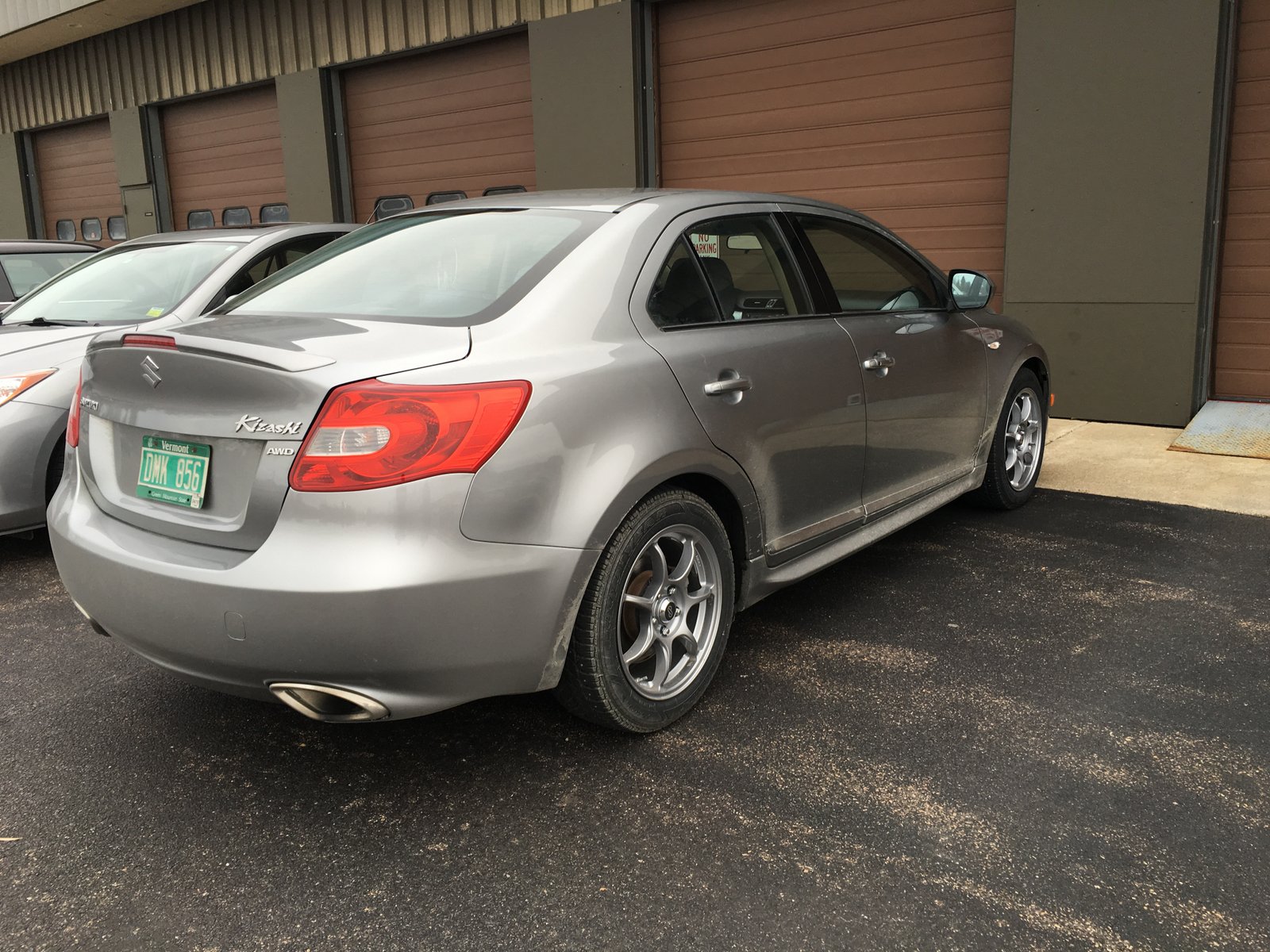

I did the TPMS hack posted here with my newly-mounted Enkei Tuning Fujin wheels with TireRack-supplied installed TPMS sensors.
It was simple and easy.
My dealer would charge me $80.
I used the TPMS hack here are steps to put the car in relearn per SAMIR D:
" Have the fob in your pocket
- Open the car and sit in the drivers seat. Close the door. Make sure all doors are closed.
- Push the start button twice to get it to acc mode. Keep your foot off the brake or you'll start the car.
- Within 5 seconds of seeing ACC on the dash, open the driver's side door and reach to your left to find the driver's side door plunger switch. Press it and hold for 2 seonds. I've found using the dome light as a good indicator as to when the switch was depressed. My light did not extinguish.
- Release after pressing for 2 seconds, and then do it again for 2 seconds.
- Release after pressing for 2 seconds, and then do it again for 4 seconds.
- When you release it this time, you'll see the tpms light start to flash slowly (about once a second). If not, start at the begining after turning the car off".
once it is in relearn mode start with drop the air to 5-10 lbs each tire, until all tire registered then add more air. please confirm.
To add:
-When I opened the door to push the switch I left it open to drop the air pressure
-I left the IGN in 'on'
-I used a lollipop stick to drop air; I counted to 25 at each corner
No more flashing blinding lights.
So thank you to those more able to figure this stuff out.
