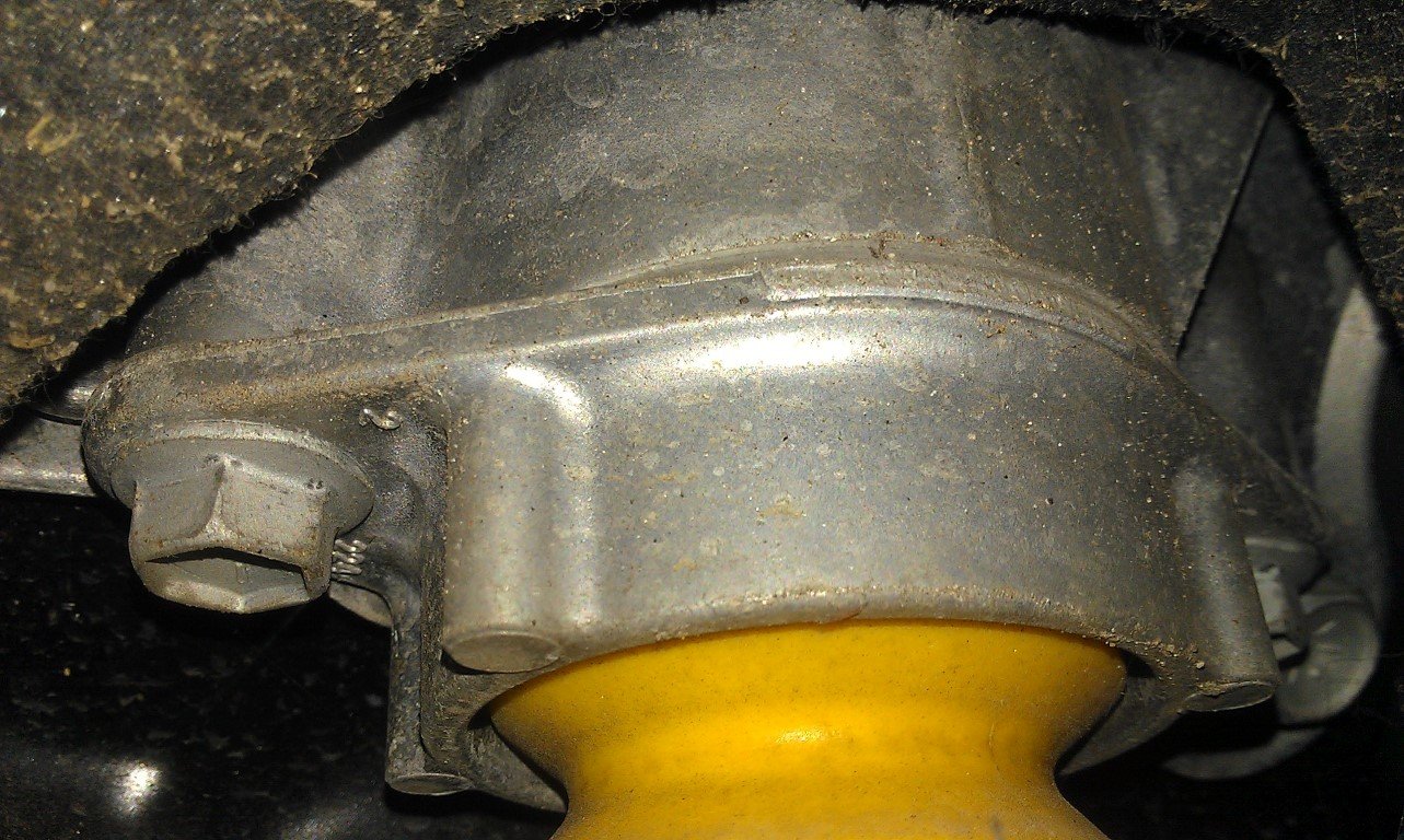

KuroNekko wrote:Here's a photo of my new rear bump stopper. You can see the groove (marked with a red arrow) that is part of the new design to prevent water from collecting and corroding the shock piston rod. Shocks were also replaced as old ones were faulty.
For technical clarification. What is the bump stopper? The yellow housing? And the "shocker" is inside? Sorry for thr ignorance.
After I had mine replaced, I noticed the yellow housing is in different colors, previously dark yellow and now a very light yellow. Is that the same for eveyone else?
It's the part that sits on top of the shock's piston rod. It's the yellow/light yellow part you are talking about. In the photo, I marked a groove in the new bump stopper which is the countermeasure to the water retention problem that was causing the shocks to corrode and fail. The diameter inside the bump stopper was also modified so water evacuates.

thanks for the clarification. Guess I have to look for the groove later. I wouldn't be surprised if they just replaced it with a previously stocked / precorrection stopper, as the dealership here really does not care about their work.

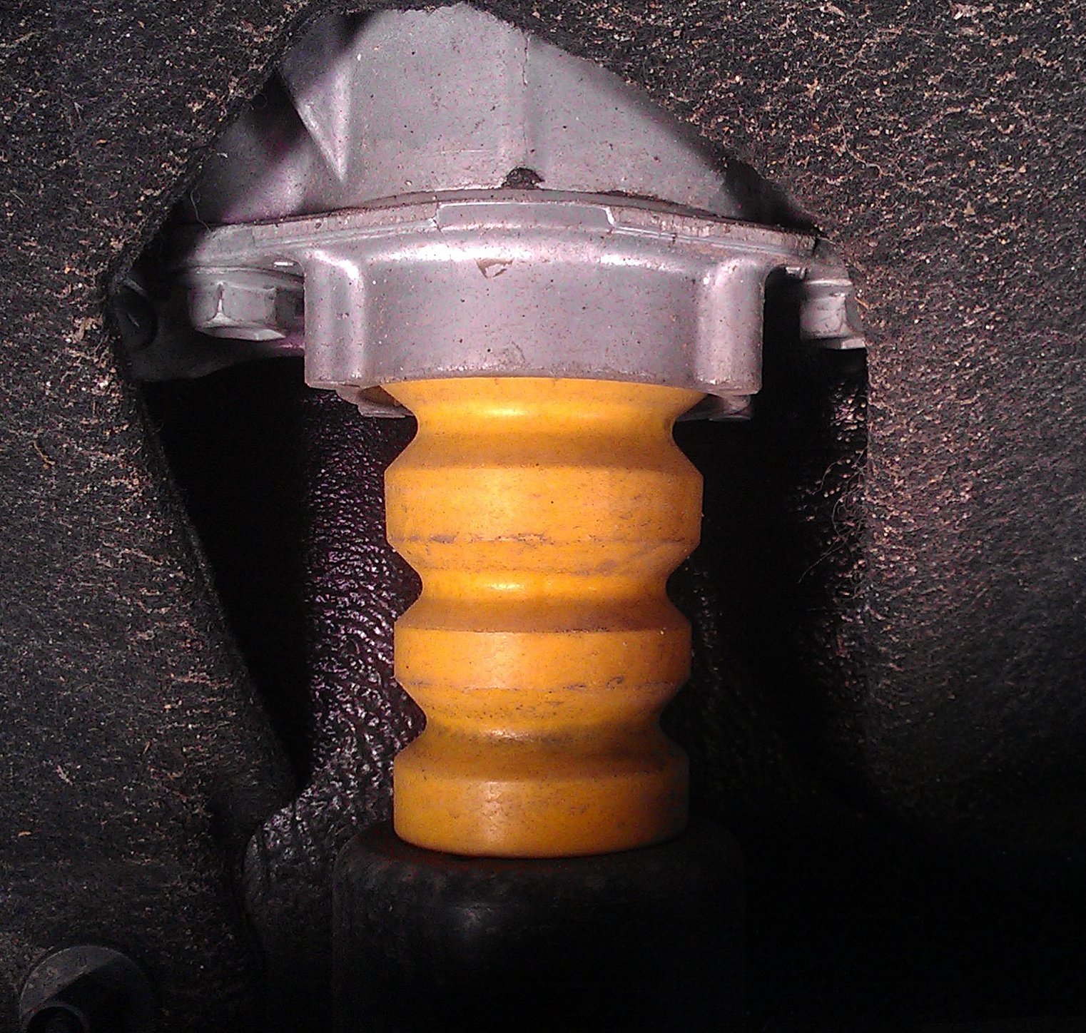

Here's an MY11 Australian delivered Kizashi LHS and RHS rear bump stops.
MY11 RHS rear bump stop.jpg (500.59 KiB) Viewed 5794 times
MY11 LHS rear bump stop.jpg (268.52 KiB) Viewed 5794 times
Clearly no drain hole compared to KuroNekko's pic
http://www.kizashiclub.com/forum/downlo ... hp?id=1739
Yet again, no local TSB appears to be issued. You guys get better support in the USA - even with Suzuki pulling out. :roll:
