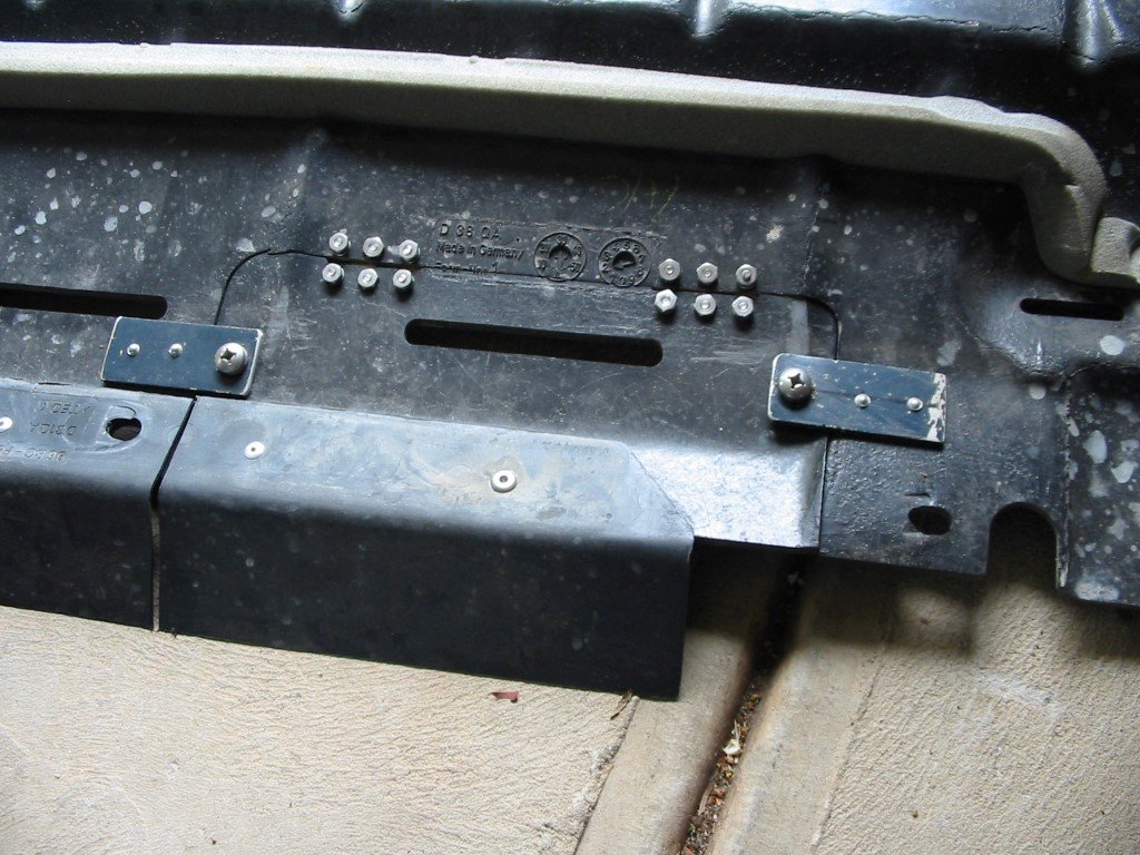

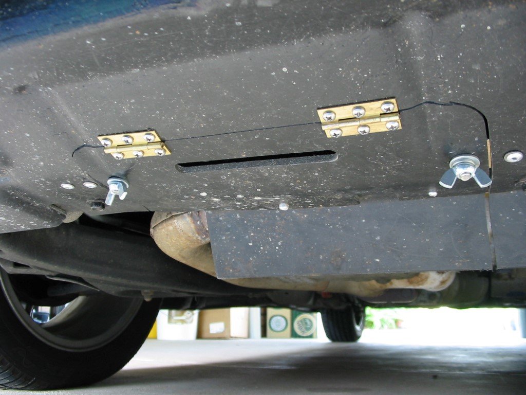

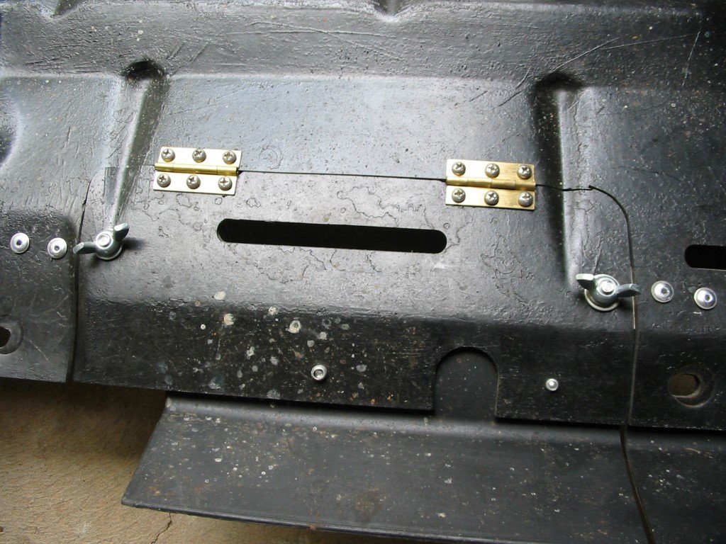

On a different vehicle I cut a small access hole in the undertray where the sump plug was located. I then put a small hinge on the section I'd removed and made a latch (small bolt with a wing nut) to hold it shut. That worked well.
That's quite clever! It wouldn't be so bad if the under panel wasn't held on by 100 bolts

Do you have picture of that access hole?
17 Sienna
Ironically, I just managed to locate some pics. (That vehicle was sold a long time ago....)
You could do something very similar with the Kizashi.

Thanks Murcod! That trapdoor is extremely well constructed. Much better than I had imagined.
