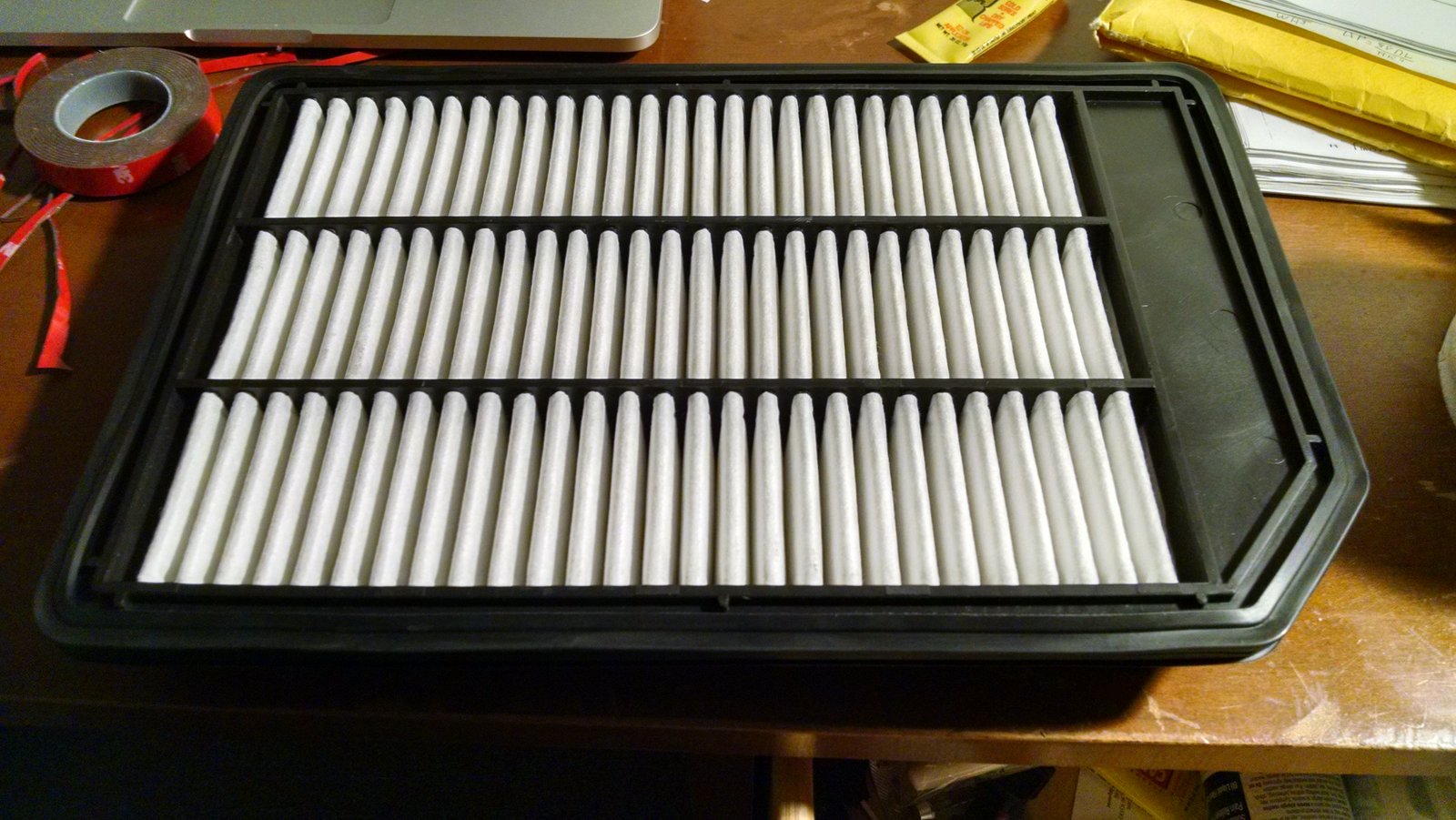

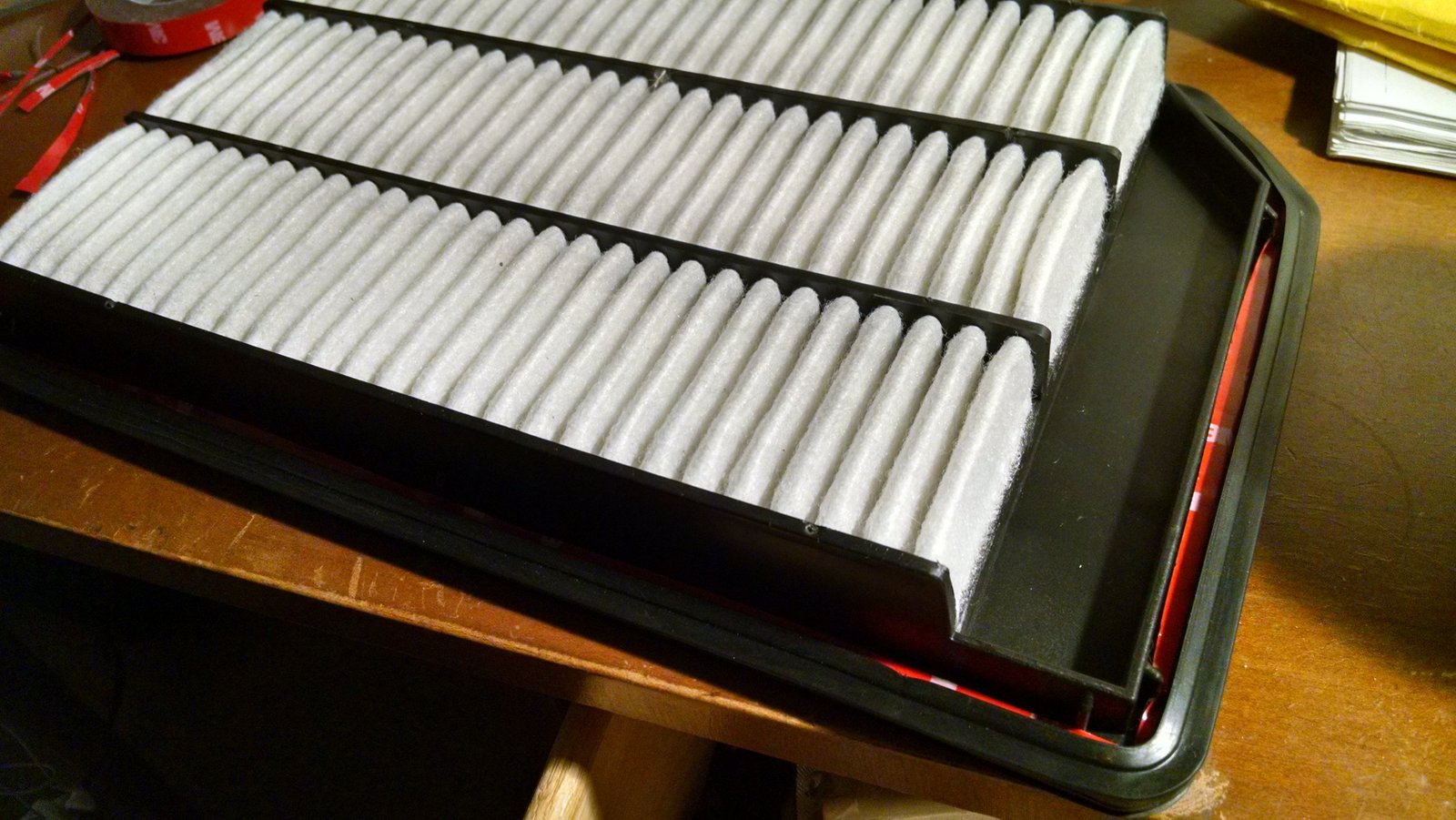

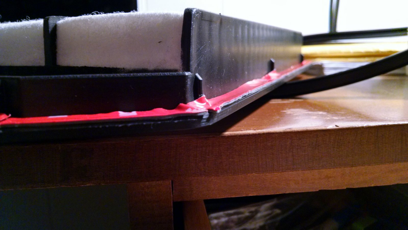

This was definitely what was causing my problem. I just applied a strip of 3m tape on the bottom side of the flange under the gasket and put the gasket over it and the vibration and noise is completely gone. The filter went back into the airbox nice and snug but it closed very nicely without any extra effort.
I work in automotive manufacturing and this dimensional mismatch is unacceptable. On a feature like this flange, the tolerance for the thickness should be a few hundredths of a millimeter. I have driven about 3000 miles on this filter, I hope unfiltered air hasn't been leaking through the gap.
This is the filter I have
