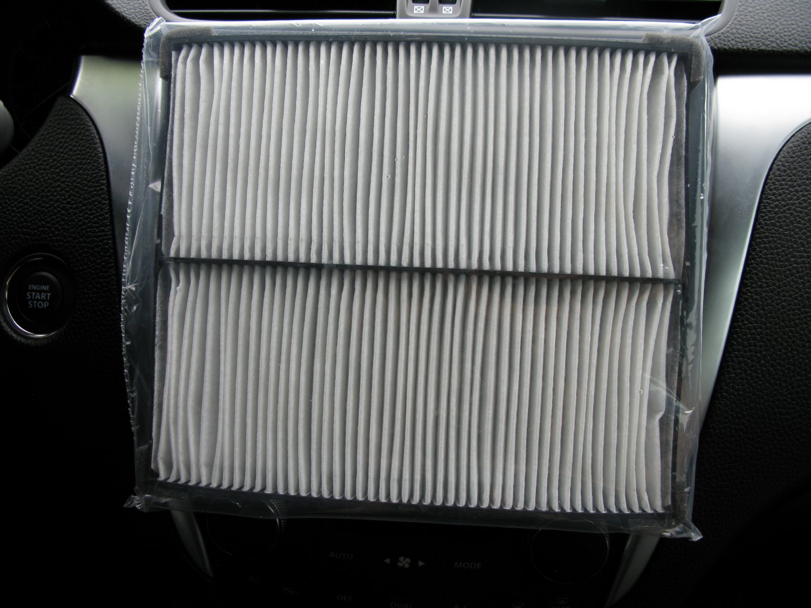

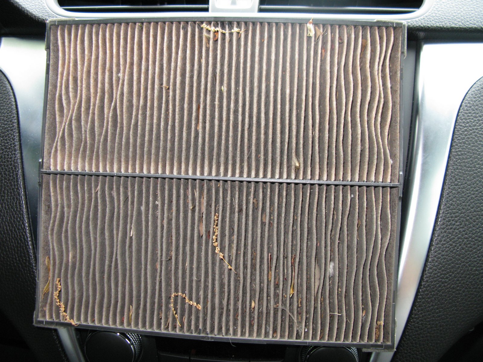

I wanted to wash the car, change the oil, and ground the capacitors for my DRL LEDs this weekend, but I'm rained out. I hate not having a garage. However, I was able to do one thing: change the cabin air filter.
I've been looking for a replacement filter in a store but could not find one anywhere. I checked Autozone, Advance Auto, Pep Boys, and Walmart. None had filters for the Kizashi. I then opted to get them online and found one for a good deal on rockauto. Looks like a generic brand but it's a perfect match. At only $10 ($15 including shipping fee) I can't complain.
My car only has 26,000 miles on it but the cabin air filter was pretty nasty. Given the pollen of spring and the arrival of hotter weather soon that will demand A/C use, I wanted to change the filter.

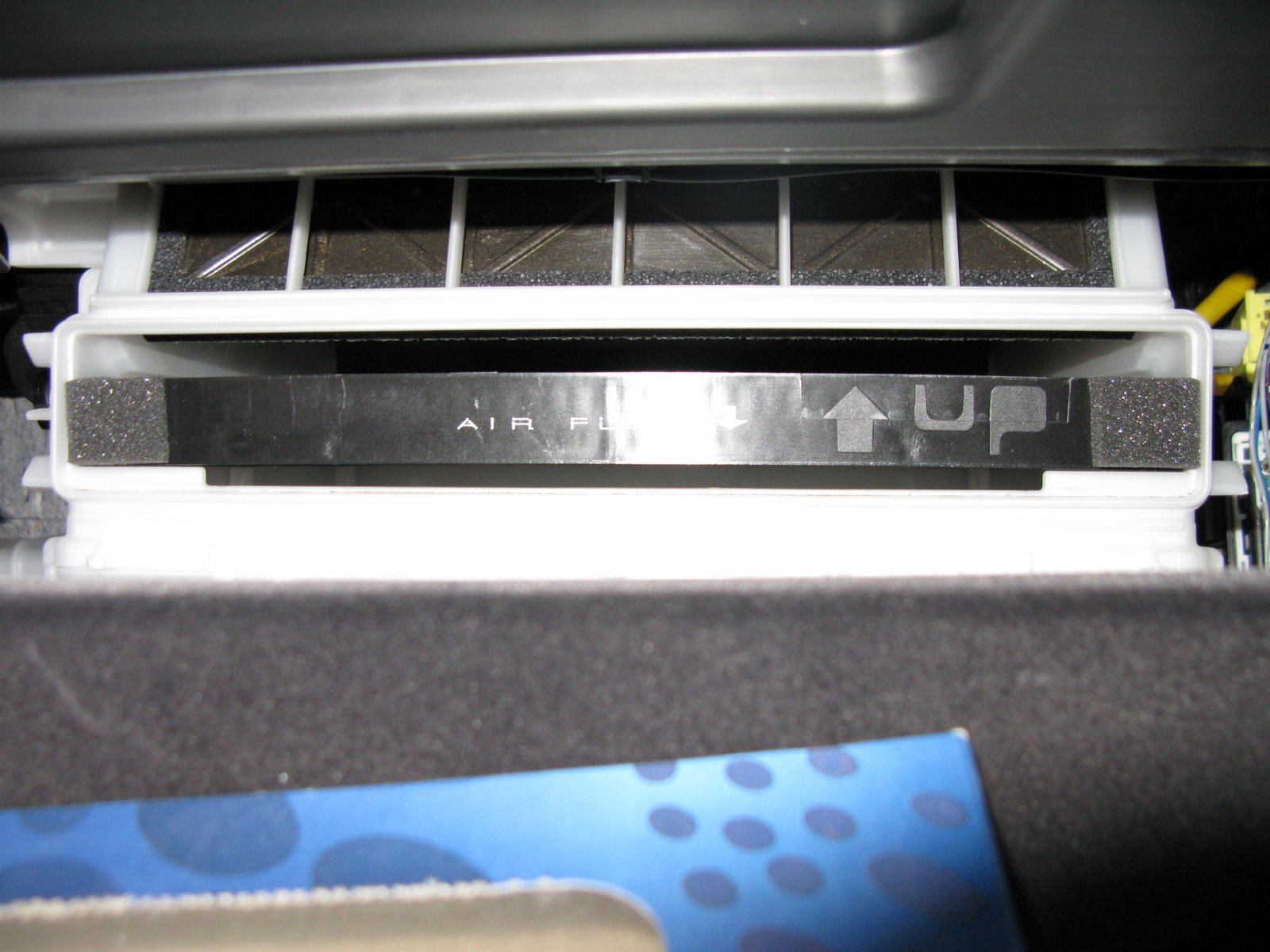

I also want to note that changing the cabin air filter is very simple in this car and requires no tools. In fact, you don't even need to drop down the glove box from its hinge if your hands aren't huge. Just remove the owner's manual tray and you will see the white plastic cover for the filter. I could easily reach the clips on either side and remove the cover. The filter is then accessible. It took me about 5 minutes to change the filter.
Here is a more detailed discussion on the cabin air filter in case someone is interested: http://www.kizashiclub.com/forum/viewto ... =32&t=1556
Old Filter:
New Filter:
Note that the filter has indicators for proper orientation:
