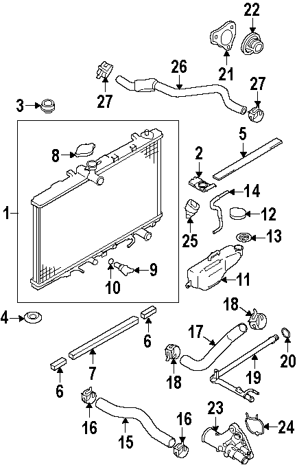

Open the hood on my SLS saw something that didn't look too good .. saw greenish gray spots on the cooling fan frame right below the overflow coolant bottle also green stain on the overflow coolant bottle should i take the car back to the dealer let them check it out?

Took car to dealer today to check the coolant leak they found a gasket was missing from the overflow cover #13 and get this the dealer wanted to charge me $2 for the gasket
