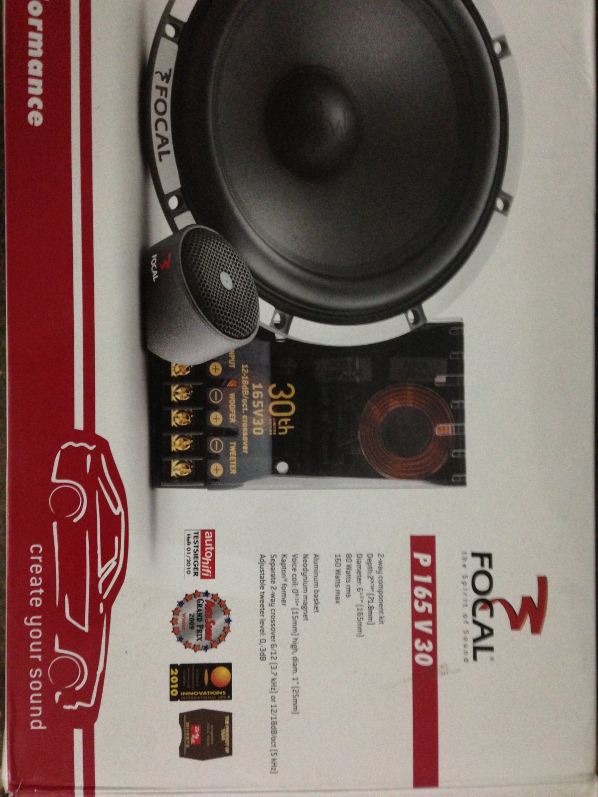

Installing Ipad mini in kizashi, and upgrading all my speakers to Focal, Its almost done please wait for pictures.
Config:
Ipad mini 32gb wifi
JL SUB
Focal 4 component speakers P 165 V 30
Focal Amplifier FPP 5300

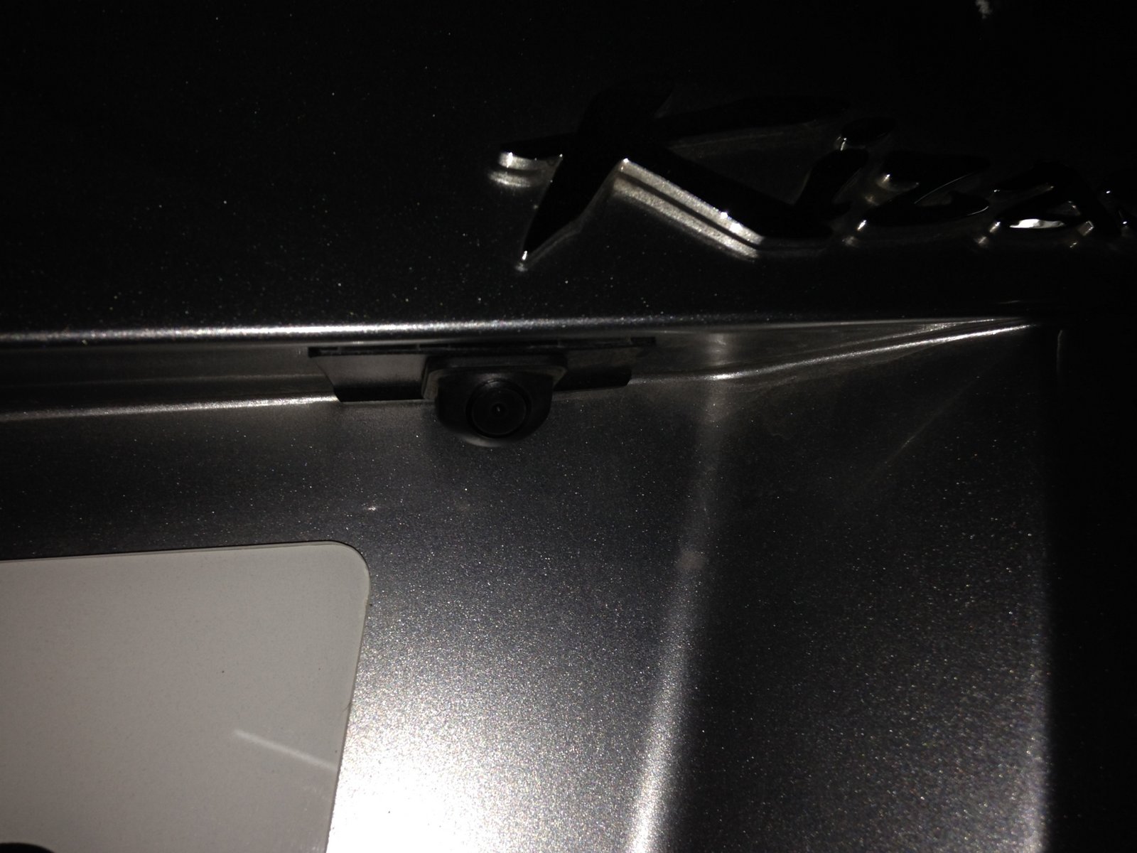

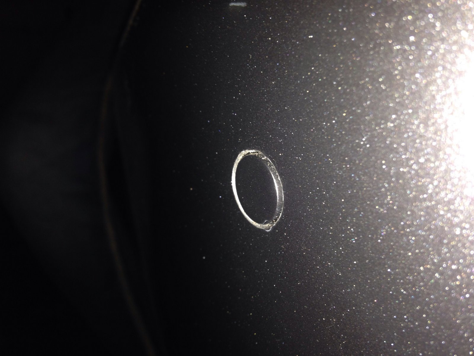

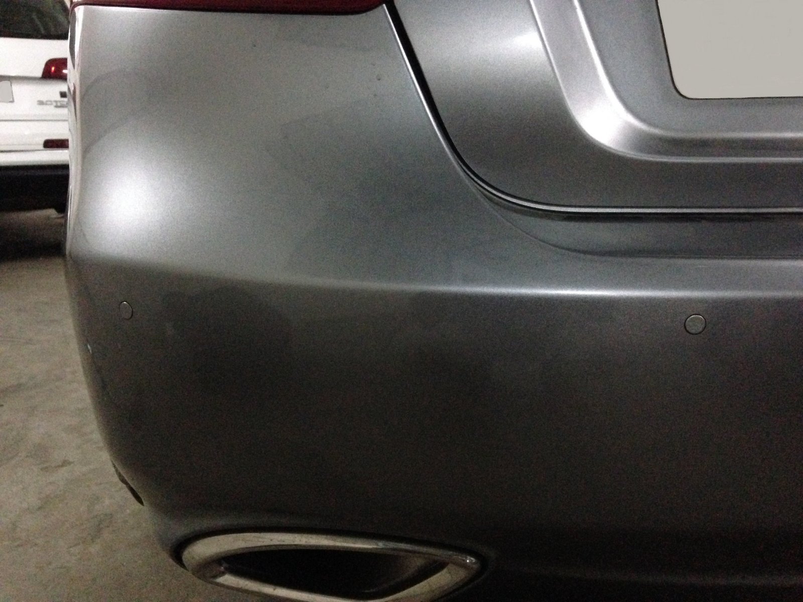

Reverse sensors Installed and colour matched.
Overall ecerything should be complete in 24hrs

Focal Speakers Used * 4

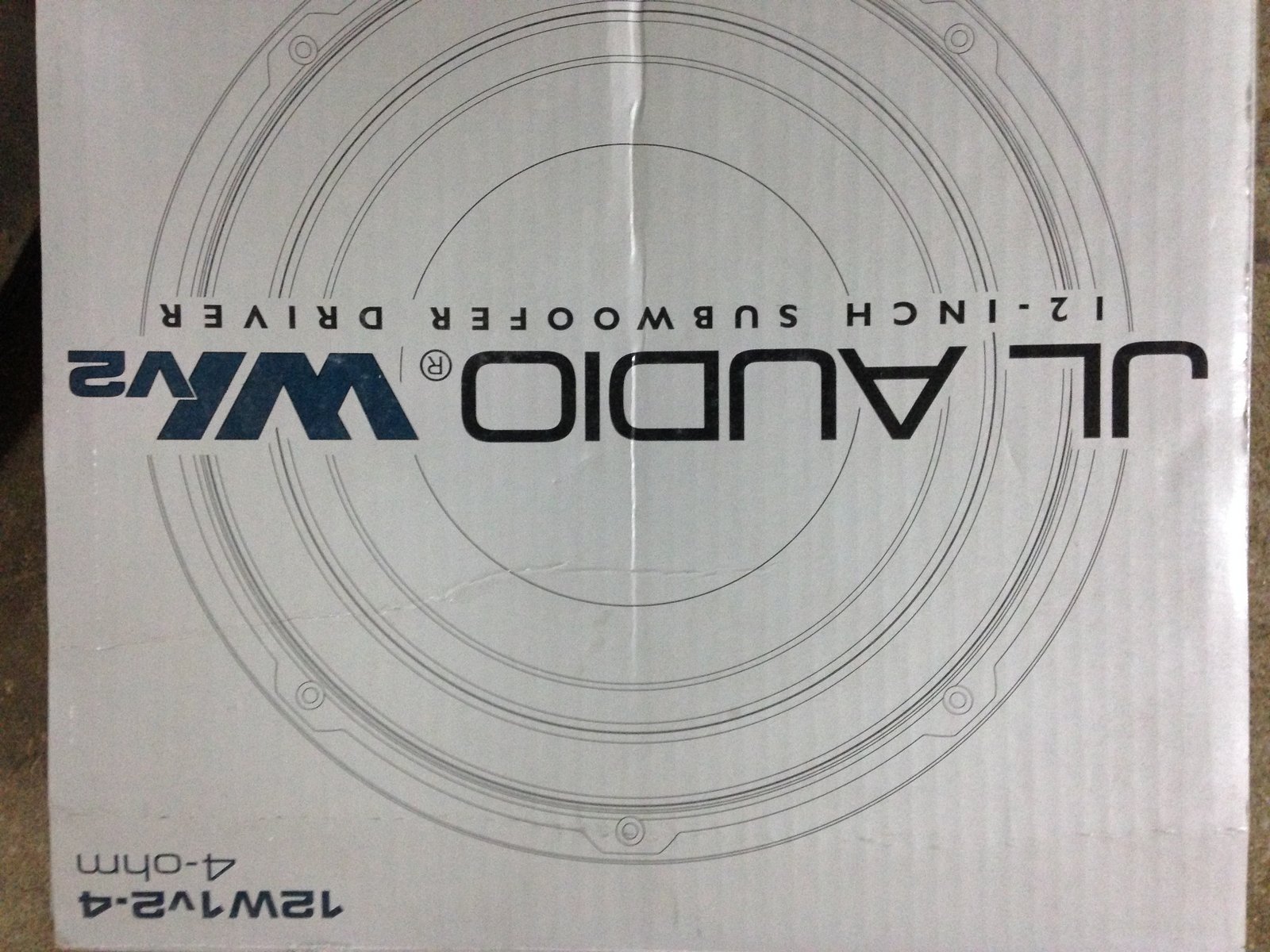

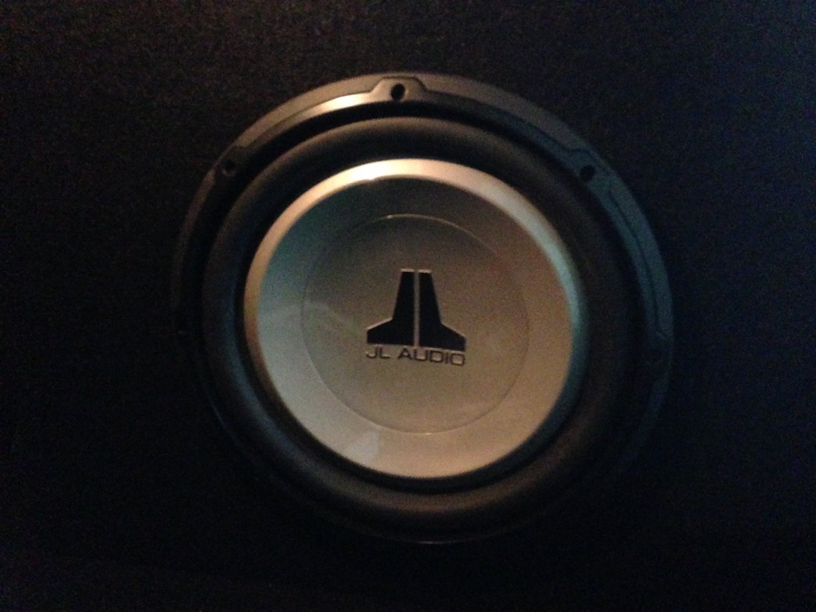

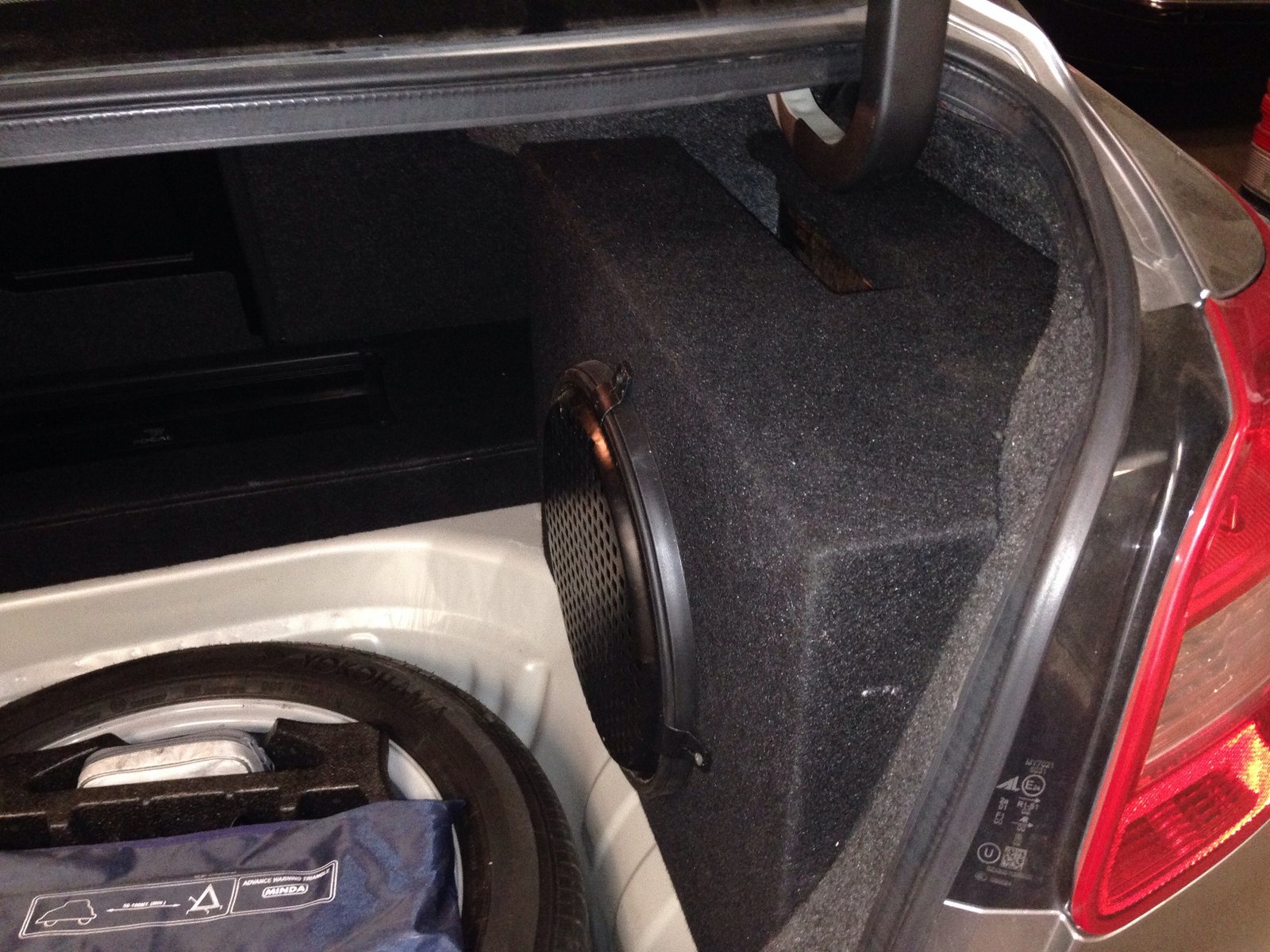

Changed from Focal sub woofer to JL audio Subs.* Focal subs were less effecttive and bass effect was not that great. where as JL gives a cleaner Bass

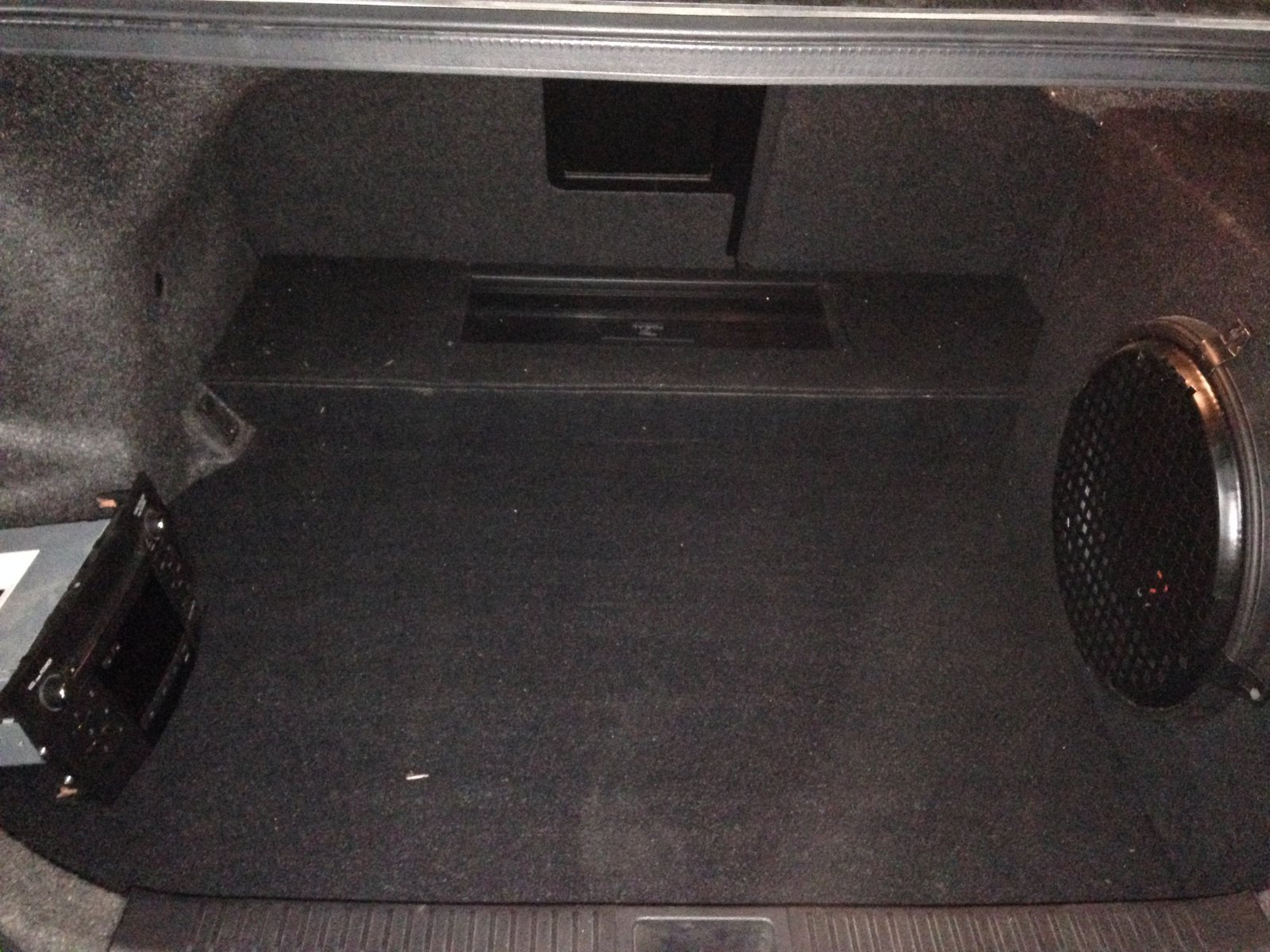

JL Sub box in the Boot

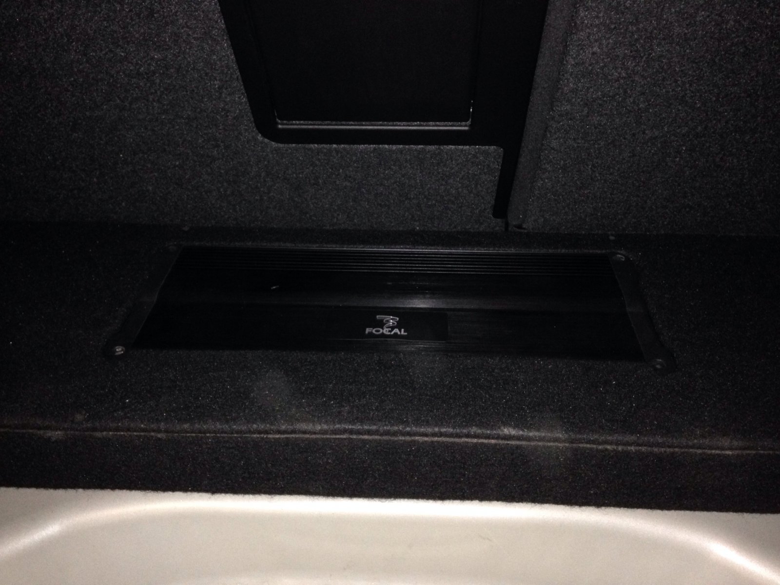

Complete boot area with Amp and Sub Box.<br /><br />See the old head unit in the corner:-(

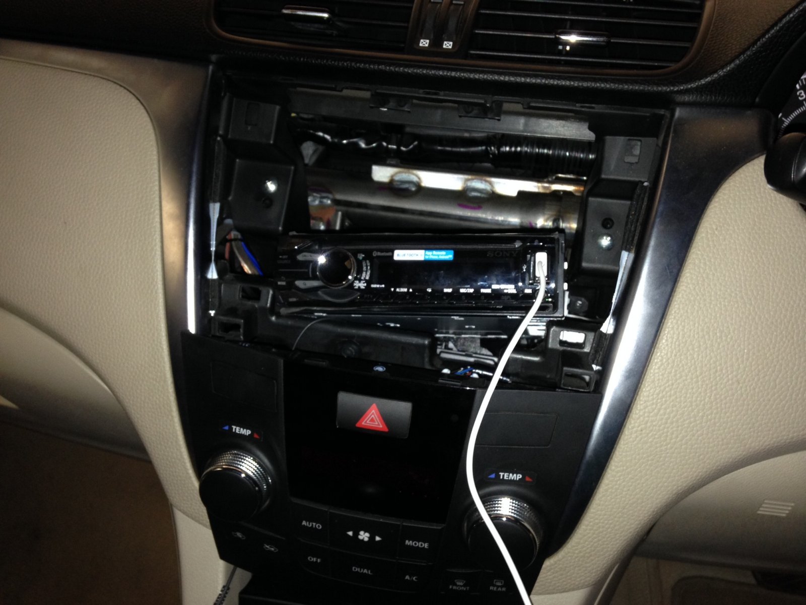

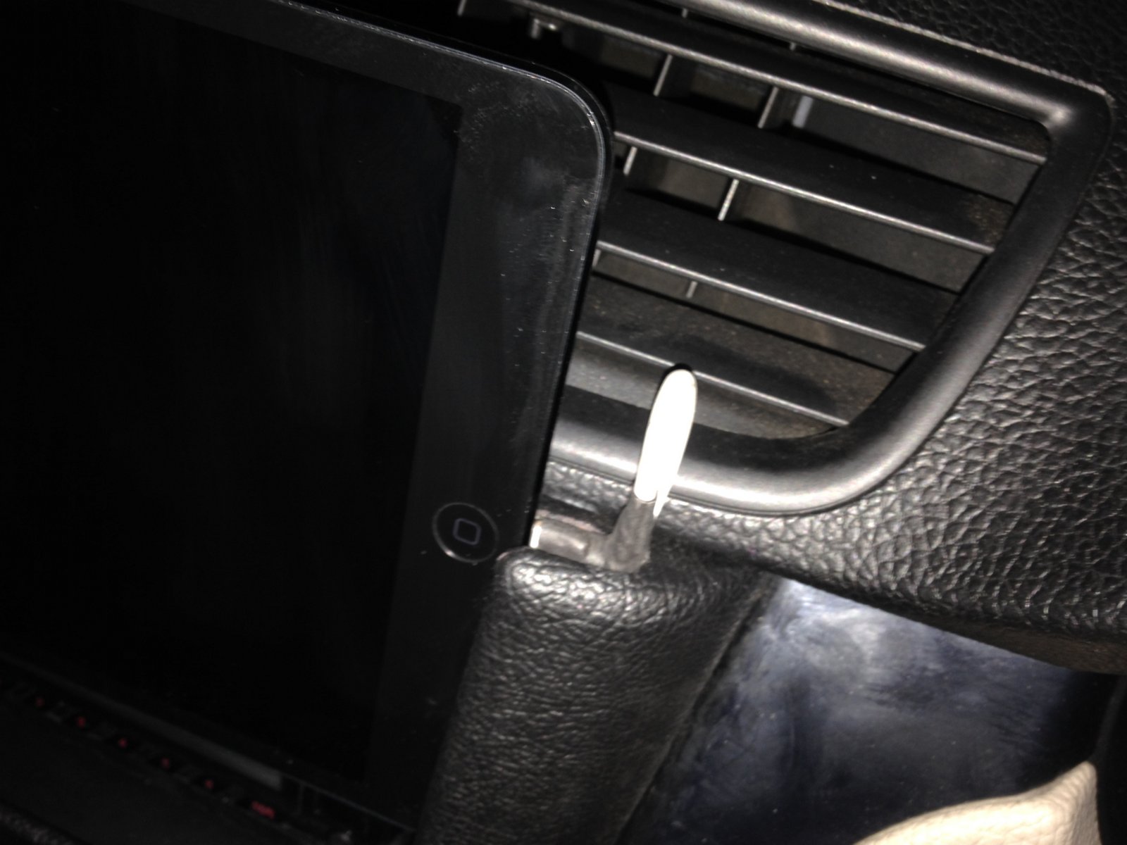

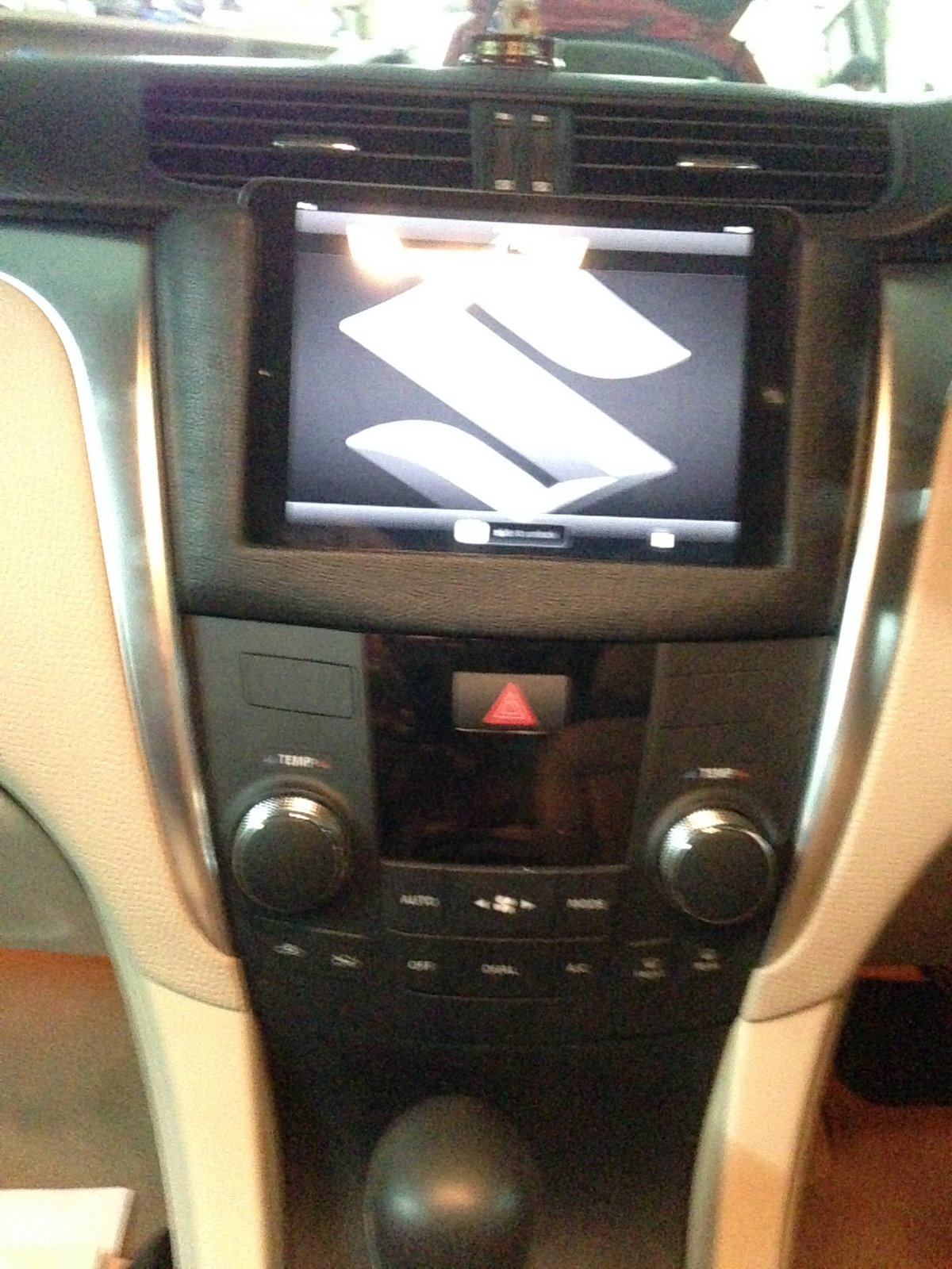

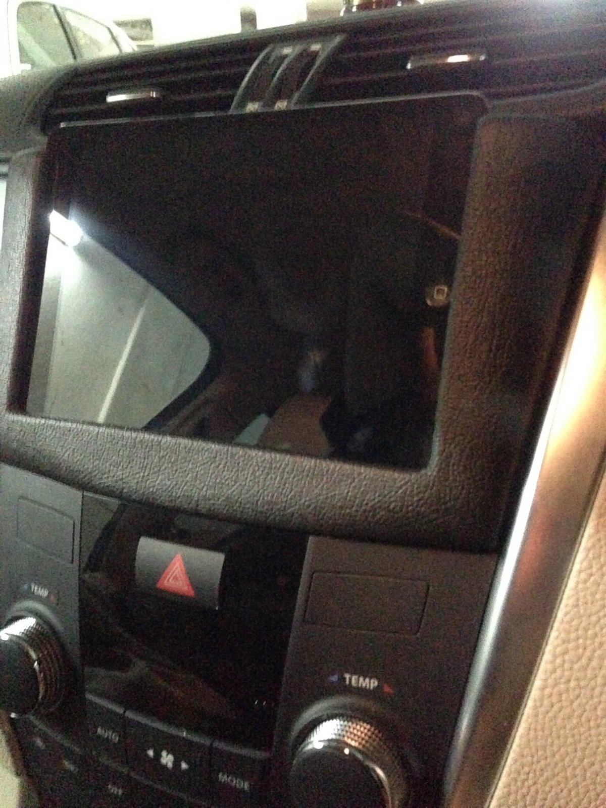

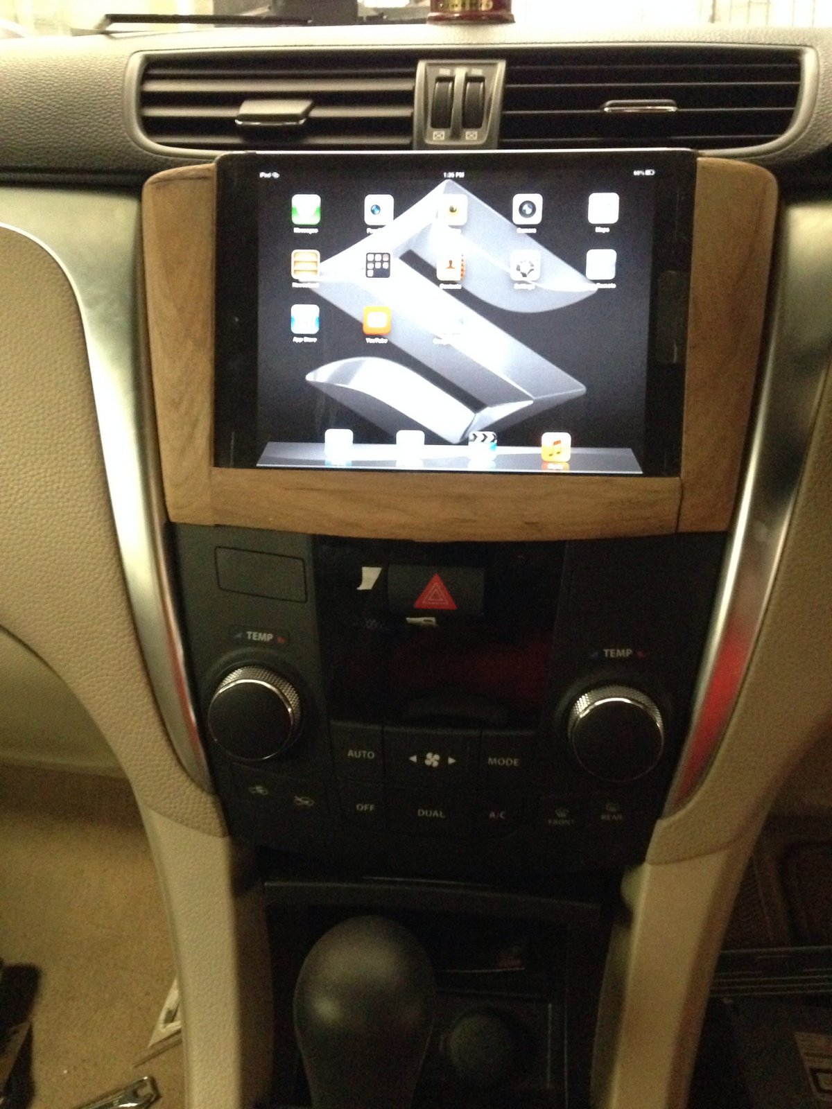

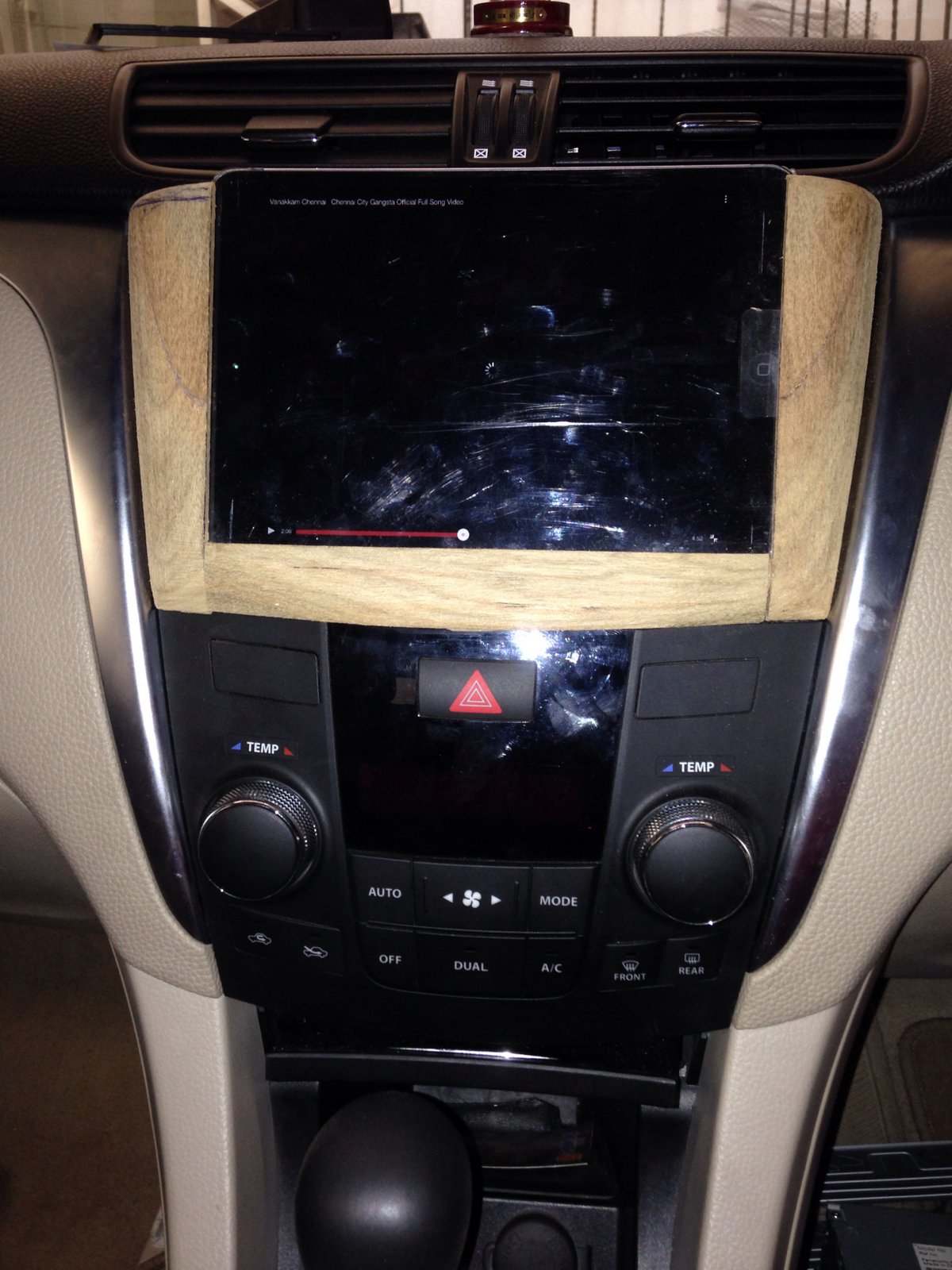

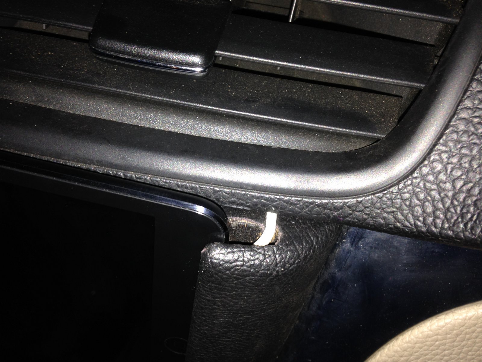

Ipad mini Installed in the dash . the mount was made in wood and leather wrapped to match the texture of the dash.

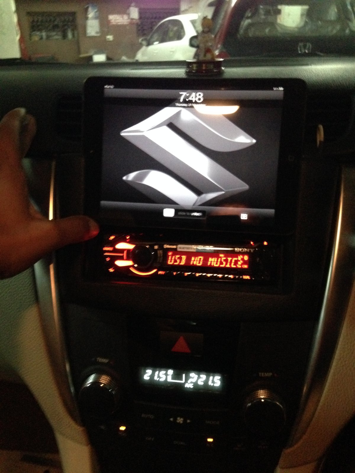

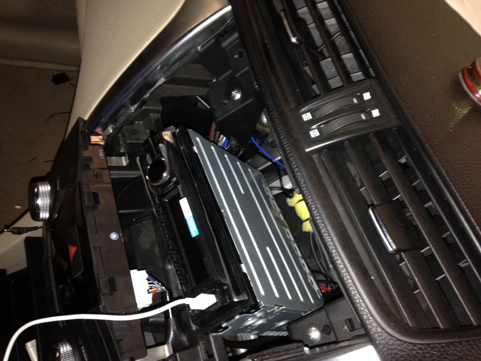

Sony head unit was enclosed behind the Ipad for easy access in case any setings goes wrong

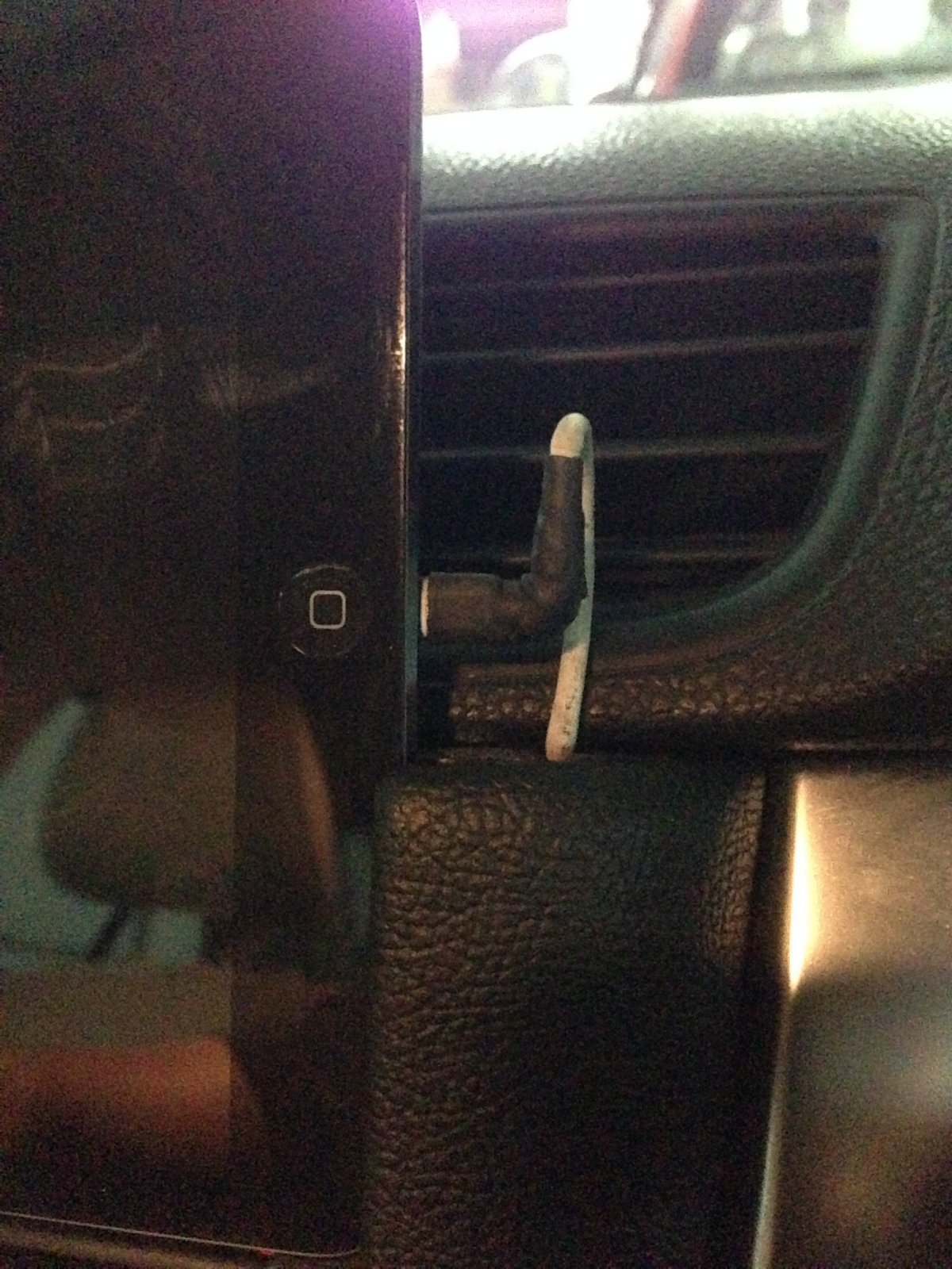

Iphone dock connector cable had to be cut and bent to fit in the panel.* sony App Remote supports only when usb cable is connected, so had to make in a way that ipad is connected always via USB to sony

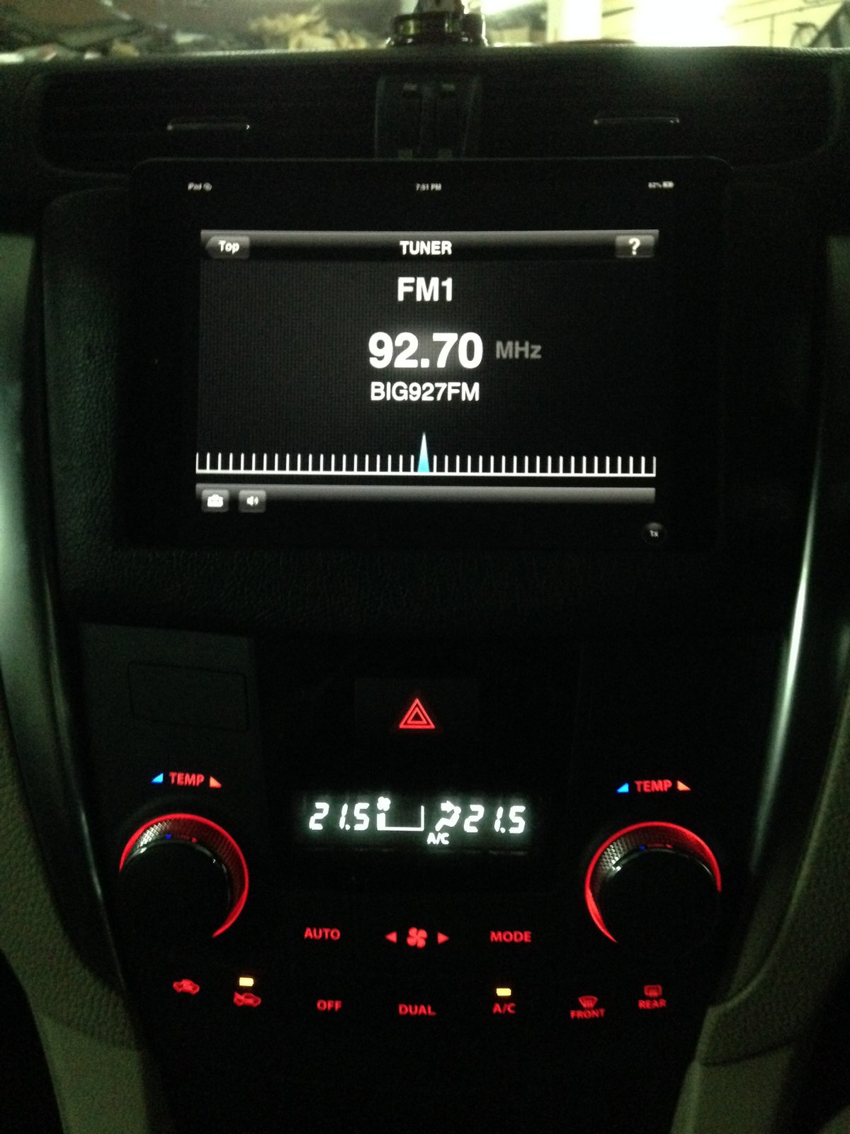

FINAL FINISH WITH THE APP RUNNInG
