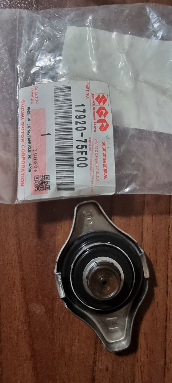

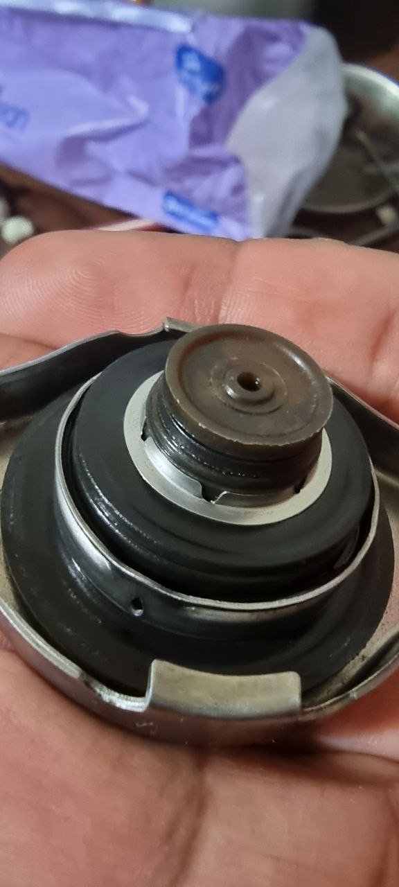

today I changed my car radiator cap @180,000Km I noticed some color degradation in the upper washer also the spring inside of the old one can be easily pressed down but the new one is much harder to press.
Good preventative maintenance item! I've had a couple cause me issues when they stopped holding pressure.

Yes, n8dogg indeed it is holding higher pressure in the cooling system makes the boiling point of the coolant go higher. and that's good for the engine. today I checked my car with diag to see car parameters like the ECT temp sensor I was surprised to see that the engine fan comes on at 103 C(218F) at this temperature car needs good coolant and also good pressure hold.
