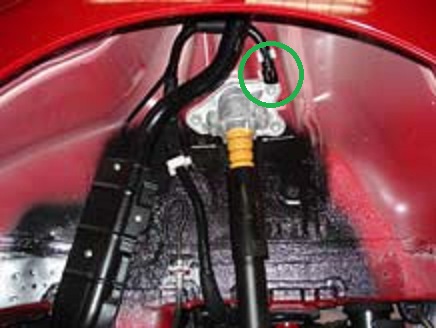

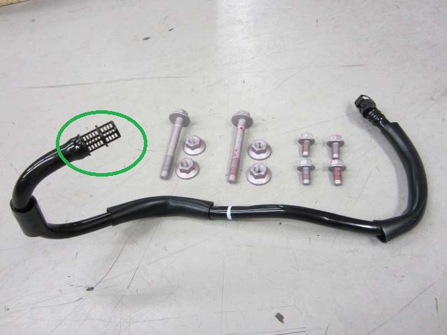

Spider could have been a problem, but no longer that I placed mesh screen over the vapor vent hose. 15min of work that will prove to do the same as there lengthy work instruction, minus the damage.

Sorry to go off topic but do you have any pictures or details on how to do this?nytq wrote: Spider could have been a problem, but no longer that I placed mesh screen over the vapor vent hose. 15min of work that will prove to do the same as there lengthy work instruction, minus the damage.
Sorry but I did not take pictures. I did include pictures from the original work instruction. Really simply though.
1) Remove the wheel well liner. Half a dozen plastic clips, some screw plastic nuts.
2) Pull the vent hose out of the clip that holds it in place. This is located to the right of the shock mount at the top of the wheel well.
3) Cover the end with something like a piece of window screen material. I tie wrapped it in 2 places and then just put the hose right back in the clip.
4) Replace wheel well liner. Done!

Thanks for the info NYTQ. Seems easier than driving 100+ miles round trip to the dealer. Probably get it done in less time than it would take to drive there. The saved wait time at the dealer and drive home time are the payment for DIY.
Just one question which rear wheel? Drivers side I would guess.
