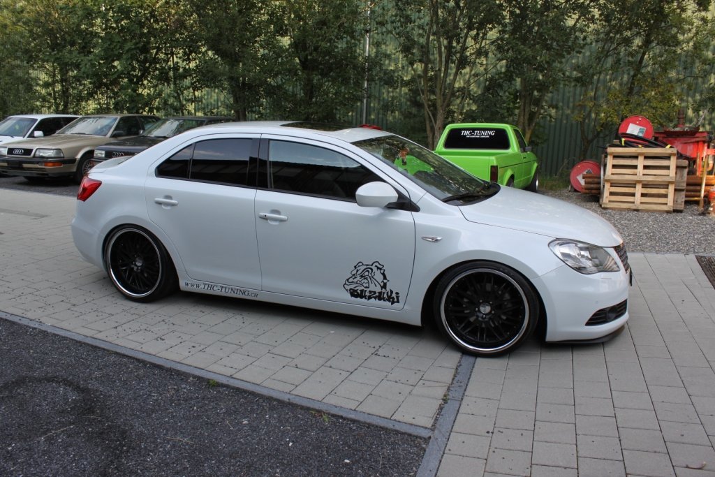

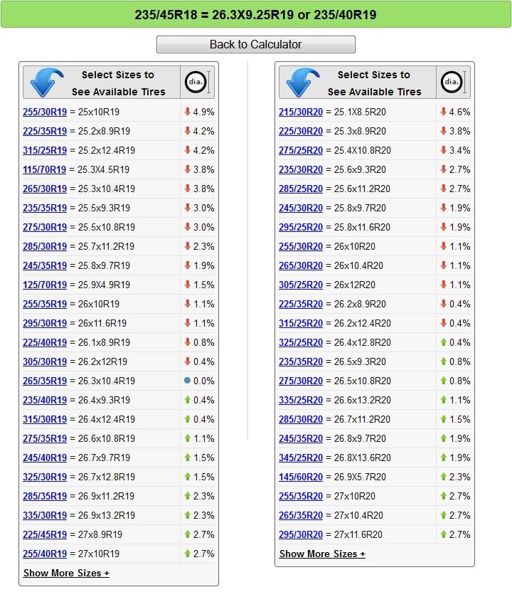

20's done tightly .. (not my rig) .. and a nice guide for rubber selection centered on our OE tire.
- Kizashi 2012 (15).jpg (177.19 KiB) Viewed 12553 times
- kizashi oem tire sizes - options.JPG (158.52 KiB) Viewed 12553 times
Who's car is this? Any idea of what suspension setup he's running?
