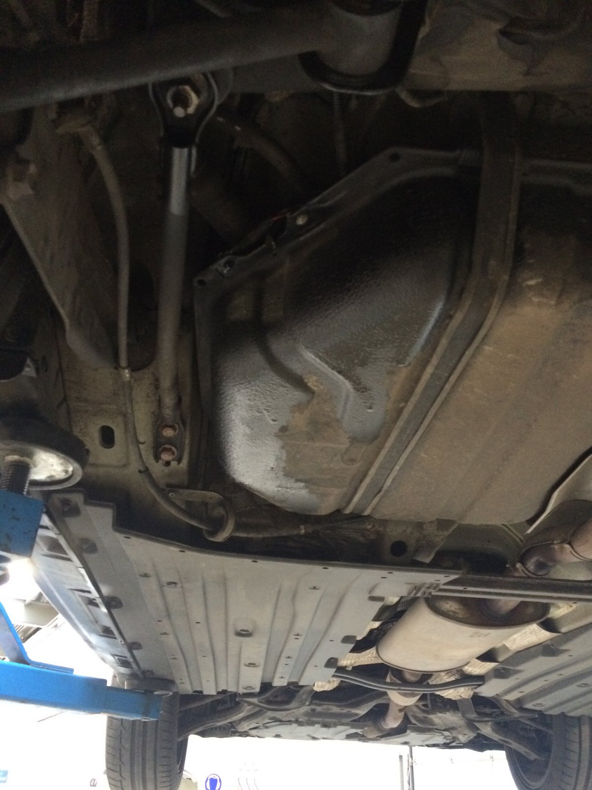

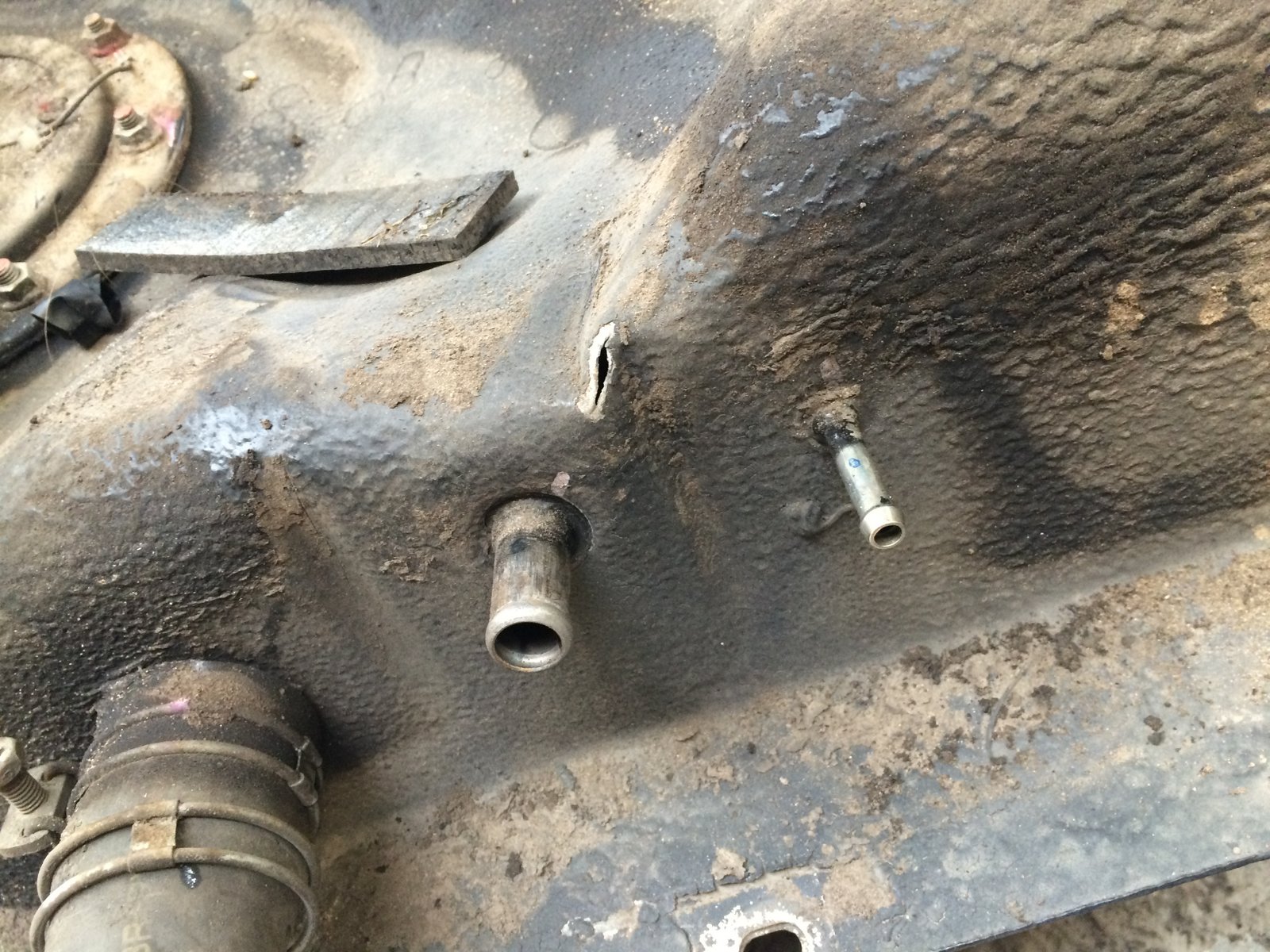

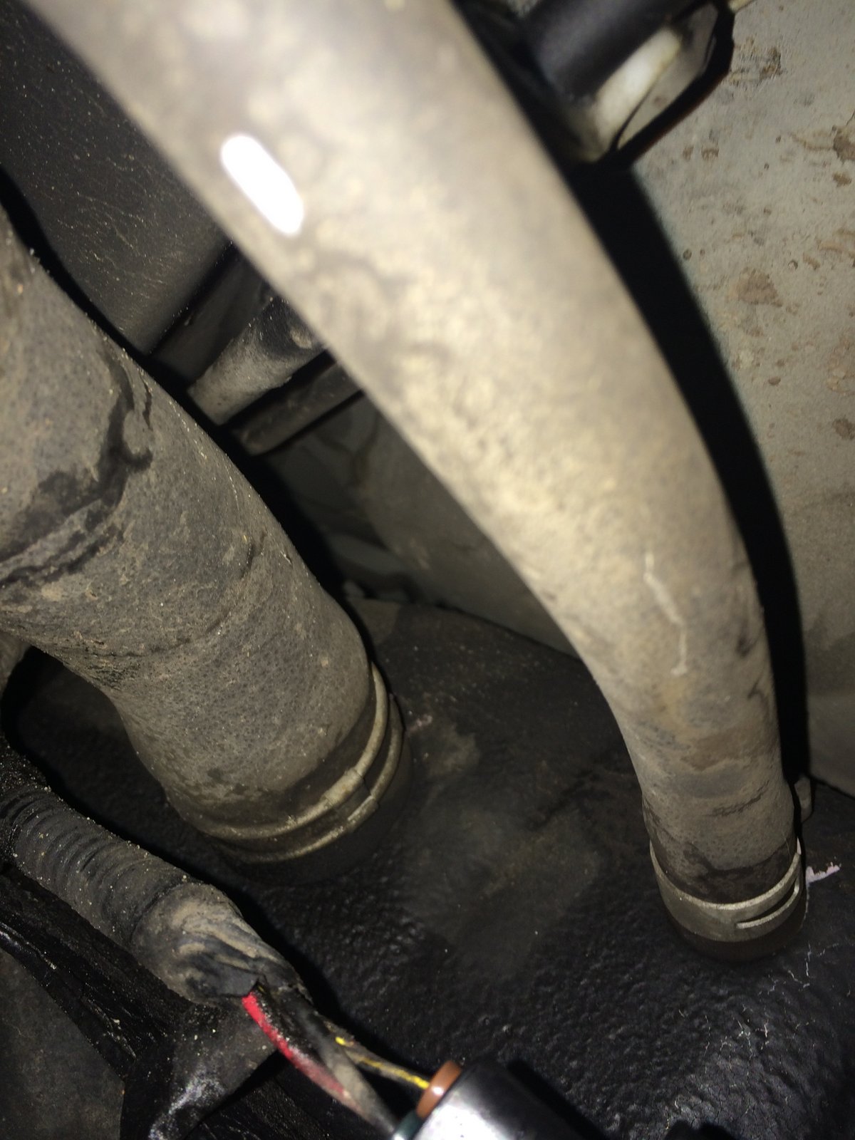

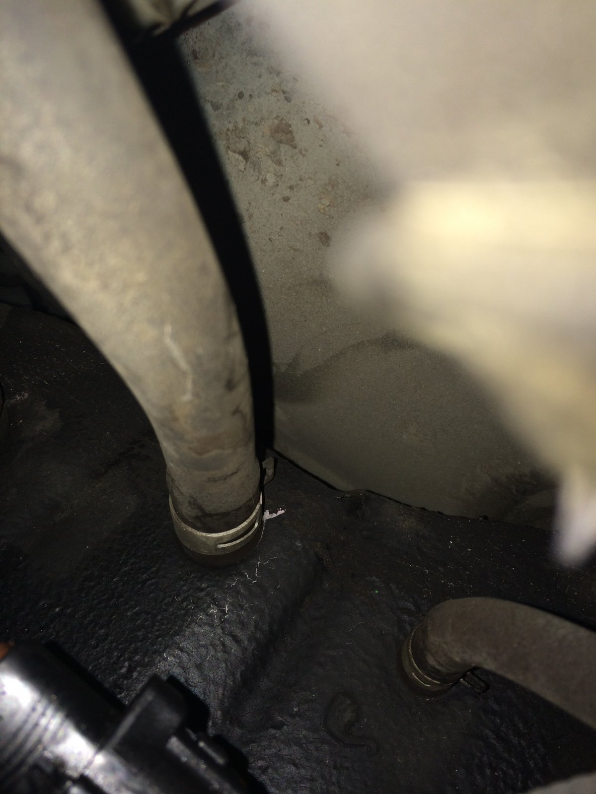

Car is at the dealer today. The y found out the fuel tank is 'pretty wet' outside.
They suspect the seam to (have a) leak. When lucky it might just be a (pump)seal...
However, the theory suits my notice that it mainly occurred when tank is full/half full
here's some pictures the dealer took ... underside and ( I presume) top side of the tank
