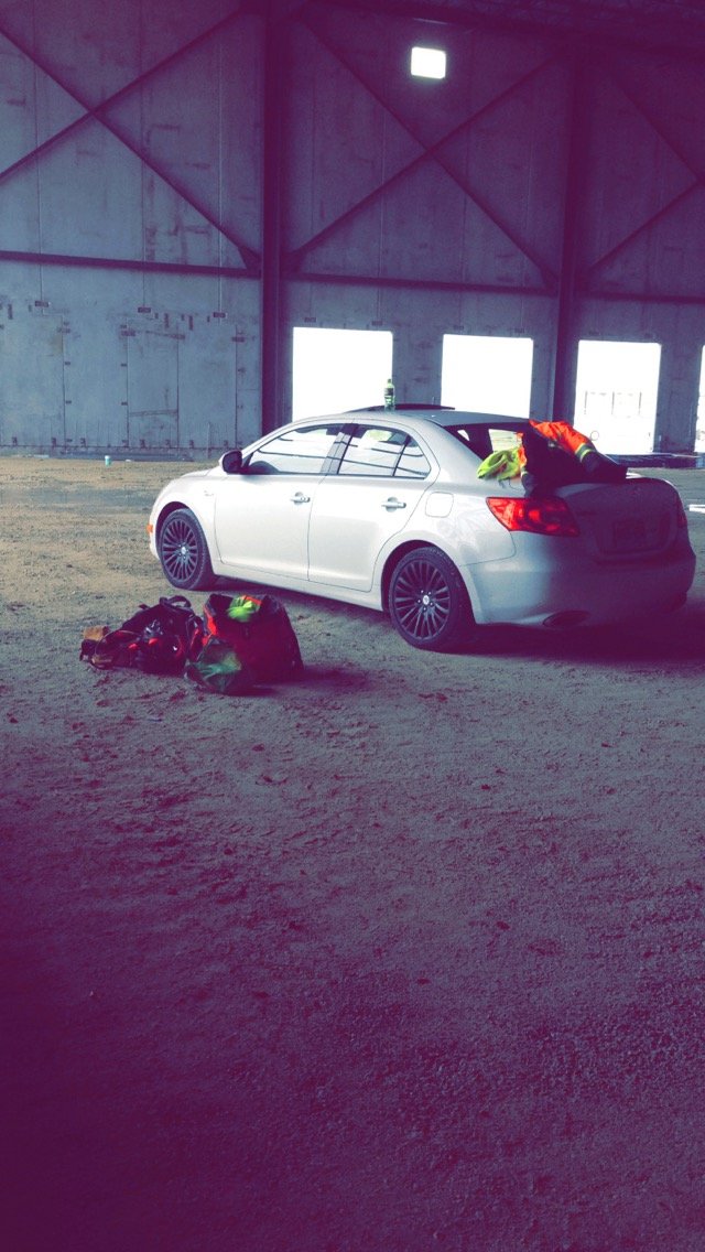

New to Club! What kind of air intake do I put on my 2011 Kizashi SLS awd?
- Posts: 1
- Joined: Thu Mar 24, 2016 12:34 am
I'm looking to get an intake in the next few days .... Any segestions on the kind .... Do I get a Ram intake ... Please help!!
