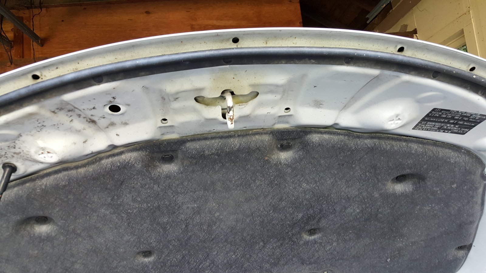

dslatsh
Posts: 127
Is this what it should look like?
