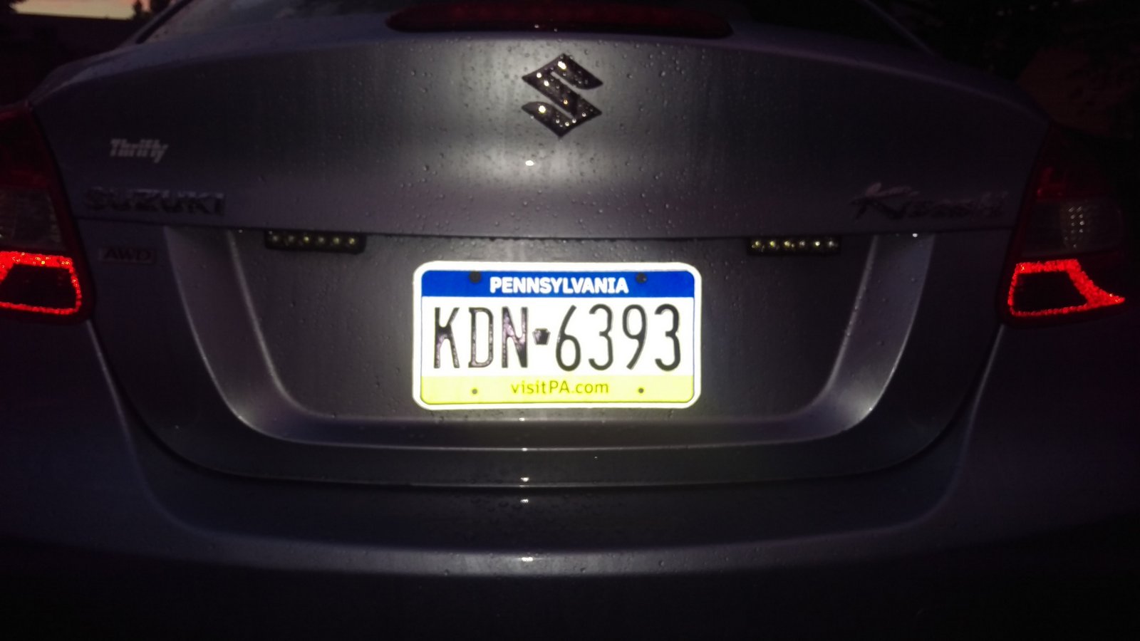

I started tonight with mounting two amber and blue led lights to the back deck lip of the trunk on either side of the license plate lights. I plan to run the wires to my switch box that is hidden in the arm rest and will tap into the aux outlet in that location. I ran the wires for the rear lights through the whole for the camera mount, since I don't have the camera, I drilled a whole into the "plug" that Suzuki put in place and ran the wires through there.

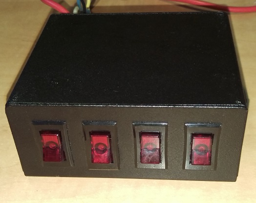

Here is a picture of the back of my car, this is the only lighting needed, I will post video once it is wired this weekend. I am also including a picture of the switchbox that will be mounted in the arm rest, if all goes well, the wiring should all be hidden and professional looking....either way it will be functional, I know some of you on here have been really critical of clean/not clean installs and I will do my best.
Bryan

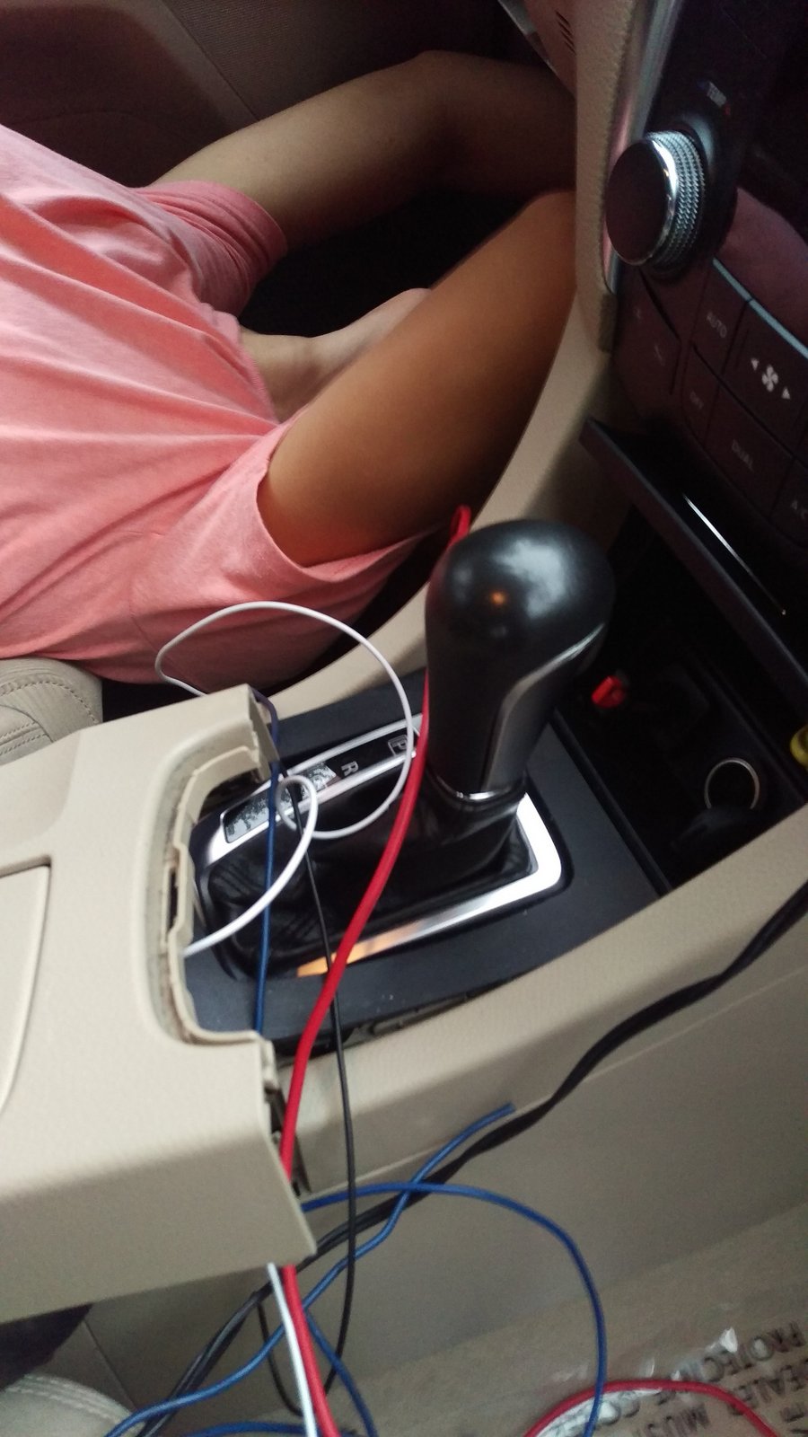

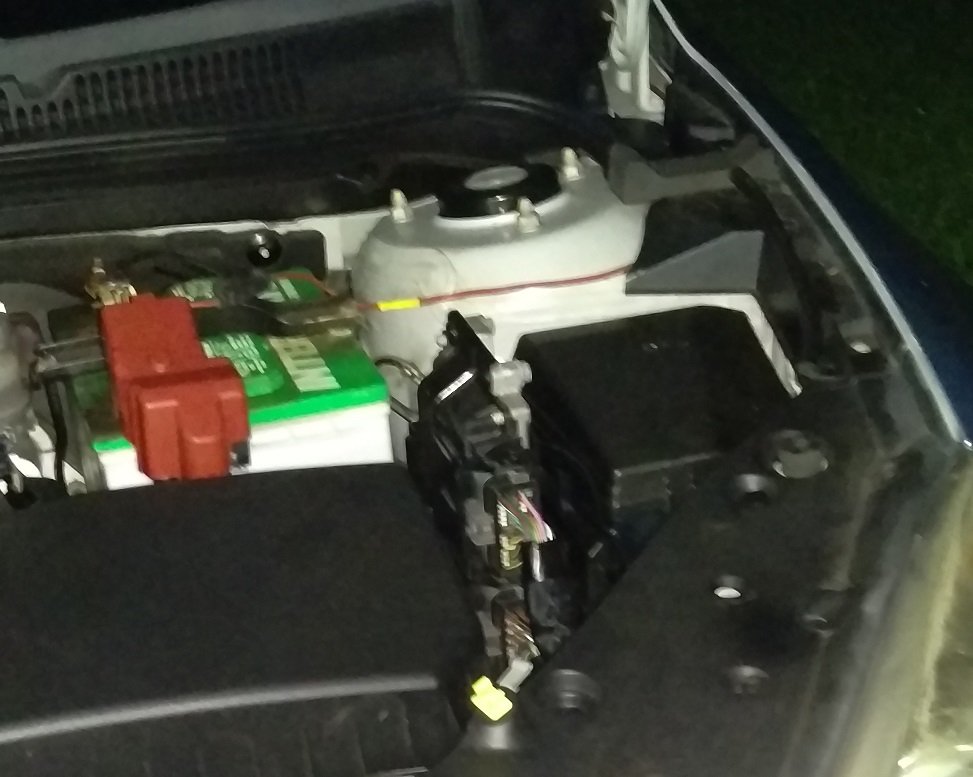

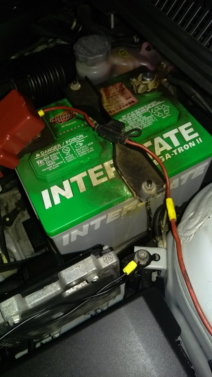

Ok, so here goes, this is my first time doing an install like this on a car I just bought, and writing it up and posting pictures....the main idea is that I wanted to put my emergency lights on the car with out having anything visible while sitting in the car. So in the end we connected all the wiring, but to explain it better, I will follow the wiring from beginning to end result for two of the three tasks.

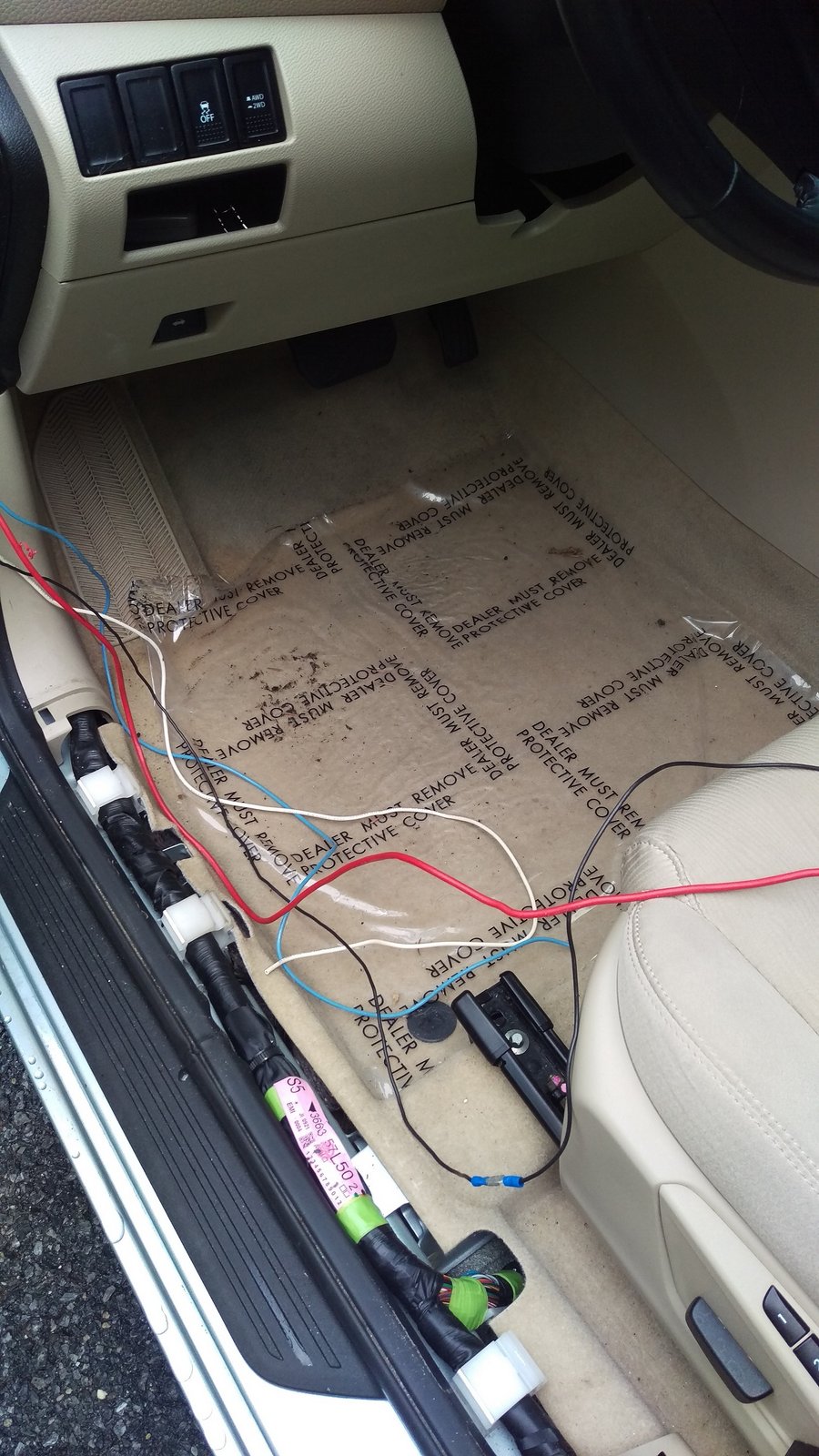

First figure out where to connect wiring and run wires to passenger cabin area:
power to swtichbox in armrest and ground to box, and front lights.jpg (209.99 KiB) Viewed 8296 times

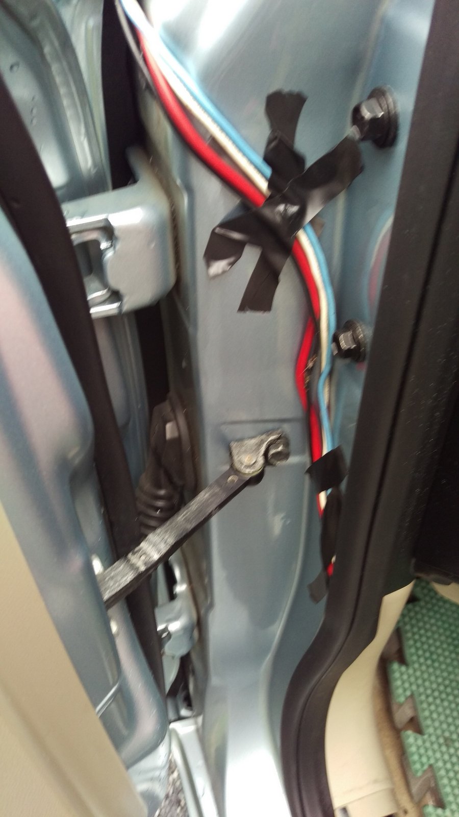

Then run wires in between hood and door, as shown
go under weather stripping but not at the bottom where water would gather and enter the car

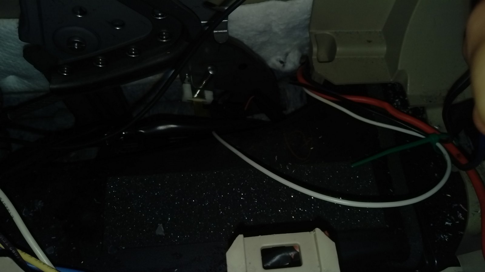

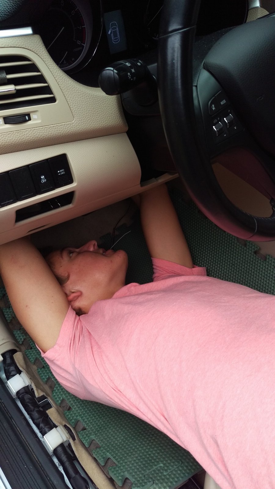

Then hide wires under dash
hiding wires.jpg (201.87 KiB) Viewed 8296 times
and hide them further away from pedals so not to interfere with driving
hiding wires 2.jpg (174.81 KiB) Viewed 8296 times

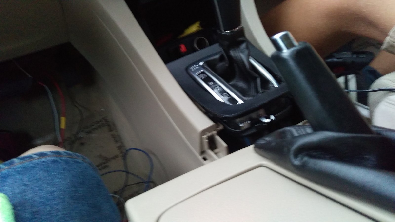

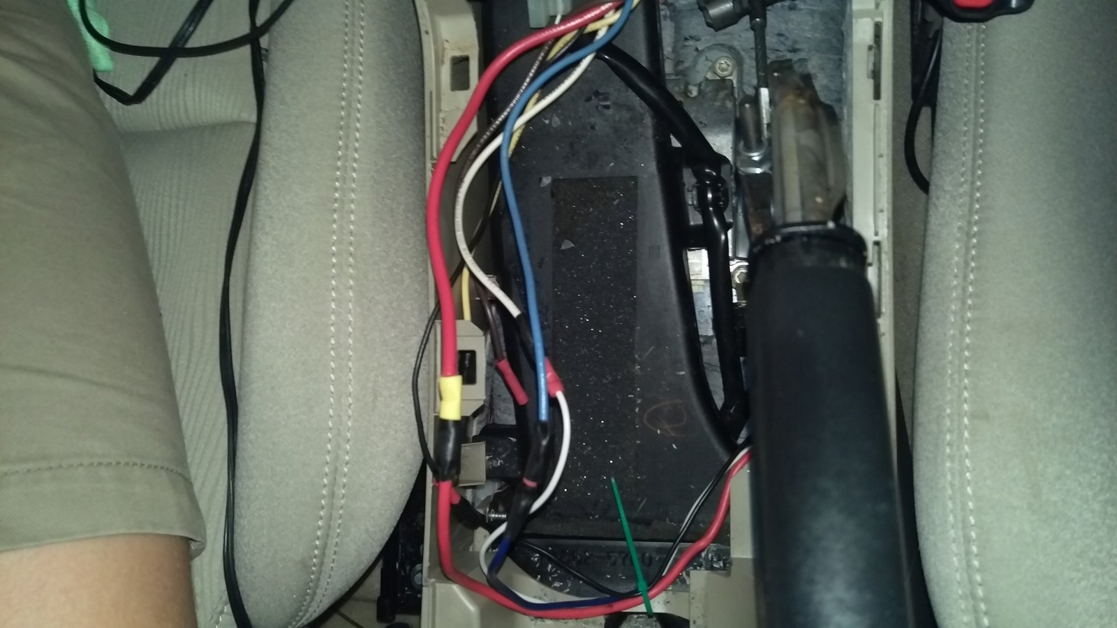

then run wires to center console with armrest as shown
wires come in next to seat to ebrake area.jpg (95.27 KiB) Viewed 8296 times

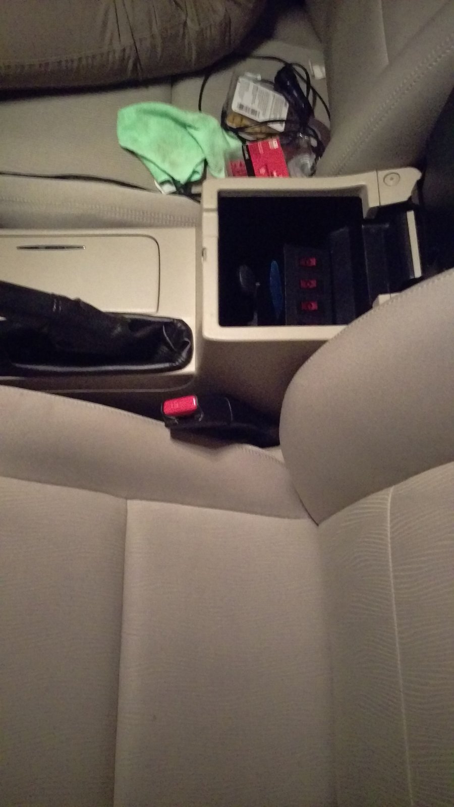

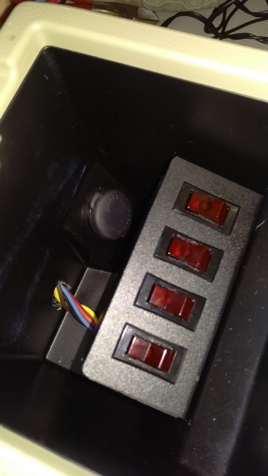

drill hole in front side of armrest from location of cup holder
switchbox w hole drilled.jpg (123.69 KiB) Viewed 8296 times

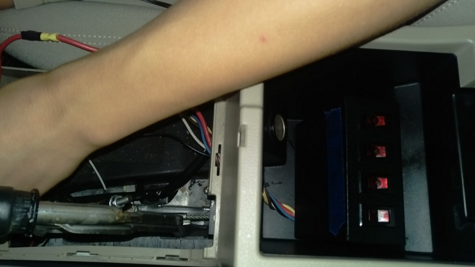

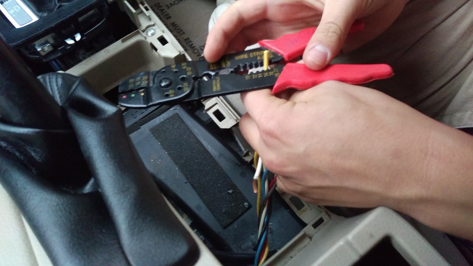

then connect all the wires under where the cup holder goes
splicing n crimping.jpg (188.96 KiB) Viewed 8296 times
connecting switchbox.jpg (114.89 KiB) Viewed 8296 times
wiring that sits under cup holder.jpg (179.12 KiB) Viewed 8296 times

Hi again, to continue my complete my first task, all i needed to do was check that the switchbox worked and reassemble everything....this is how it looked while everything was being connected:
teardown before routing wires.jpg (149.97 KiB) Viewed 8295 times
Here is the final product of the switchbox install:
switchbox installed and live-part one done.jpg (152.88 KiB) Viewed 8295 times

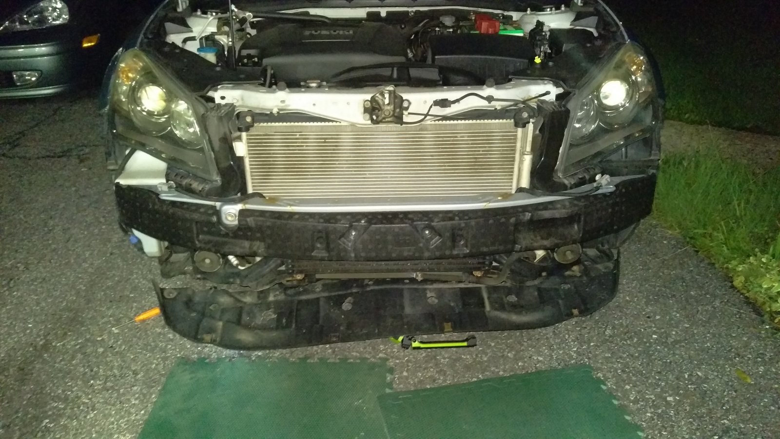

First thing we did was remove the bumper, completely....
part two-step one remove bumper.jpg (271.91 KiB) Viewed 8295 times

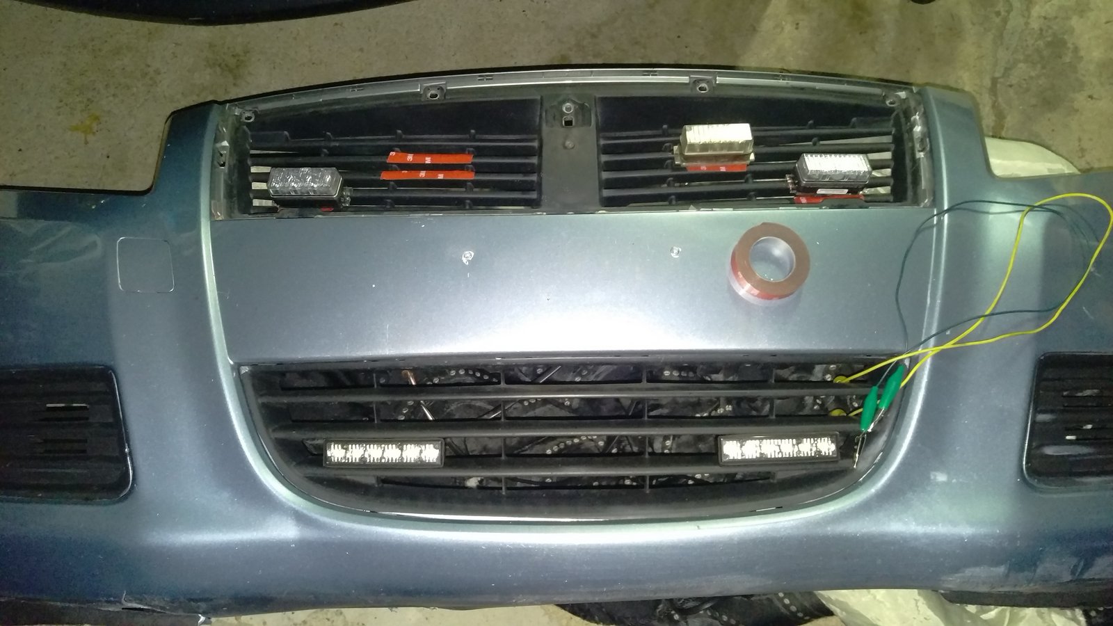

Then we removed the chrome looking S grill and used the black plastic grill behind it to mount the light. 4 blue emergency and while I was at it 2 white led driving (DRL like) lights
step 2-remove s grill and layout lights.jpg (209.46 KiB) Viewed 8295 times

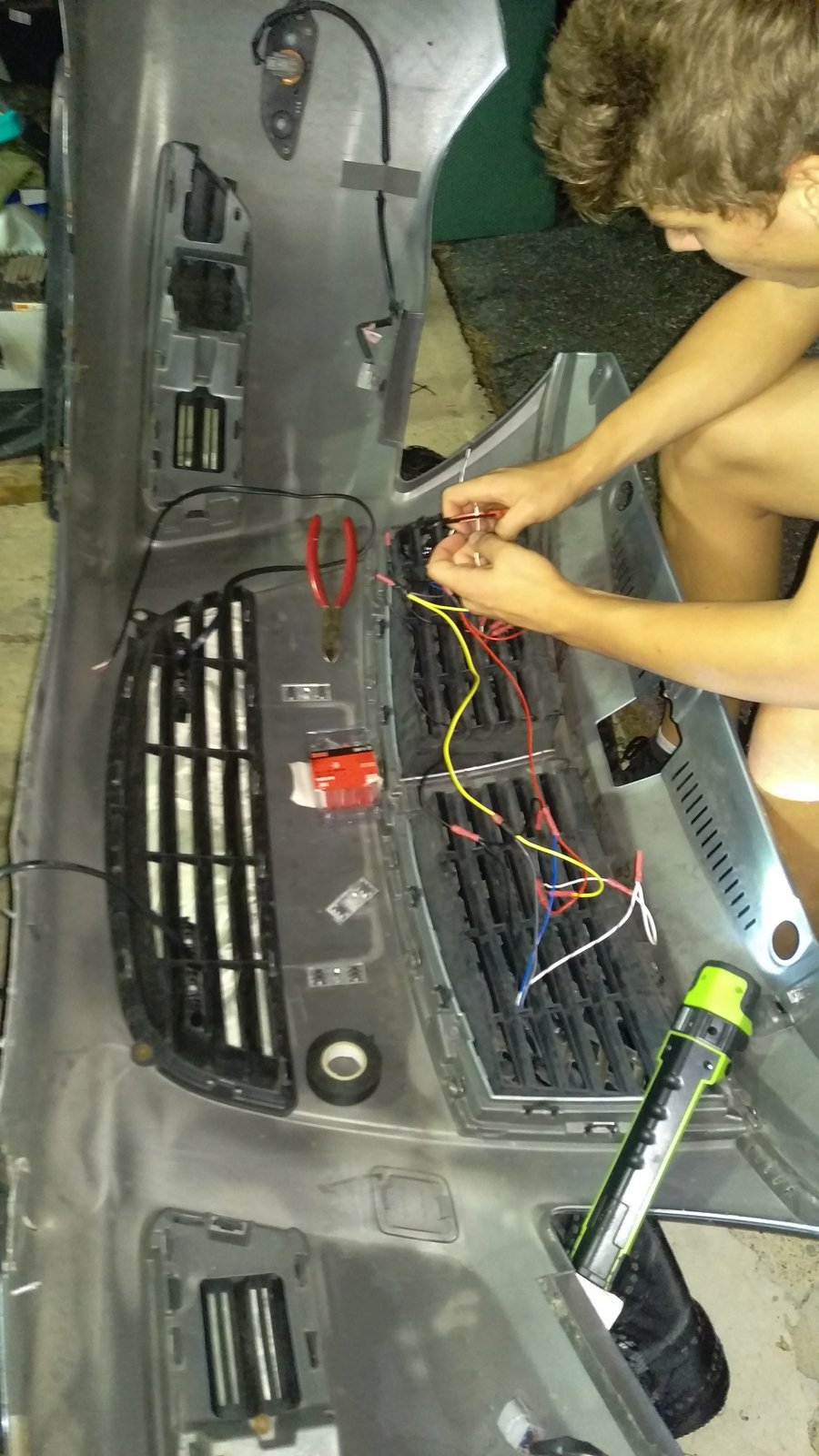

Once we decided where everything was going to sit and made sure it wouldnt be obscured by the license plate(s) or the chrome S on the from we wired then up to each other:
wiring up emergency lights.jpg (215.77 KiB) Viewed 8295 times

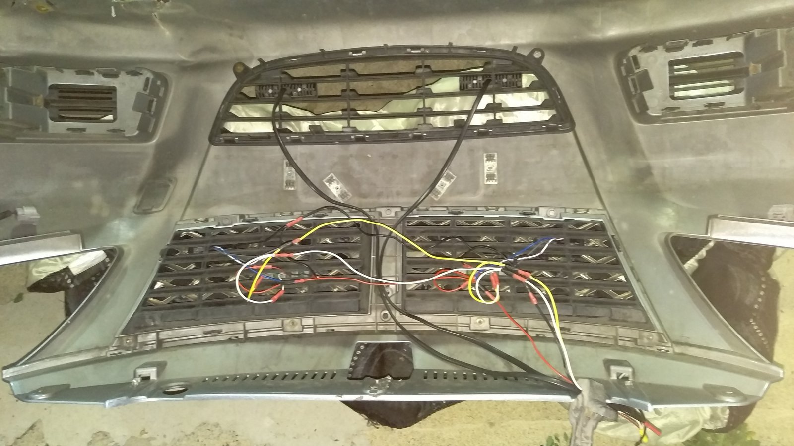

When all the front lights were mounted and wired, we tested them prior to reassembly:
front bumper wiring done, tested, now reassemble.jpg (225.34 KiB) Viewed 8295 times

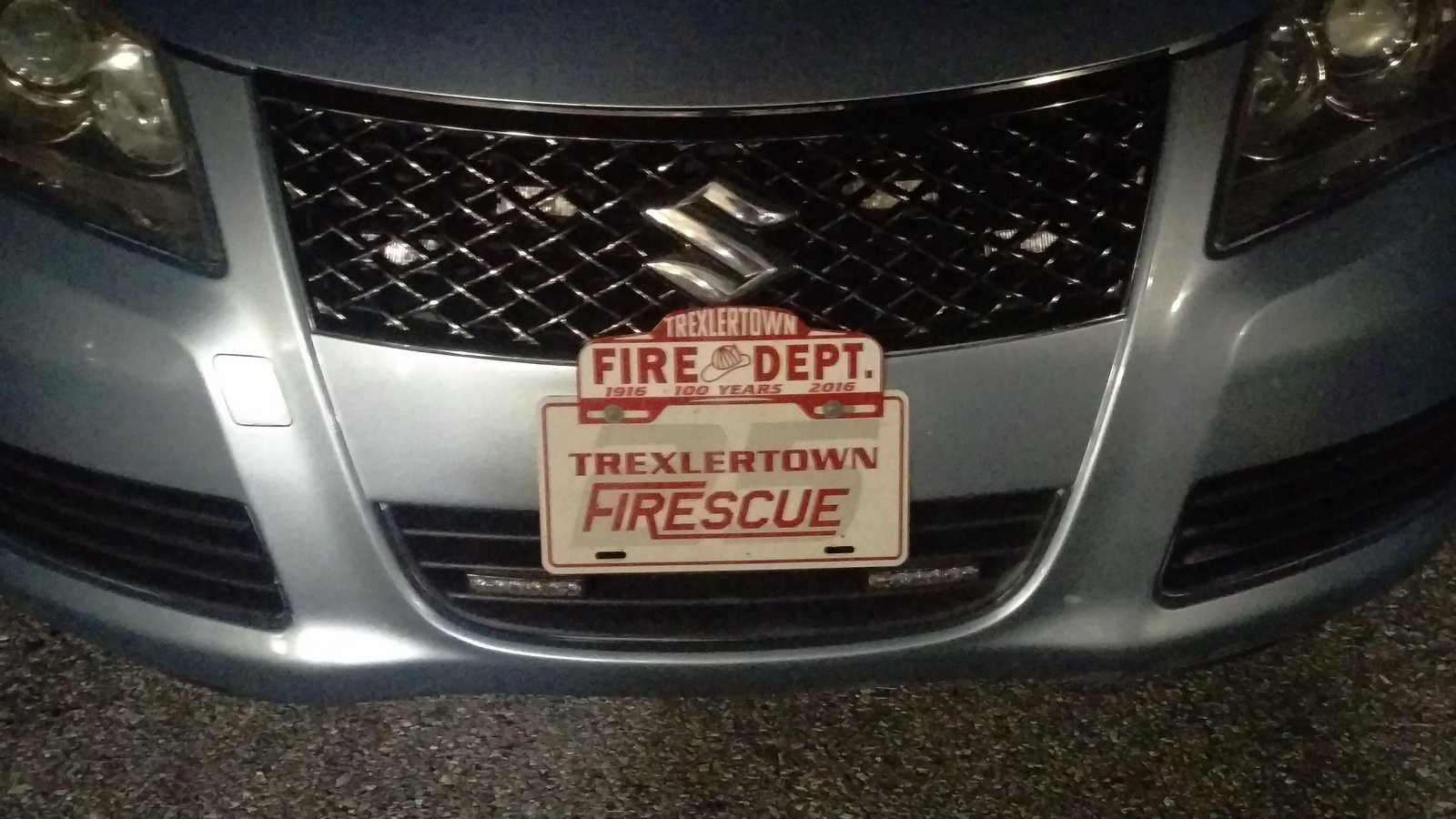

Here is the finished product of the front light mounting that was done by my son and I over last weekend:
all lights mounted, but off.jpg (222.03 KiB) Viewed 8290 times

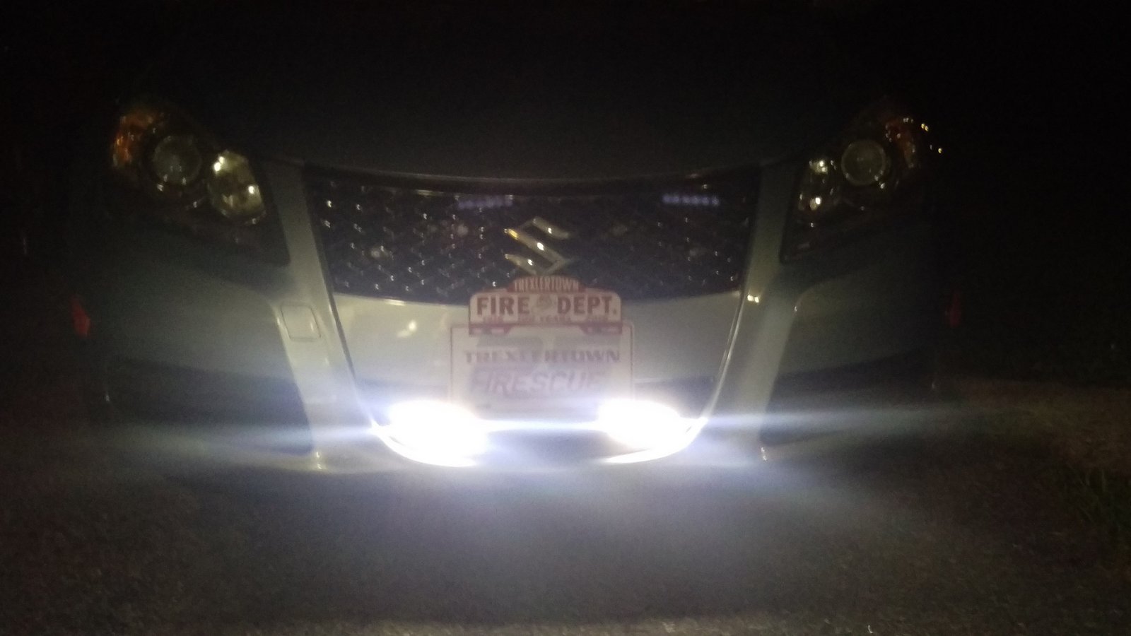

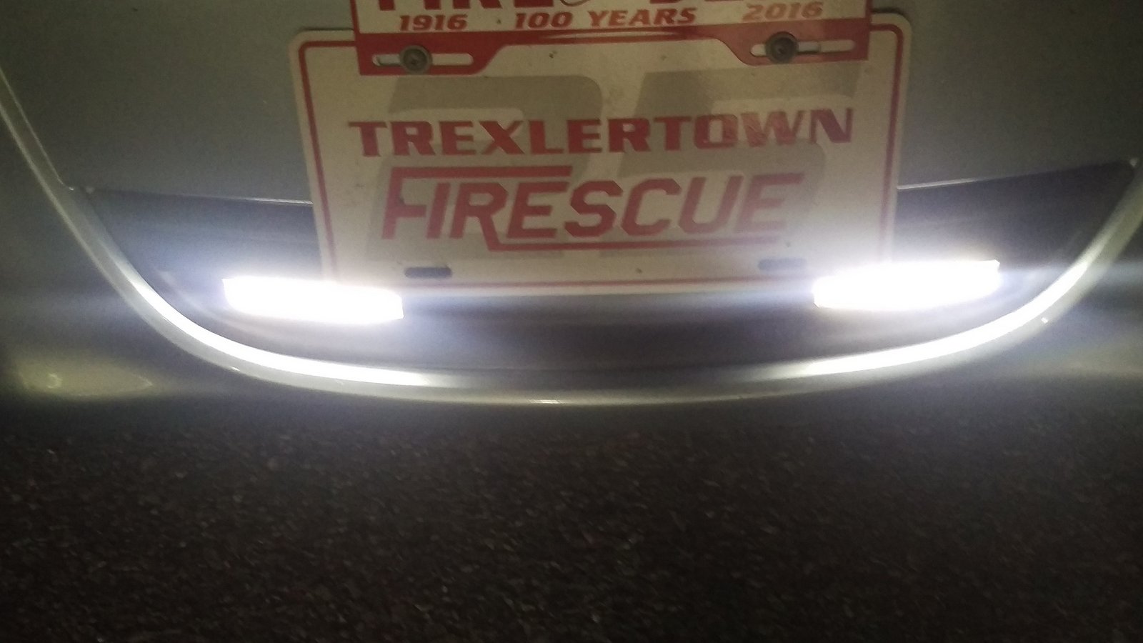

Here are the lower lights turned on (they will be used along with DRL that are OEM:
bright white leds.jpg (112.84 KiB) Viewed 8290 times
and a closeup of them:
bright white up close.jpg (129.58 KiB) Viewed 8290 times

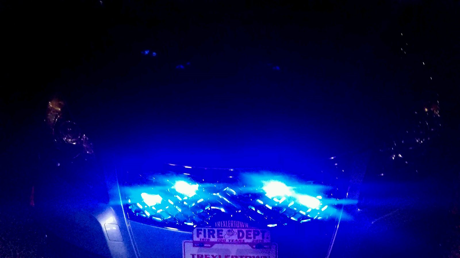

Then I also mounted blue emergency (courtesy) lights that say (please move to the side if you dont mind):
behind grill blue 2 showing.jpg (63.33 KiB) Viewed 8290 times
behind grill all 4 blues showing.jpg (102.04 KiB) Viewed 8290 times
