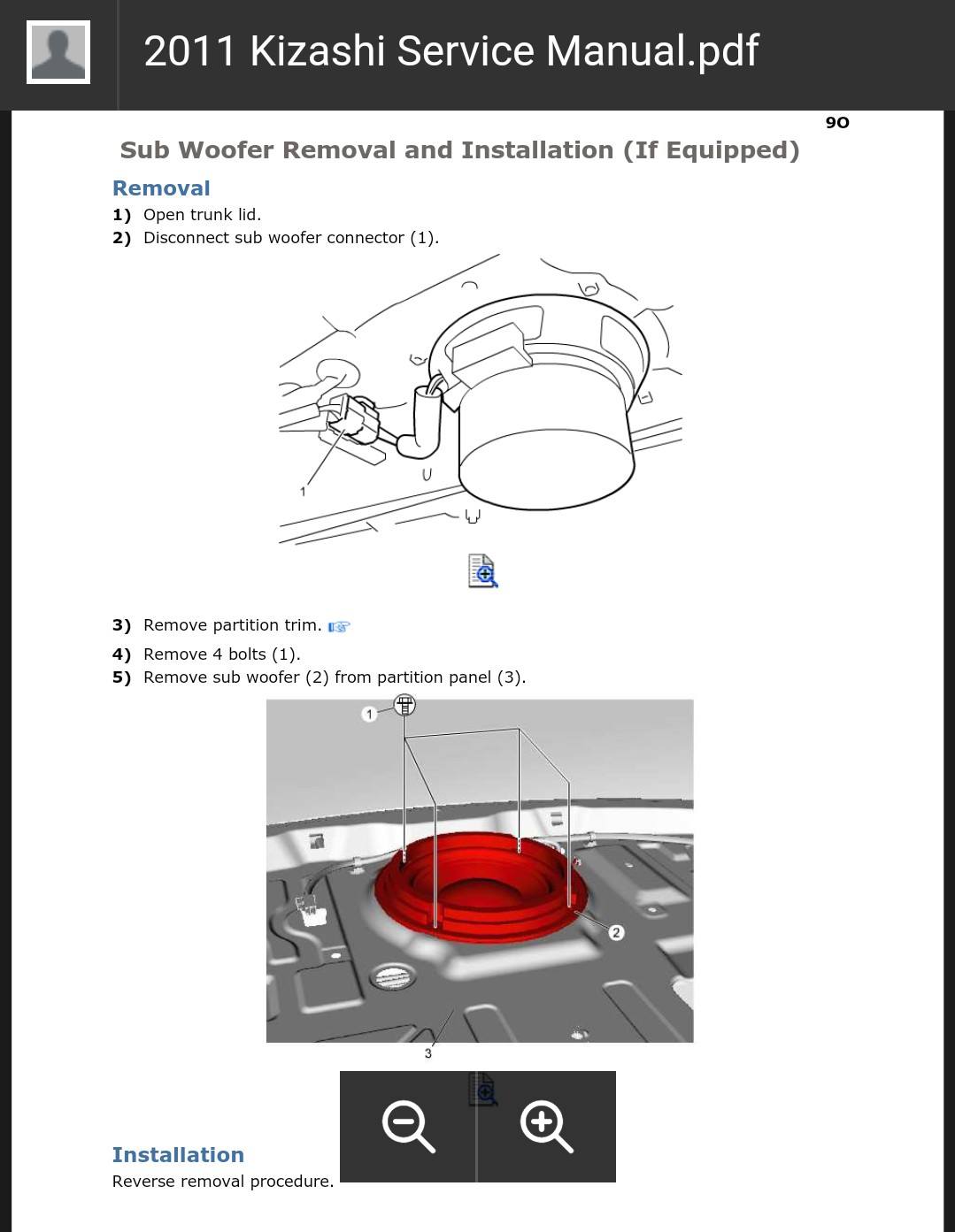

I've tried the service manual and it gives me nothing to work with. All I've managed to find was
I've removed the little plastic bolts but all that does is allow me to lift it slightly. I cant actually access the top of the sub.
BLyons
Posts: 226
If you click on that hand next to the remove partition trim step, it should give you the steps for removing the rear deck cover. I'm assuming that's what they mean by partition trim.

BLyons wrote:If you click on that hand next to the remove partition trim step, it should give you the steps for removing the rear deck cover. I'm assuming that's what they mean by partition trim.
I've already tried that, but I'm assuming this service manual is a copy of an original interactive PDF file. Hence pressing it does nothing, it's not a link, both on mobile and laptop.
