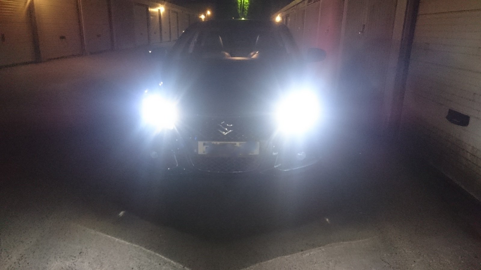

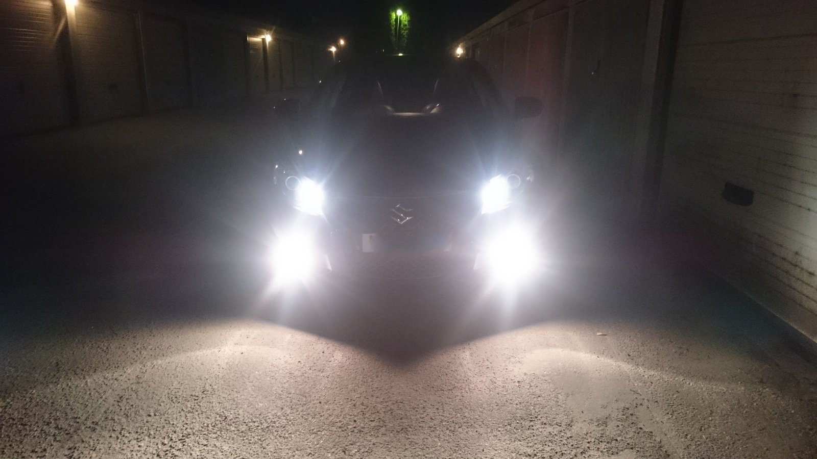

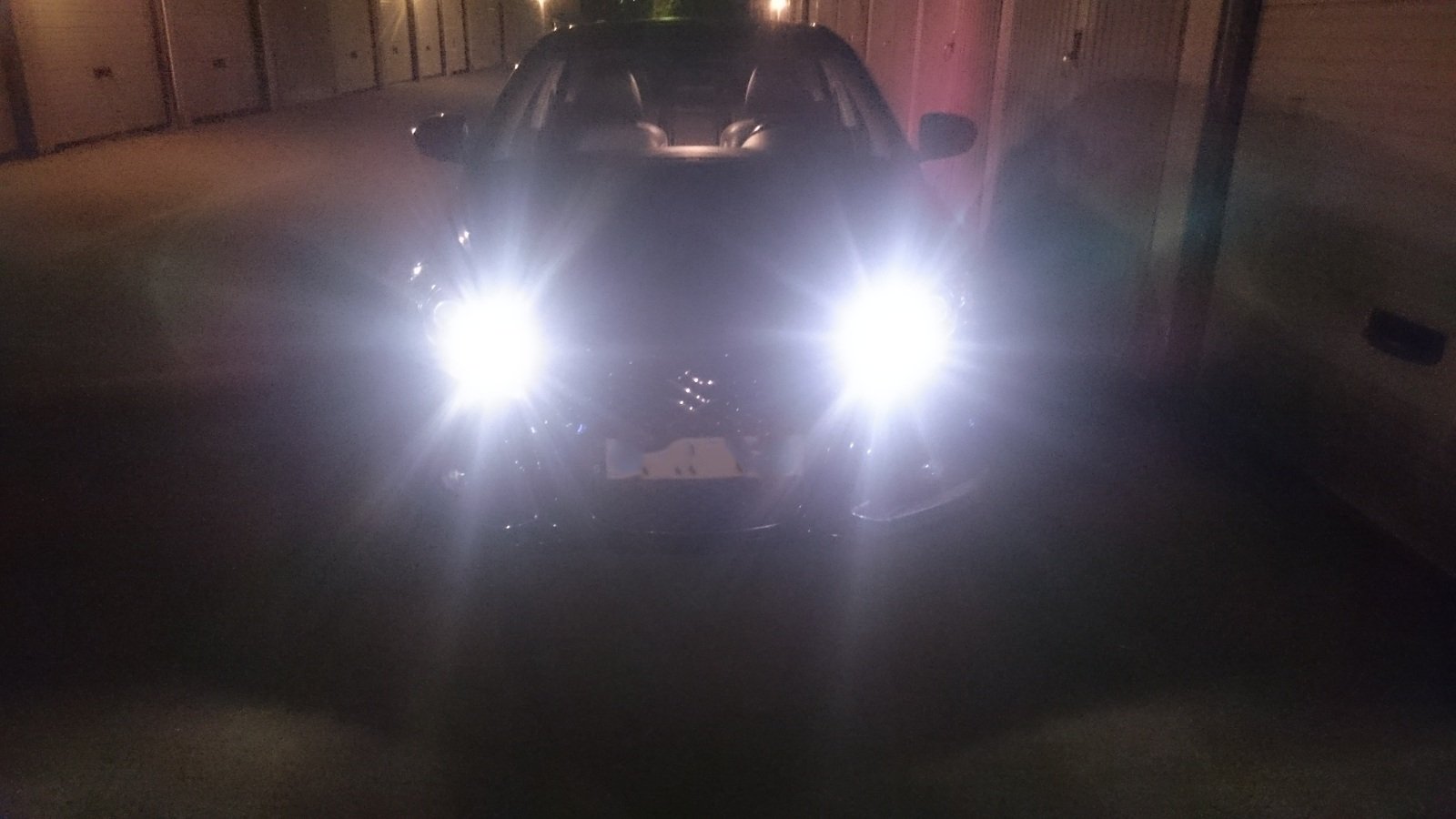

I don't know where I got "auto" from. The arm clearly reads off.
Bad lighting to take light pictures.
Took with the switch off, low beam is on.
Park and park/fog.
On setting gives the same as off.
You are correct, KuroNekko, switching ON, turns the lights on, regardless of ignition.
Can you go totally dark, no lights on?
If so, evidently it can be done. I'll do some more digging.

It's really hard to say given each market has different lighting settings, it seems. In the US and Canada, we have Daytime Running Lights (DRLs) that automatically come on when the engine is on and the hand brake is lowered. It's on unless the headlights are turned on. Basically, a front light bulb is always on. To defeat this, the modification is to bend a pin or two in the DRL module for the headlight wiring.
Australia seems to have a different set-up and from what I've seen in photos, actually different headlights. They can apparently run the fogs lights in addition to the high beams. You can't in the US. In fact, you can't even activate the fog lights without the low beams being on. Given you can do that in your Euro-spec model, it shows that you have different headlight wiring than others in other markets. If you have DRLs that use the high beam bulbs, disabling them may be similar to the technique for US and Canadian models. The write-up is below:
