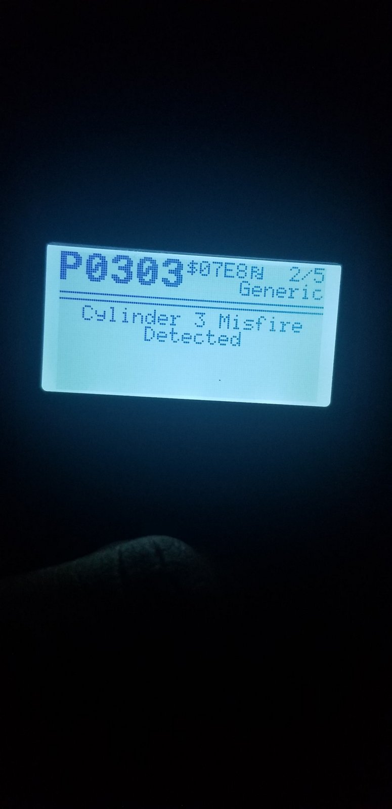

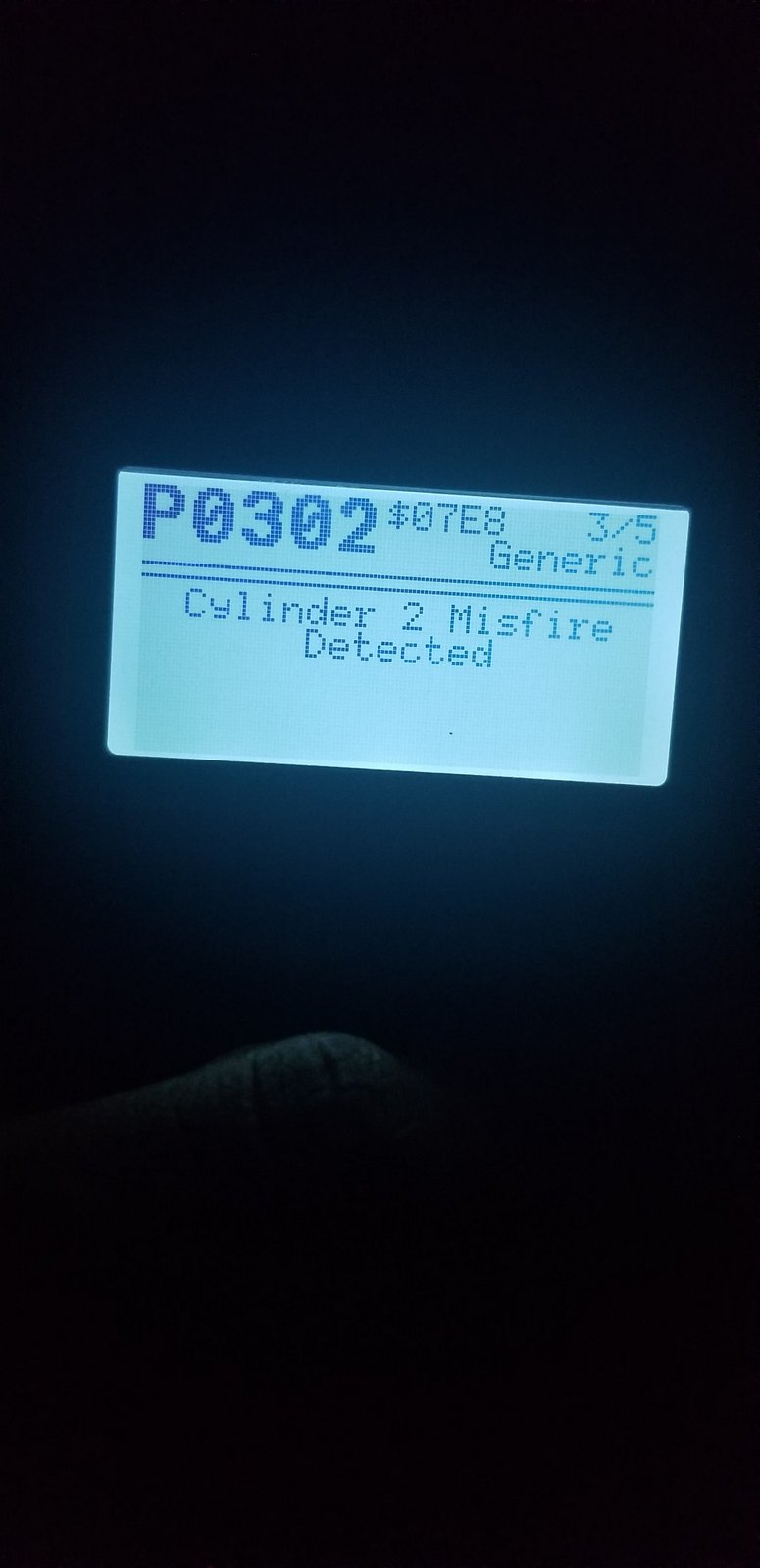

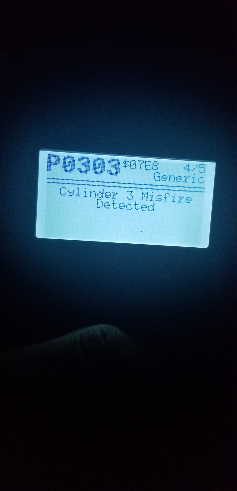

One day I drove the car for one hour and the check engine light came on while I was driving. I went home and checked the issue with an OBD2 reader and it showed that car's second cylinder was misfiring.
So, now what I did was swapped the ignition coil+spark plugs from second to third and from third to second. Now the OBD2 reader showed me that 3rd cylinder is misfiring and the 2nd cylinder was good.
I narrowed it down to two possibilities, either the spark plug or ignition coil has gone bad. But i recently changed my spark plugs around 2 months ago.
Now I changed the ignition coil between 3rd and 2nd cylinder (without changing the spark plugs and with 3rd cylinder misfiring and 2nd cylinder ok) to test if its the ignition coil that has gone bad. But, now I put the OBD2 reader in, it shows both 2 and 3 are misfiring.

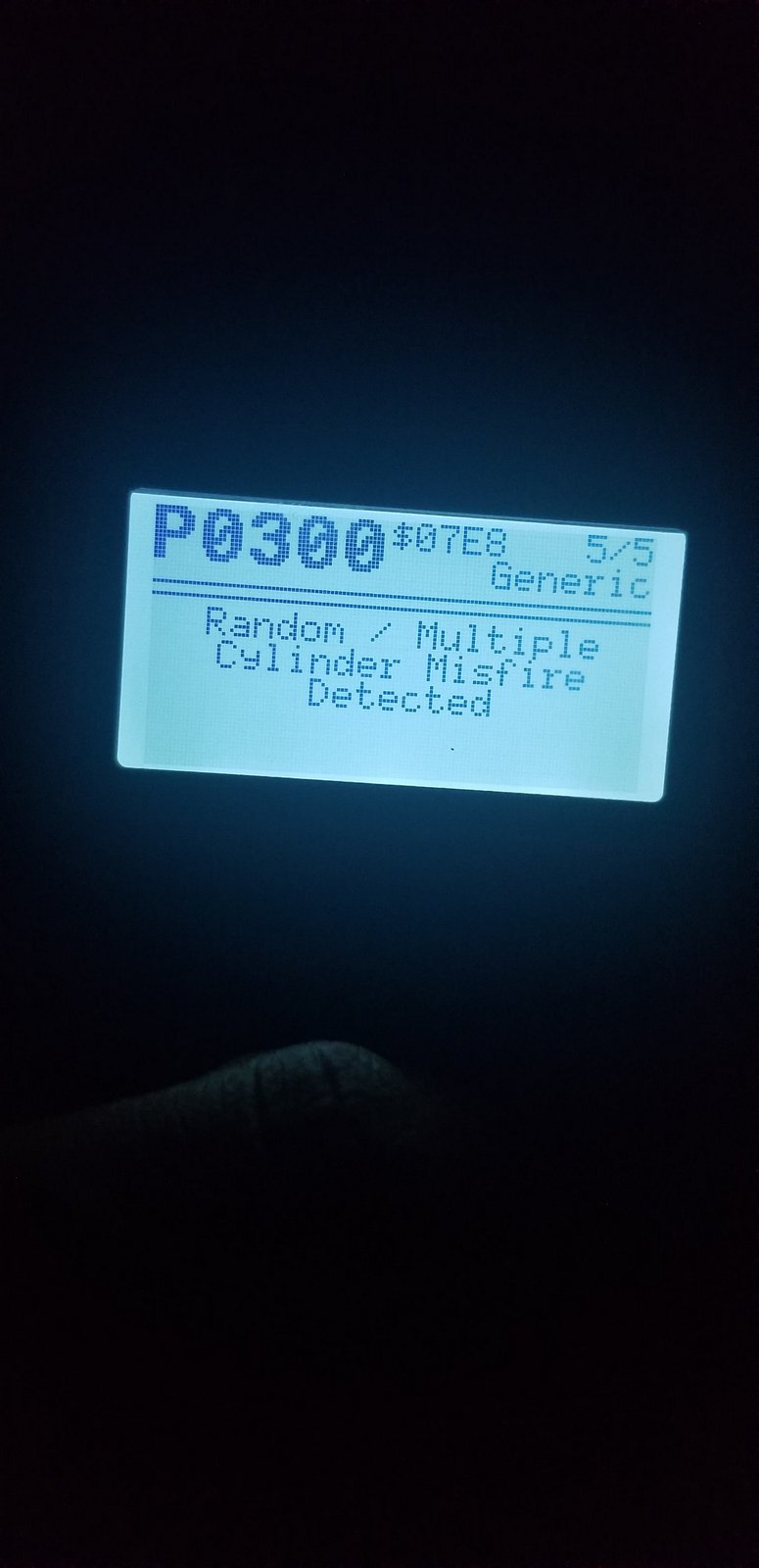

OBD2 Readers images are attached below

Your method of moving parts and rechecking code is good but if youd had moved coil to no.1 and plug to no.3 then you would probably have hit it in one shot . I would erase codes and reread them after a drive . The first code thrown will be the cylinder with the failed part. on misfire codes it is not uncommon to get a second bogus misfire code. On replacing all four coils, I wouldnt. A coil failure is rare on these cars . The quality of your replacement coil is unknown and I would rather take a chance on a used one for probably $20 at your local salvage yard . It is the same coils used in the sx4 making it a lot easier to find .If thats a no go , I can get you one for $25 shipped .

Without a doubt in my mind, it's a failed ignition coil. I've personally experienced this in my Kizashi last summer and did the same thing you did with one exception; I made sure to clear the error code (history too) prior to the coil swap. When the CEL came back on, it showed the misfire on the swapped coil cylinder because I properly cleared the code from the original coil cylinder. I used a Bluetooth OBDII adapter with the Torque Lite app. I like app-based OBDII readers given they are cheap, get updated, and reveal more data. For example, you can view and clear active and historical codes independently. Does your device do this too?

Okay, let me first start by saying don't worry about the spark plugs. They are very likely just fine. Don't worry about swapping, replacing, or trying to figure out which one is "bad" among the spark plugs. Your problem is the ignition coil, not the plugs. As for the coil, you only swapped them between two cylinders so try to recall how you swapped them and where the original bad one currently sits. For now, forget all the error codes since and only focus on the first one and where that coil is now. That's the one you need to replace. If you absolutely can't recall, (though it's a 50/50 chance, it seems) then disconnect the car battery at the negative terminal for several minutes. Reconnect and idle the engine. A failed coil will be obvious as the engine will idle very roughly as one of the cylinders likely won't function properly. Then read the code for the current error code, assuming historic codes also don't display.SSHREST4 wrote:KuroNekko wrote:Without a doubt in my mind, it's a failed ignition coil. I've personally experienced this in my Kizashi last summer and did the same thing you did with one exception; I made sure to clear the error code (history too) prior to the coil swap. When the CEL came back on, it showed the misfire on the swapped coil cylinder because I properly cleared the code from the original coil cylinder. I used a Bluetooth OBDII adapter with the Torque Lite app. I like app-based OBDII readers given they are cheap, get updated, and reveal more data. For example, you can view and clear active and historical codes independently. Does your device do this too?
