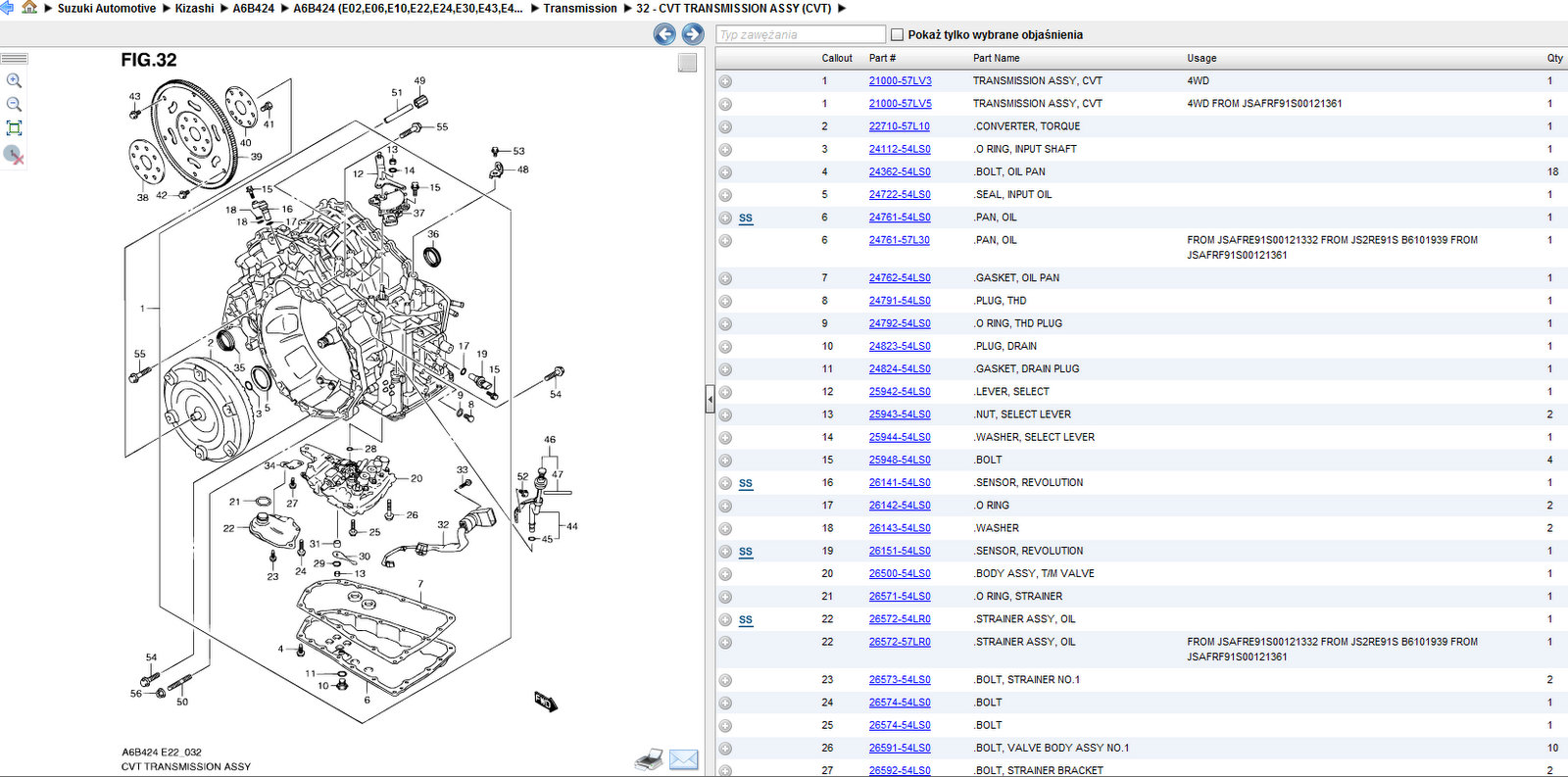

Is this FILTER FOR COOLER RETURN filter visible in this diagram? I need to know the part number:

I dont think its in the picture or at least i cant see it. It can be purchased at Autozone . Part number is TF246
It won't be found in any Suzuki Kizashi or SX4 CVT parts diagram. bdleonard did the reverse investigating some time ago and found it and the cover's o-ring in a Mitsubishi diagram of the same model CVT. Info is contained in one of his posts.
