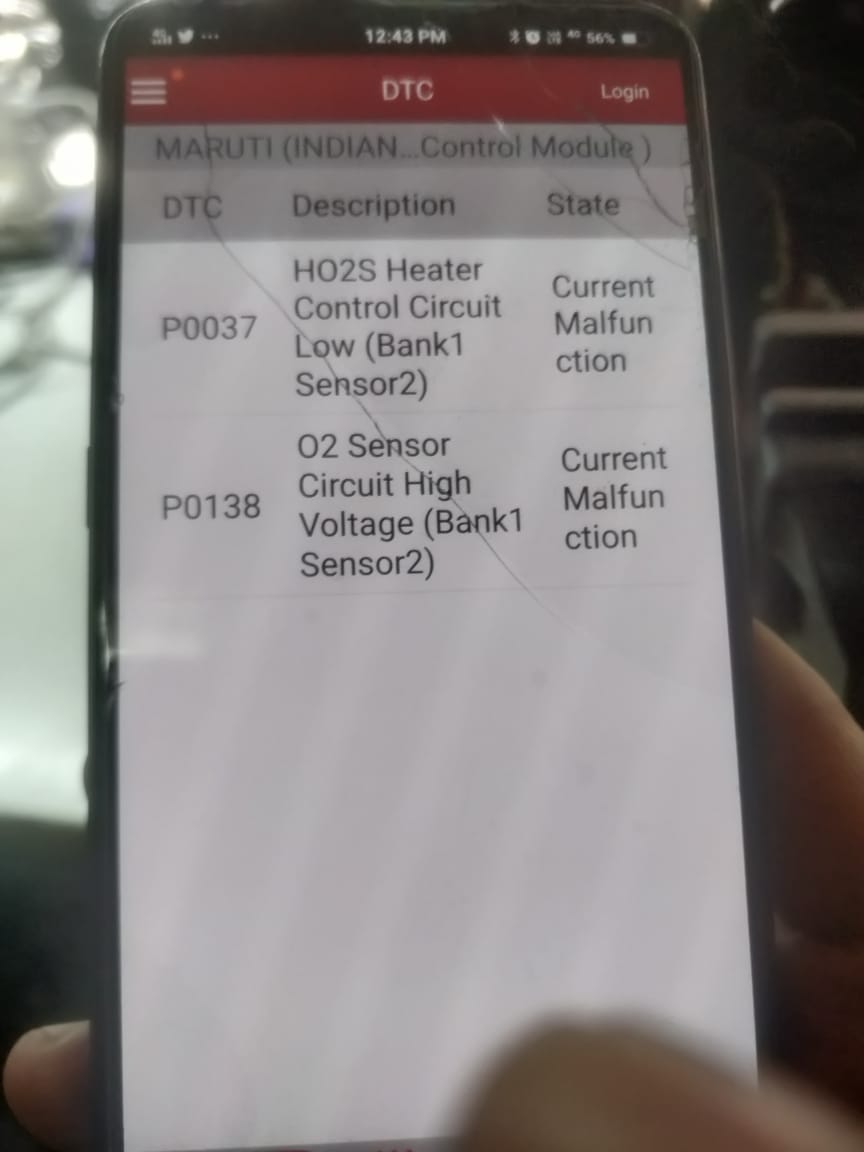

Oh my, yes my car has a bad O2 sensor and a check engine light, so that's why it isn't working! Thanks alot!
Also do you happen to know anything about these codes?
Posts: 803
change down stream sensor

Down stream sensor? I'm sorry I don't know what that is. Can you tell me the part number?
Posts: 803
The downstream o2 sensor is oem number 1821357L00 it carries a hefty price at the dealer. You can get a high quality Denso brand with part number 234-4303 for $98.50 on ebay.
Posts: 5279
The "downstream sensor" is the oxygen sensor found behind/after the catalytic converter. The "upstream sensor" is the oxygen sensor found in front/before it (on the exhaust manifold coming out of the engine). The downstream sensor monitors the efficacy of the catalytic converter.
