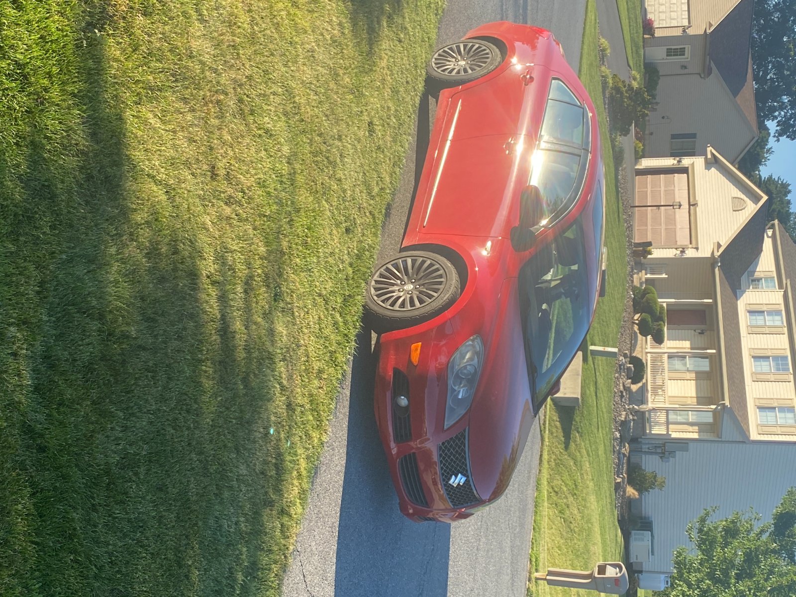

Attached is a pic of my car, if anyone cares :D
