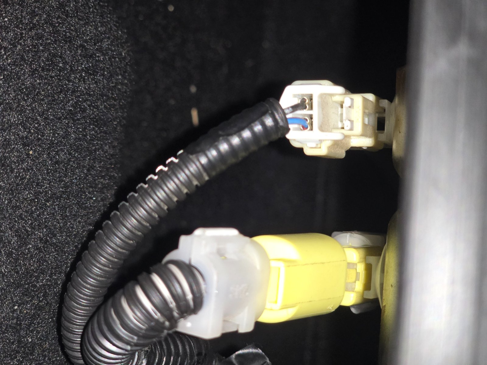

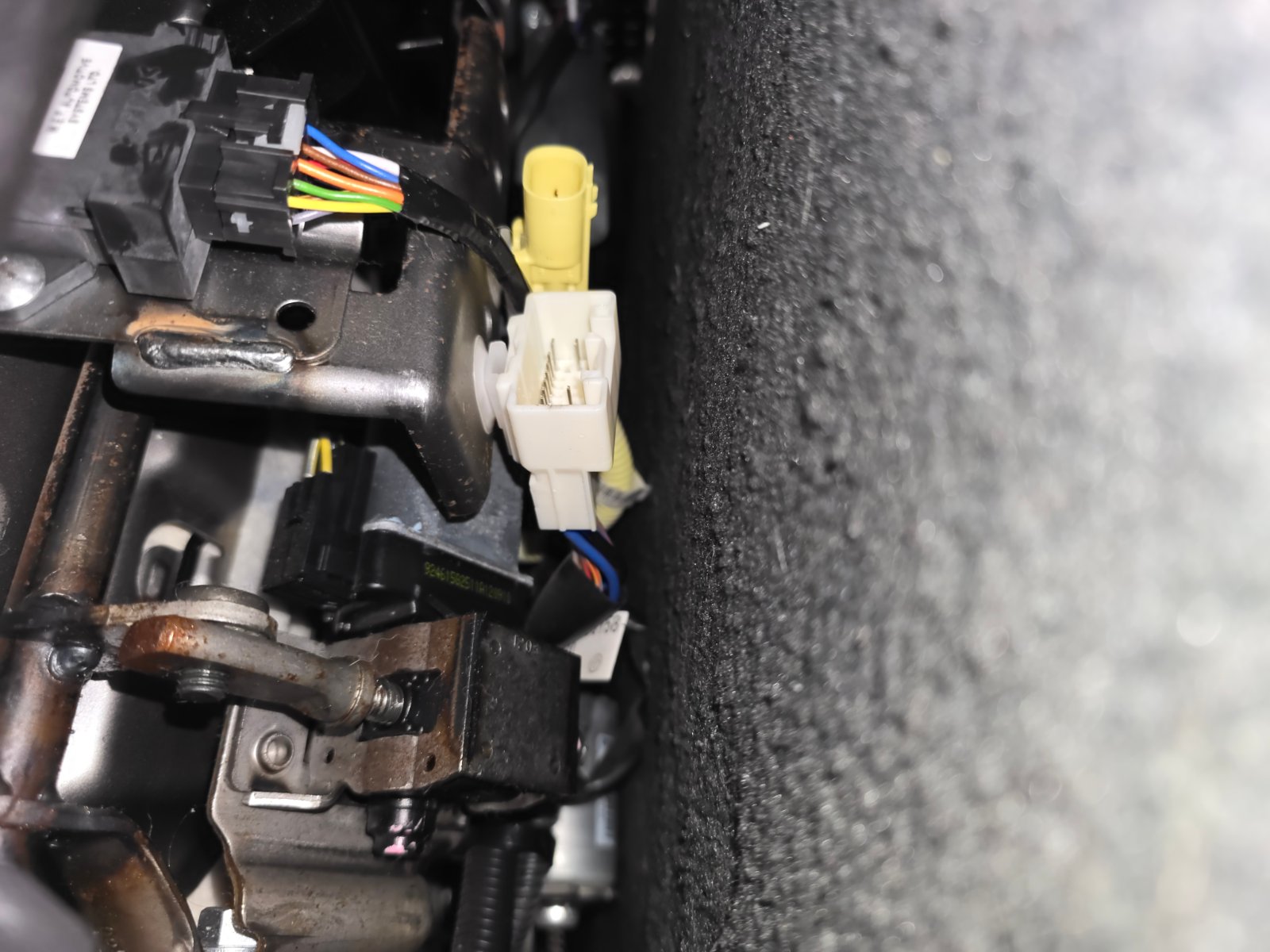

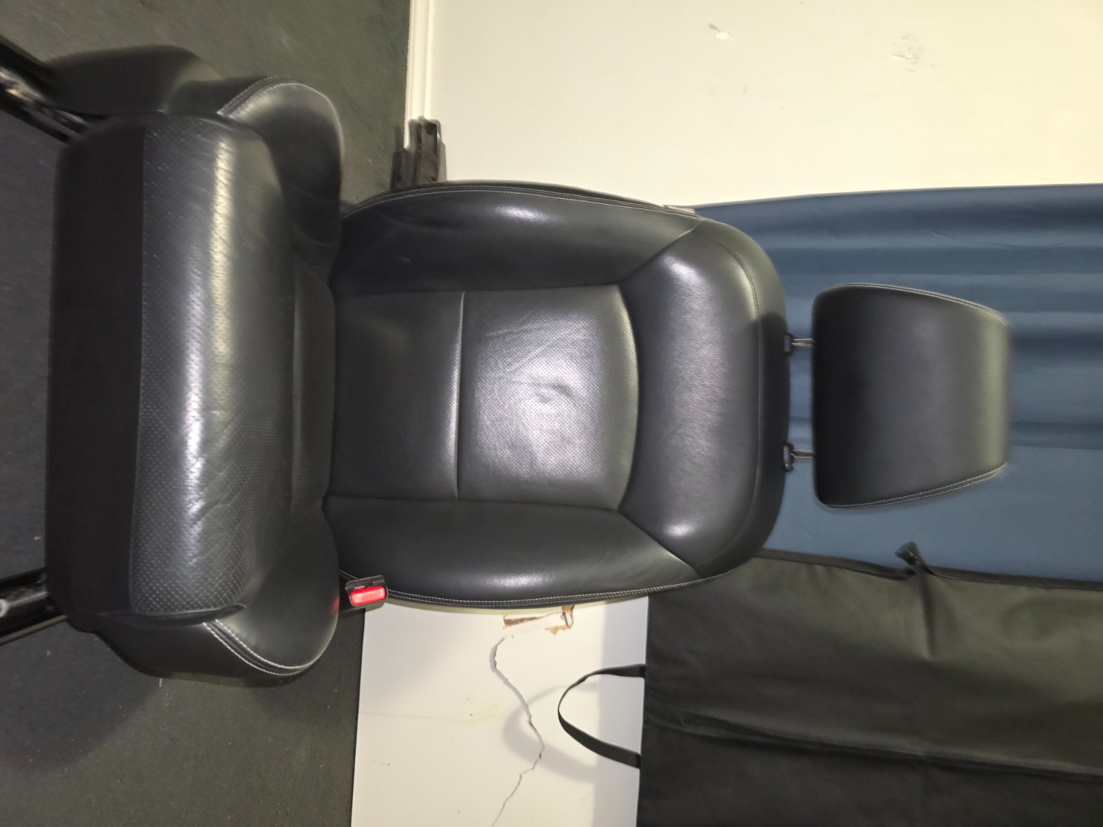

So I'm wanting to install heated leather seats in my 2012 Base model 6sp kizashi, but I dont have the correct wiring harness. My question is am I able to connect an adapter? The fuses necessary are in the car, I have checked, it's just the colourful wires coming out of underneath the seat. I'm thinking of taking it to a sparky (electrician) to have one possibly installed if possible.
Here is just the drivers seat. The condition is pretty immaculate for a car that had 144k kilometres (90k miles) on it.
These are the wires. The first one is my current one for the cloth seats I have, and the second one is the upgraded seats
First
Second

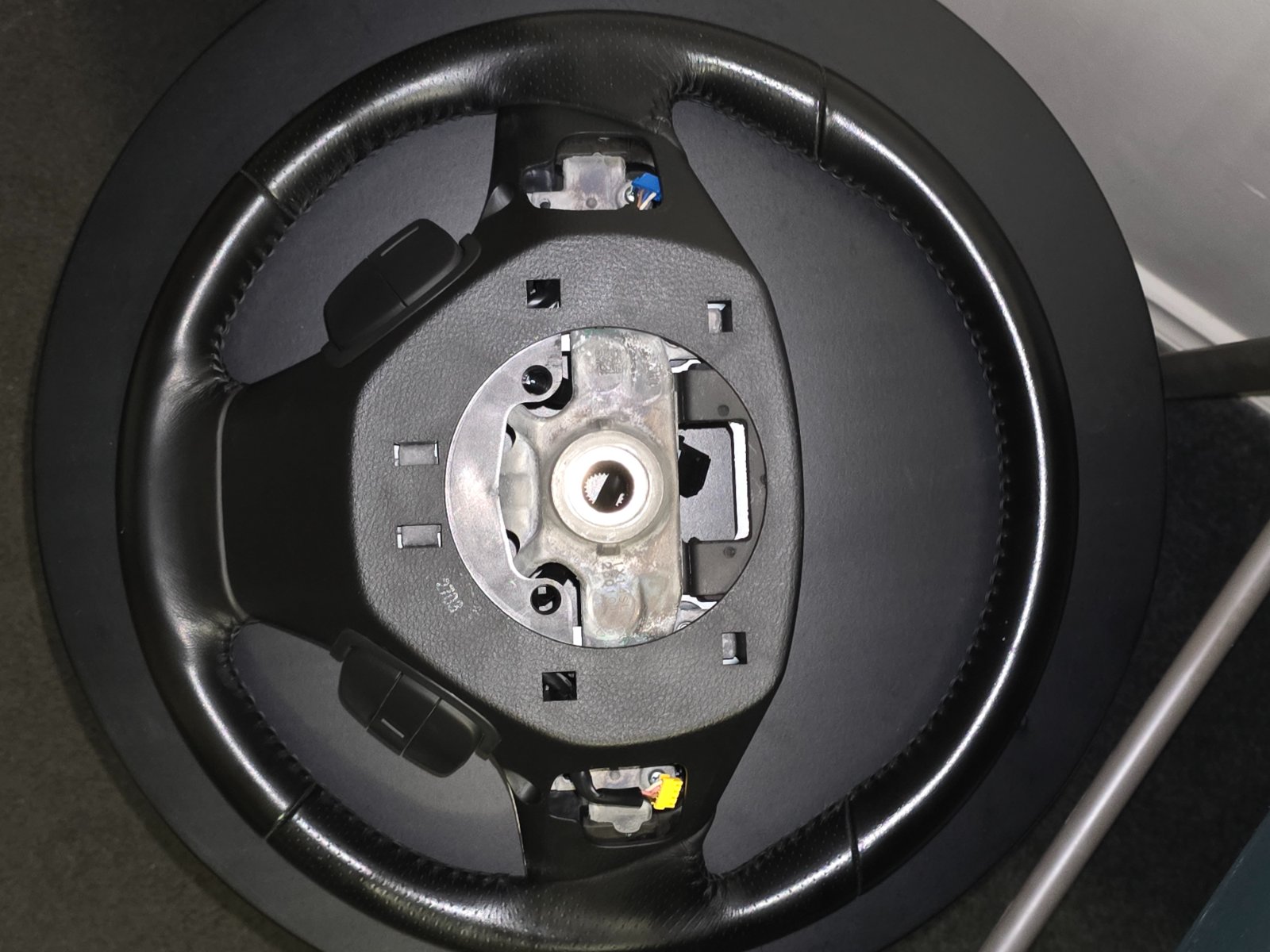

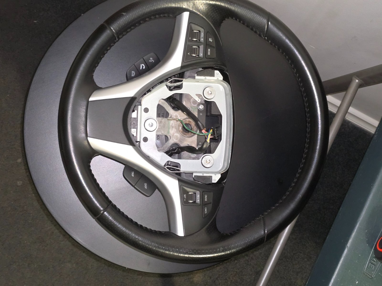

Another question of mine is that with the SLS steering wheel I also grabbed, it came with paddle shifters in which I removed.
If I change out the back plastic with my current steering wheel which doesn't have the holes, are the loose wires fine? Also should there be any issues with the automatic steering wheel swap to a manual?
Steering wheel I bought:

from your first picture, your car does not have the required wiring and connector to plug the heated seat and power seat that 2-pin connector is only for the seat belt switch. As you can see in your second picture white connector is different this connector(20-pin connector) contains signals and power for the heated seat and power seat + seatbelt switch.
most of these signals are for heated seat functionality but power seats also need some signals from BCM and also the Parking position of in CVT model + power and ground of course!

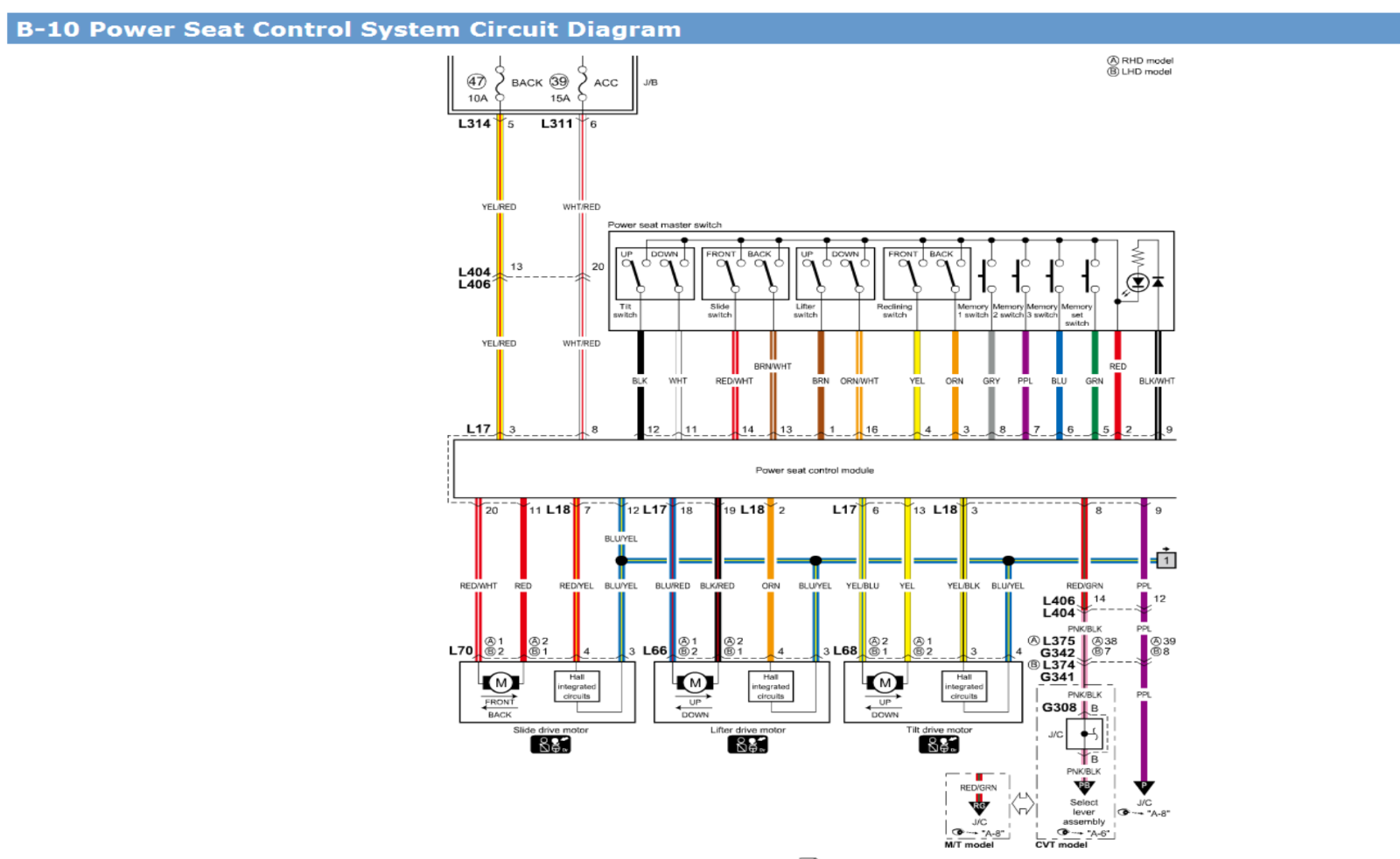

BTW white connector is L404 and for ref, I attached the wiring diagram I hope it helps

and for your second question, you can leave the connector for the paddle shifter unconnected without any problem.
