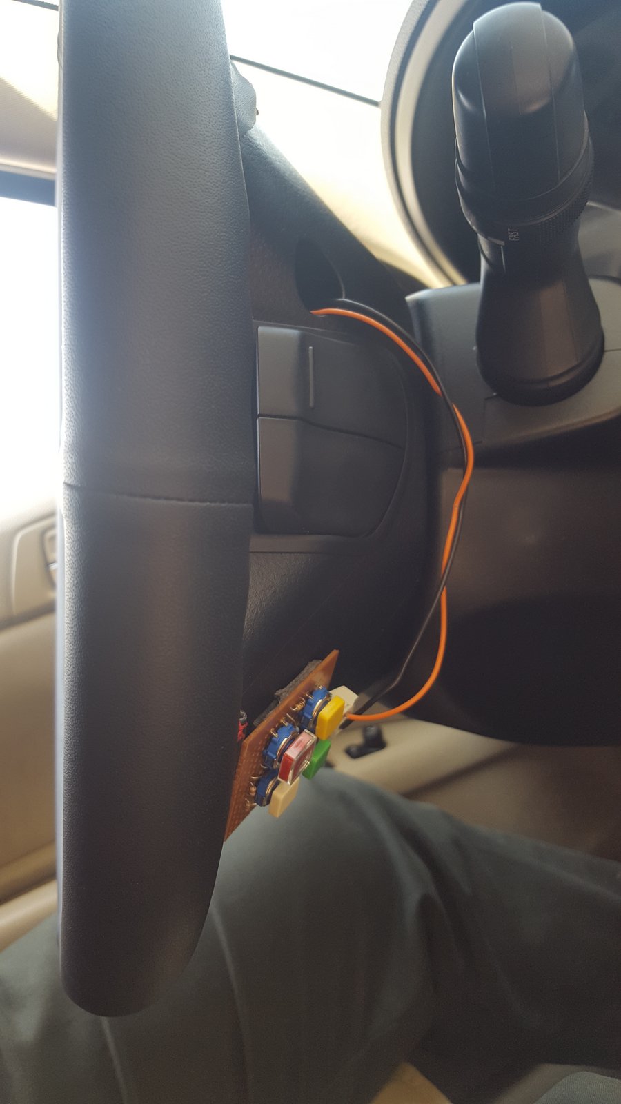

After reading Kizashi service manual I noticed that all the functionality needed for Cruise control is done by ECM module and there is no need for aftermarket module.Cruse control only need 4 Buttons to do the task.
So I open wheel airbag and bring 2 wires from steering wheel control connector and build 4 push button board to use as a steering wheel cruise control.
And that is I have activated cruise control for my kizashi and test it on the road with no problem at all.
and finally some pictures about it.

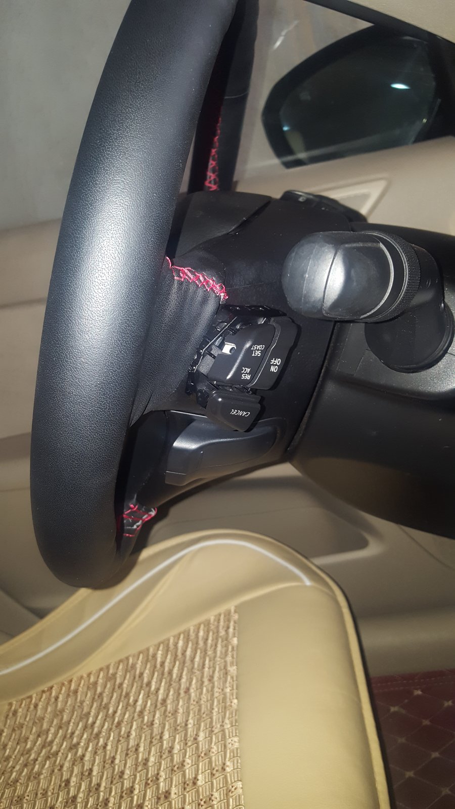

If I find one I will do that.I bought Suzuki vitara cruise control switch and do some modification on switch pcb to work with kizashi wiring protocol and it worked.redmed wrote:Get a steering wheel from another Kizashi. Get a steering wheel with the cruise buttons and it will work. It did for me.
- 20170924_143417 (1).jpg (206.22 KiB) Viewed 25661 times
