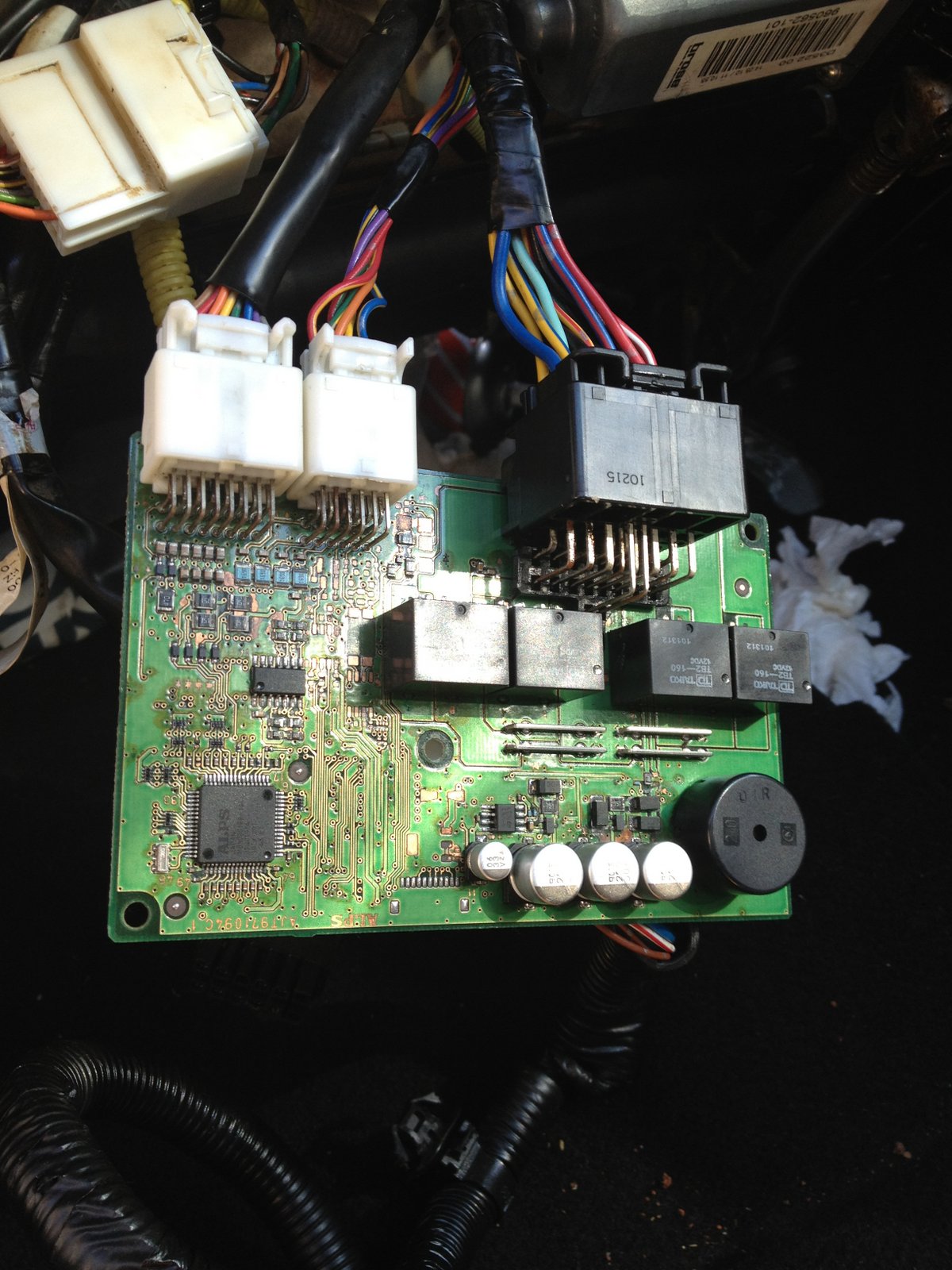

the kizashi xls come with driver power seat with three memory setting the control module for the power seat under the driver seat where can i find this part even the the dealer have no idea want to sell me the whole seat tray for more than 5 grands while the module could be changed easily as i tested the motors all working but the module give half the voltage only about 5 volts it should give 12 volts to run the motors any one have an idea where to find this parts i can post pictures too?

I'd call ASMC (Suzuki Corporate in Brea Calif.) and get them involved. Start w/ this number: 1-800-356-6013. Be polite, explain what you've found, the lack of assistance from the dealer and I'm sure they'll work w/ you, and your dealer, to get it sorted out. I had to get them involved w/ my amp replacement. Once they got involved it was taken care of promptly. If you find out what the p/n (or exact problem) is for this, please let us know for future reference.
Good Luck!

thanks for your response mate, i live in perth australia. and the dealer here really have no idea because other car dealer look after the parts section of the susuki cars, i'm pretty sure is to replce the module will solve my problem but no one want to sell it individually, the attachment with this post have the picture of the seat parts the module no is 11

abohany69 wrote:
Doc1.docx
But surely this will be a warranty issue if you are having problems?
The Kizashi comes with a 3 year/100K warranty in Australia and at the most your Kizashi can only be a year and a half old.
There are four Suzuki dealers in Perth, which ones have you tried?
