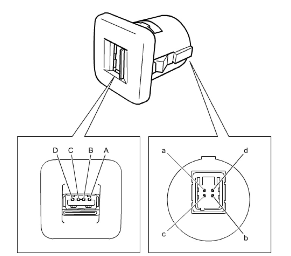

Here is the pin layout for the proprietary socket
usb copy.jpg (90.67 KiB) Viewed 13879 times
Interesting, it's got the same plug on the back of it. I didn't examine mine closely when it popped through the console as it's really hard to access.
