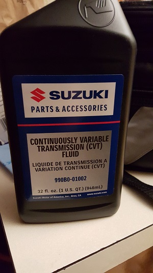

Hey guys I'm getting ready to do a CVT drain+fill i'm a little past the first one (45,000 miles) and I was just curious is this the correct fluid? I picked it up from an old suzuki dealer near Erie PA and they said this is what they've always carried. Reason I ask is because the manual states Suzuki CVT green fluid 1 or something like that maybe not in that order. Is the green referring to the color of the fluid because I noticed it has a tiny tint of green/yellow.
That's the right stuff.
