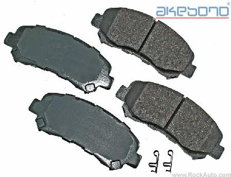

The Kiz's brakes are manufactured by Akebono (sp?). I have seen them at one of the chain stores (Autozone, Pep Boys, Advanced Auto) I forget which one I stumbled across that had them. Call around and ask for them by name.....somebody has them.

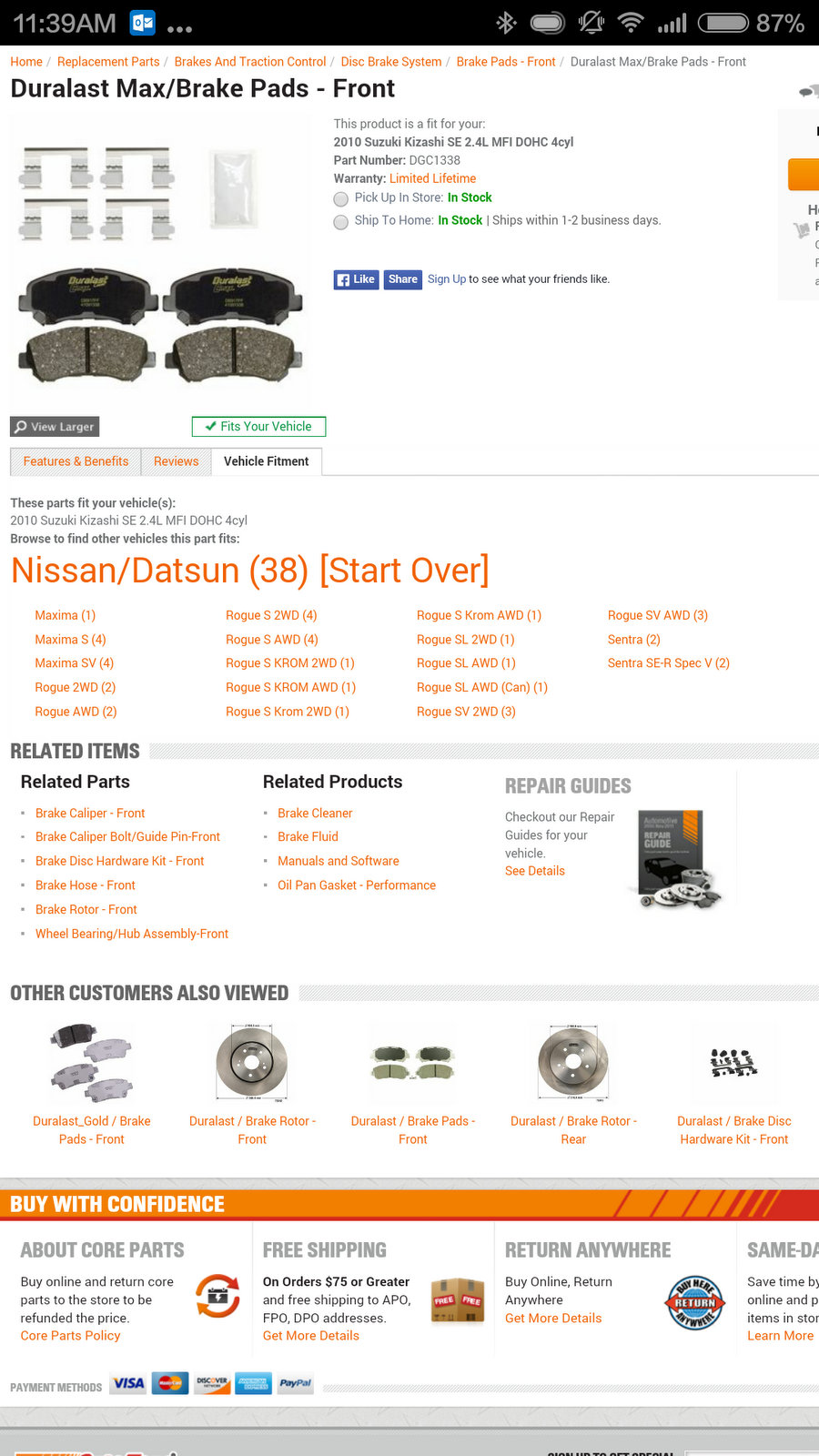

That's way too much for Akebono brake pads, they should cost about $60. You can save money by installing the pads yourself. I cross referenced the pads from other manufacturers and the Kizashi's front brakes are similar to the Nissan Maxima, Rouge, and Sentra. Akebono makes the ACT1338 for the Nissans which might fit our Kizashi.

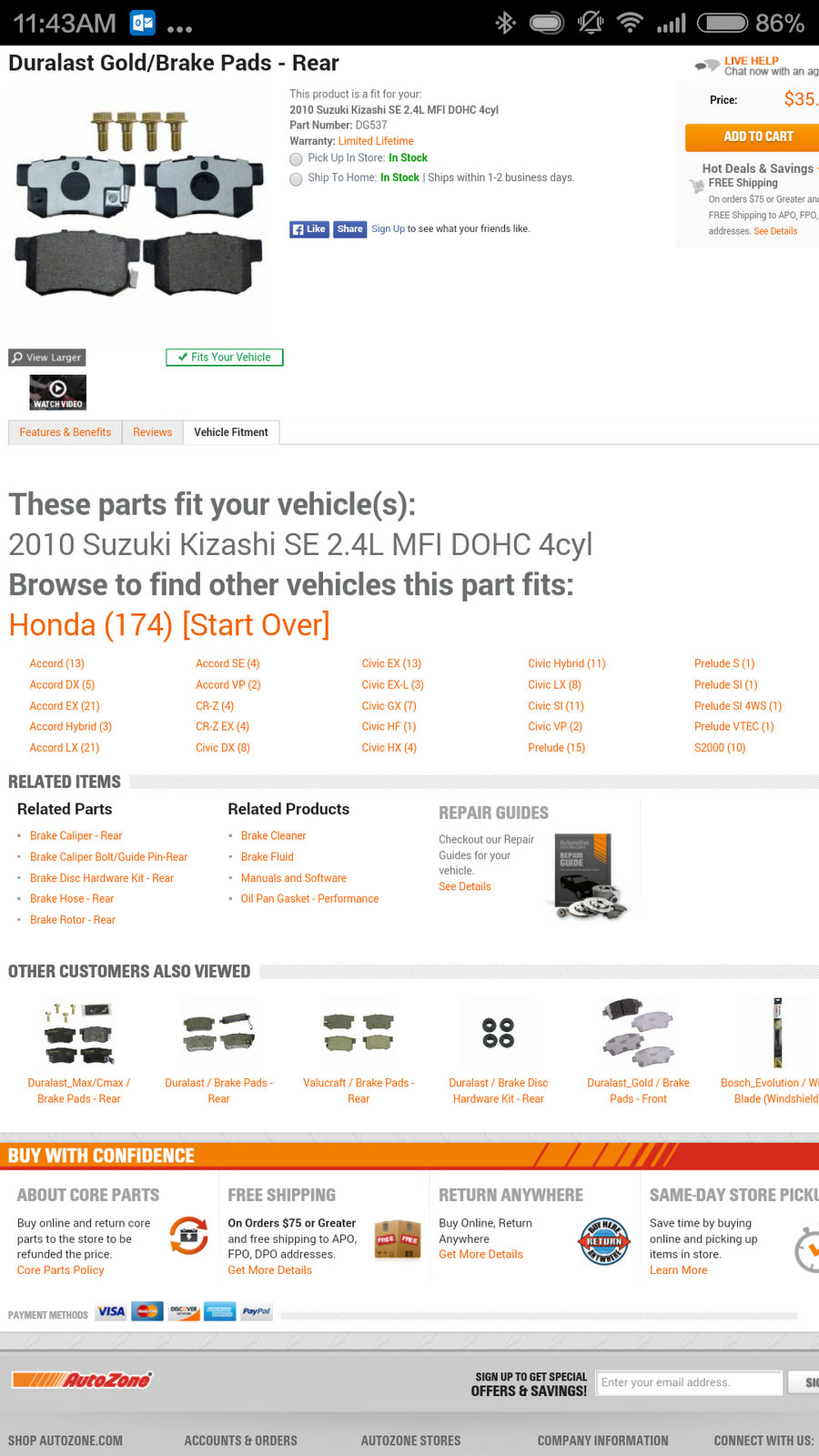

Triggerhappy wrote:That's way too much for Akebono brake pads, they should cost about $60. You can save money by installing the pads yourself. I cross referenced the pads from other manufacturers and the Kizashi's front brakes are similar to the Nissan Maxima, Rouge, and Sentra. Akebono makes the ACT1338 for the Nissans which might fit our Kizashi.
yes. nissan's maxima front brake pad will fit. i just replace mine with 2010 maxima front pad. the rear pad i picked up at honda dealer was 2000 civic si. they all the same.
