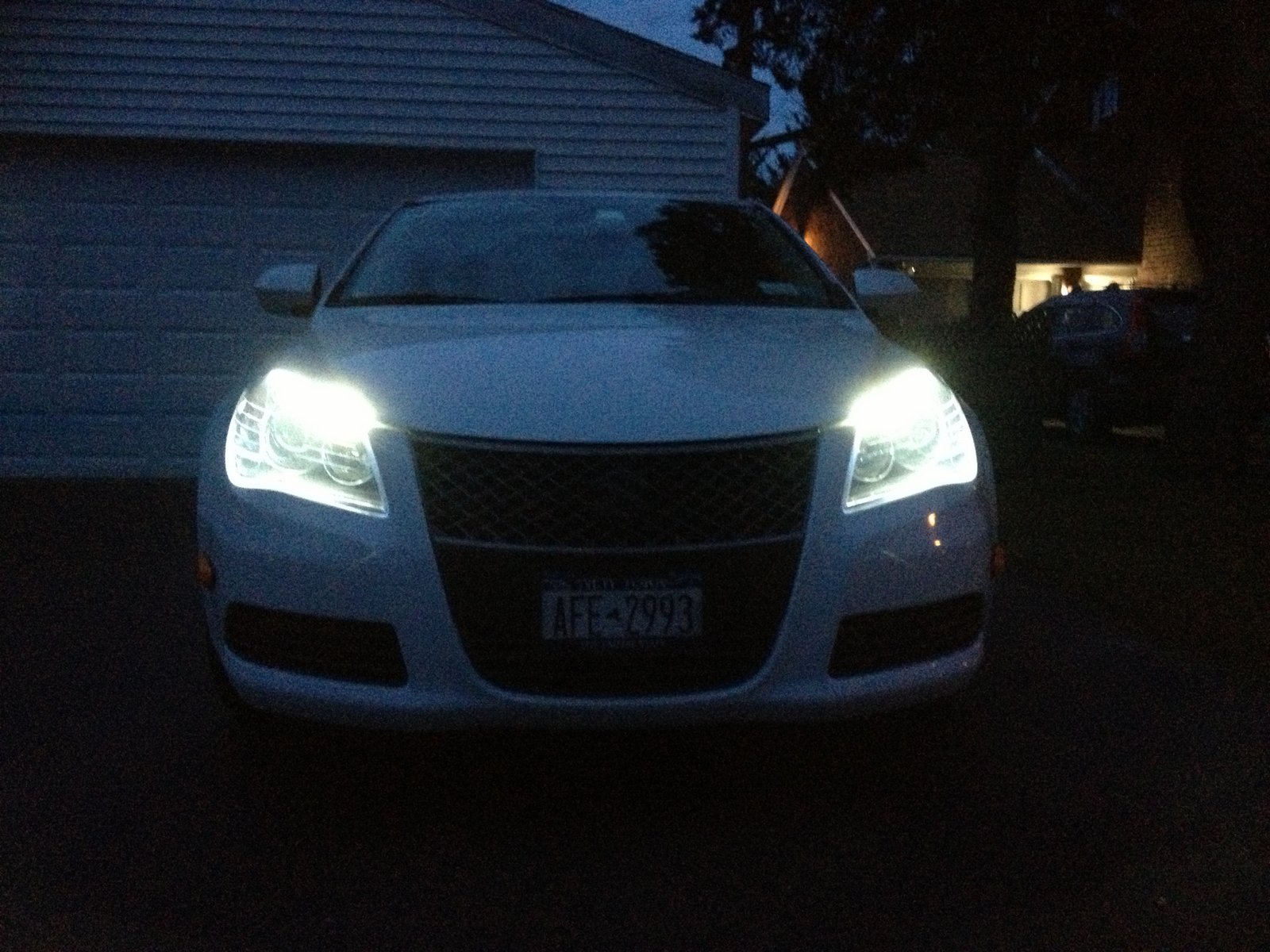

The Led Strip on top of Headlights
Chris6748h
Posts: 32
Another
11zukizashi
Posts: 282
but they would never be on by themselves like that when you are driving unless you turned off the drls somehow
Chris6748h
Posts: 32
Yes they are on by themselves I disabled the stick drl. And have those on as the drl.
11zukizashi
Posts: 282
how did you disable the stock drl??
Chris6748h
Posts: 32
There is a plug inside cabin down below to the right, there is a diagram in the DIY section. You do lose your high beams though. Drl is just high beam at lower voltage. Not a big deal to me as I never use them anyway
