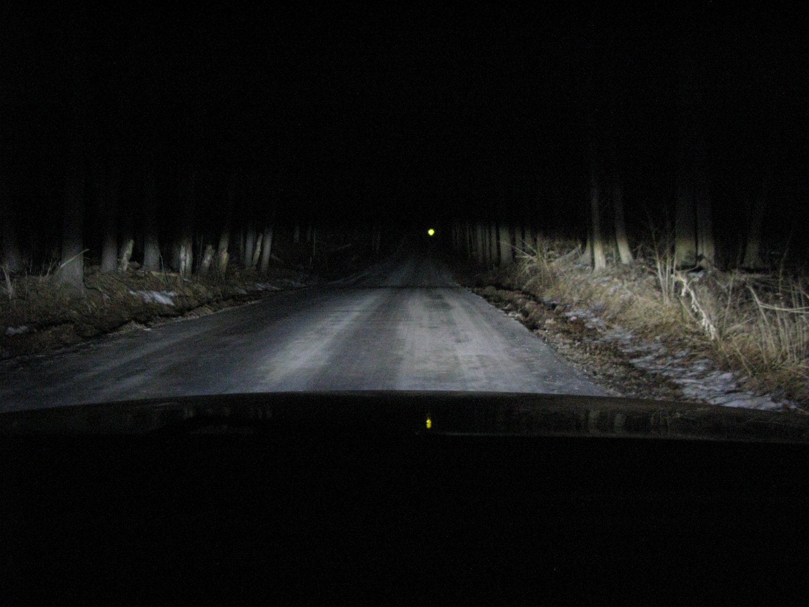

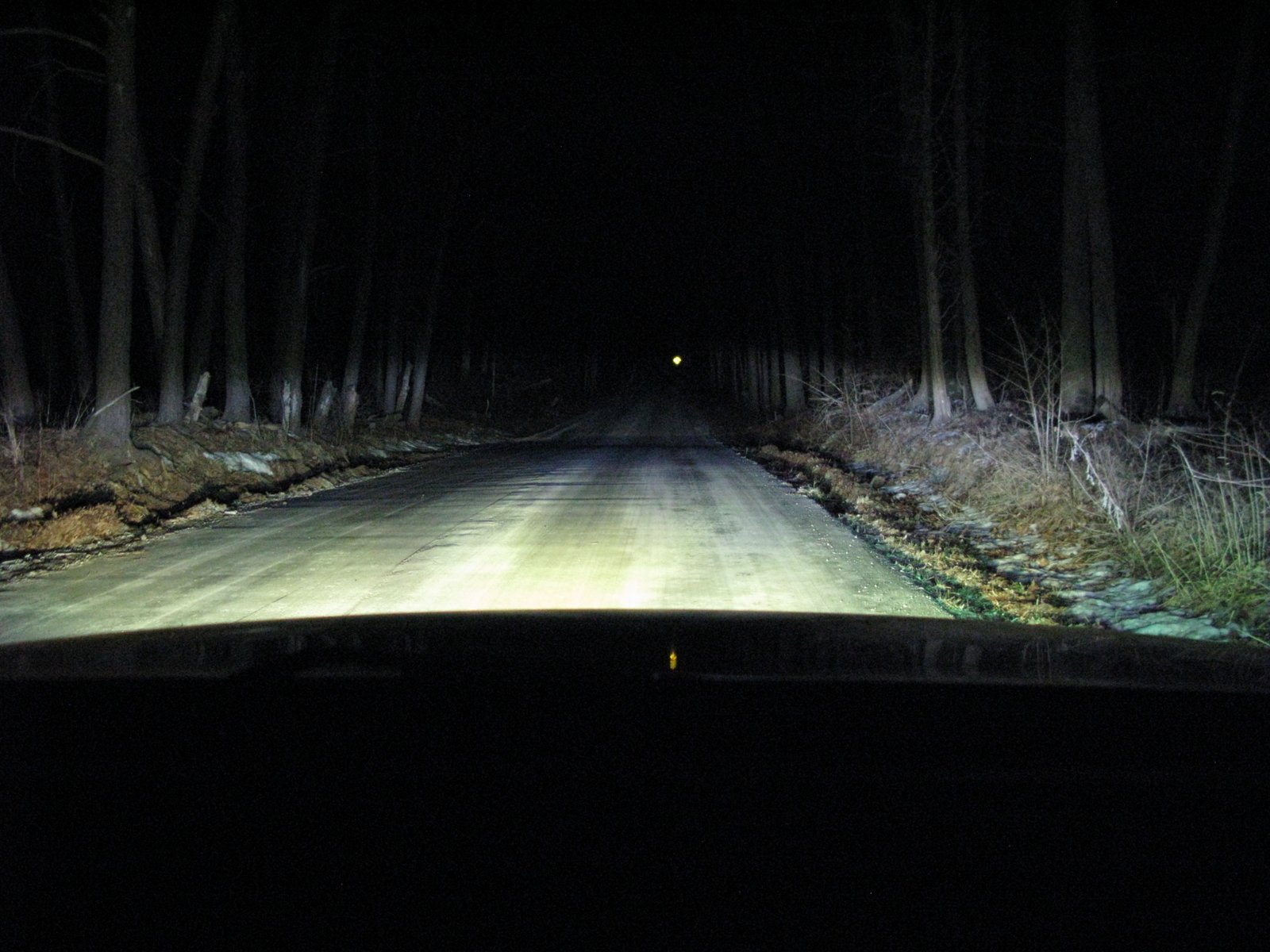

Honestly, my current HID fogs bulbs are not good. Like the wrote, the RH side barely puts usable light on the road. The LH is rather good though. My plan is to replace the bulbs with Morimoto 3Fives pretty soon.
Here's how they currently look on the road:
Fog lights OFF
Fog lights ON
I'm actually impressed with the LHS output! What's going on with the RHS though :lol:
Any issues with glare from the fogs with HIDs?

You mean to other drivers? I don't use them too much and mainly on rainy days or very low light conditions. I've never been flashed or yelled at for brightness/glare issues.
That being said, I'm looking to replace these bulbs with better HID bulbs that should offer a more golden color output and be brighter. The main reason being how poorly the RHS bulb currently outputs.
