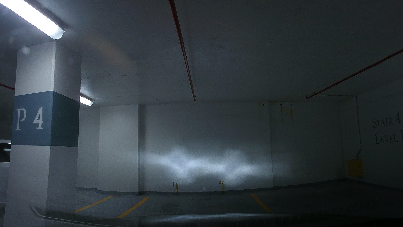

Here are some photos from my dash camera.
Below is a close-up. DRLs only. The wall is about 5 feet away.

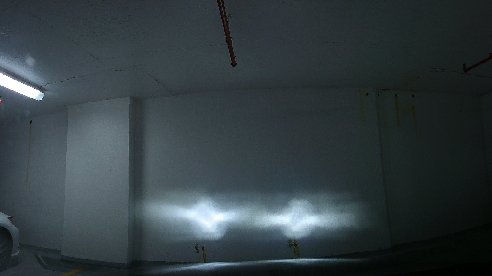

Below is further away. DRLs only. You can see the circular pattern I'm talking about.

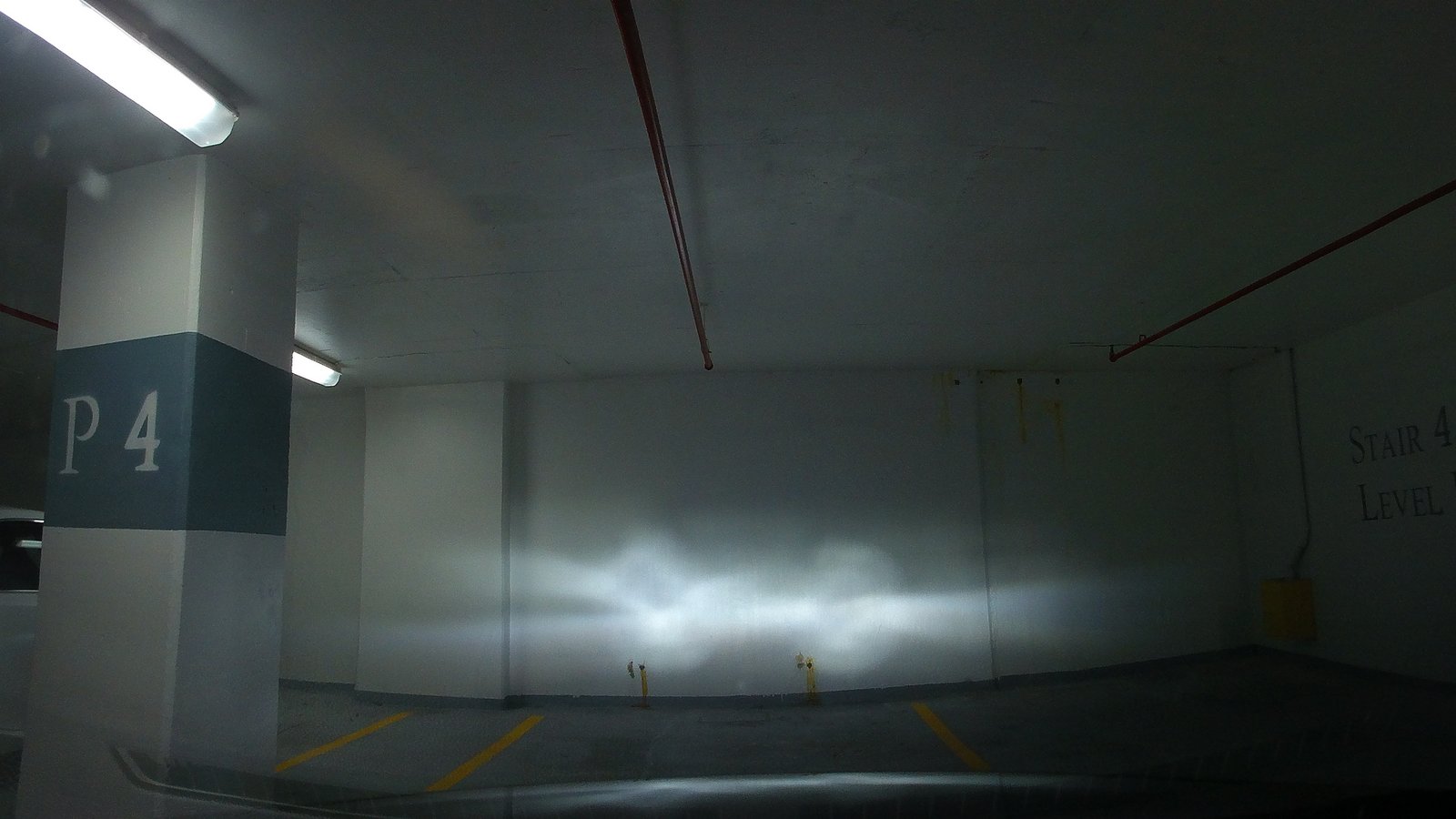

Below is the high beam with the low beam HID.
While it may not look like it in the photos, the high beam output is brighter than the DRL output. The circular pattern is not ideal, but it's not entirely useless either. The sides also have "wings" which help to illuminate the road better. It's quite possible that the pattern can be improved with better bulb adjustment.
