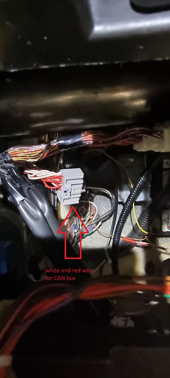

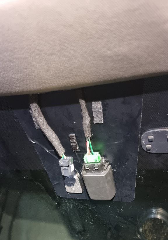

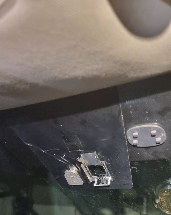

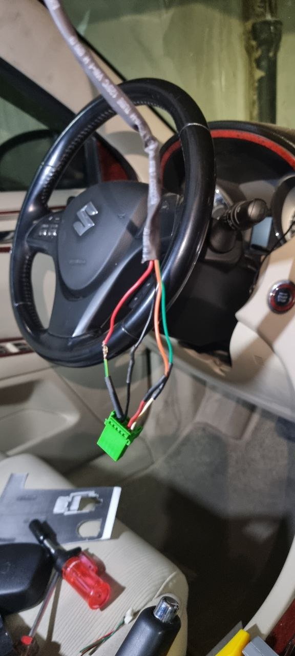

it's been 3 years since I installed the OE rain and light sensor in my car so far I love it. time to make some improvements to the system

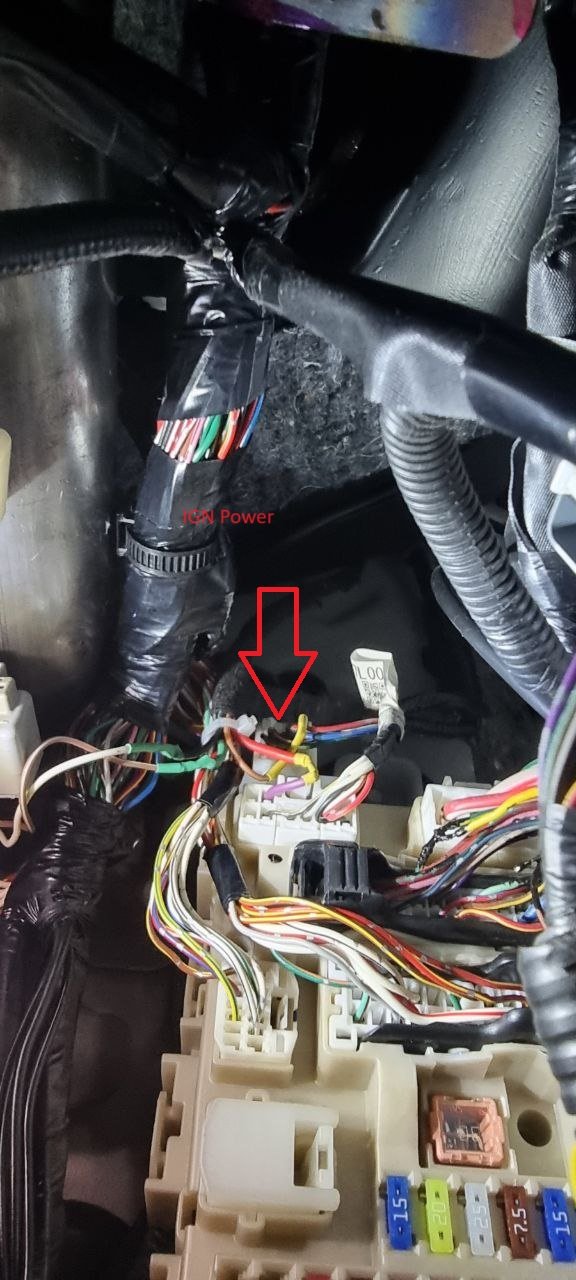

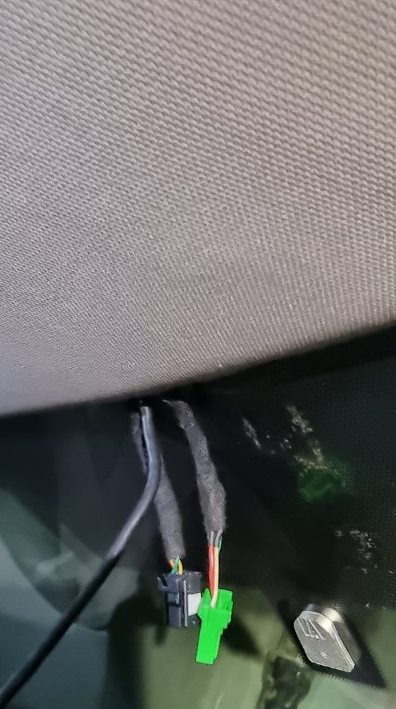

1- new wiring for light sensor like OE from the fuse panel under the steering wheel

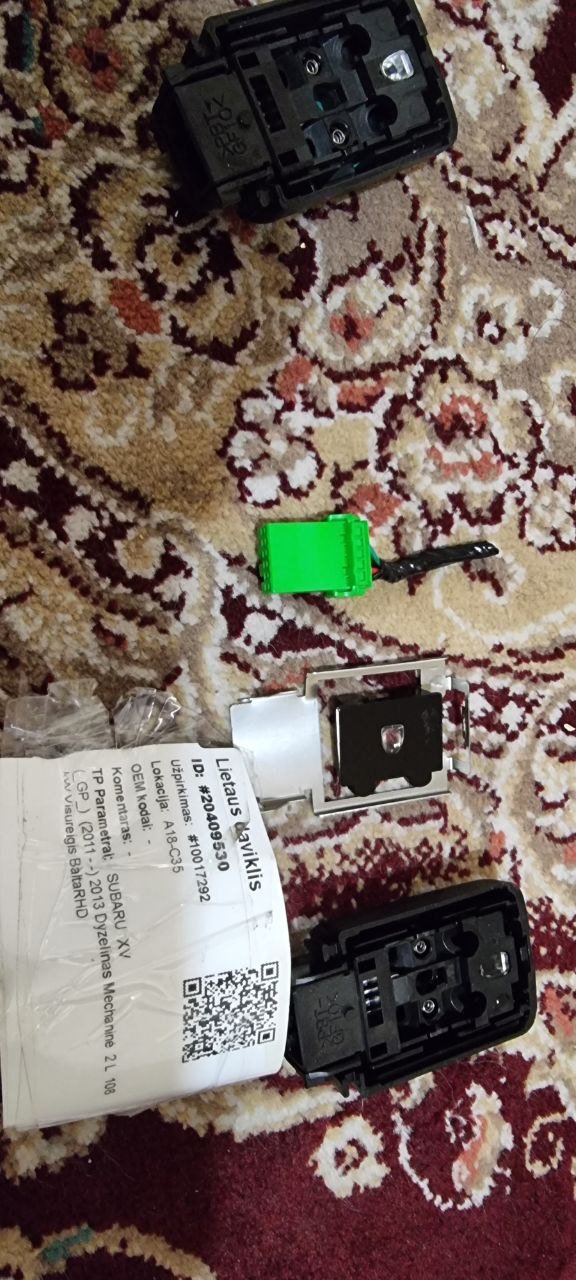

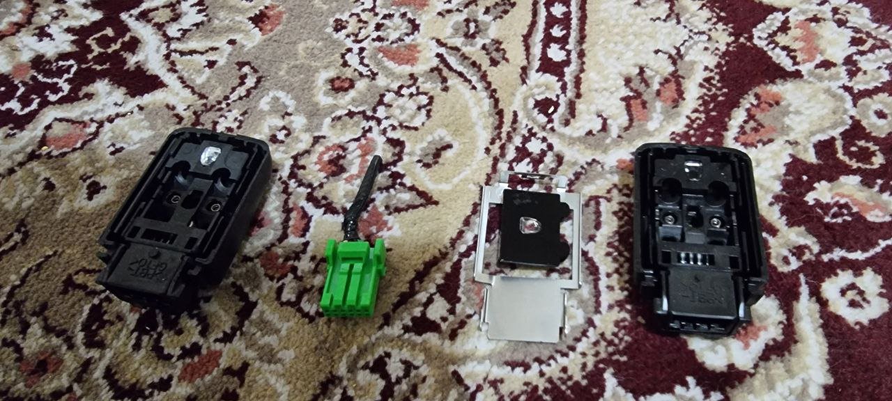

2- buy OE socket and also holder bracket on glass: I managed to buy a rain sensor for Subaru XV rain and a light sensor. this unit mechanically is the same on Kizashi even the wiring colors are the same.

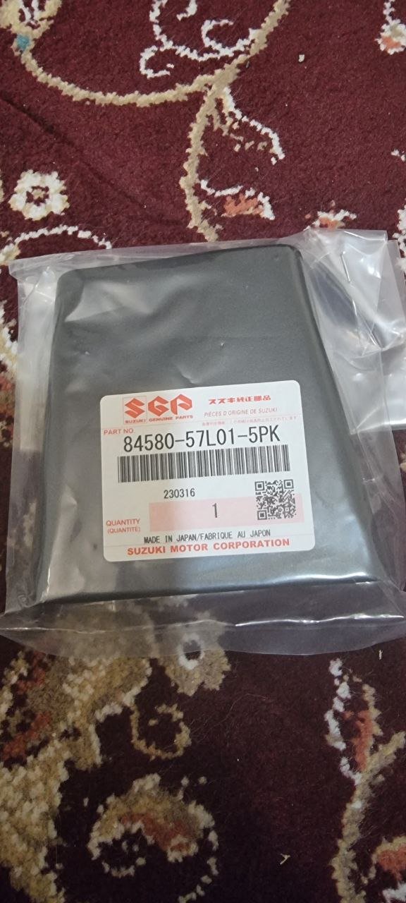

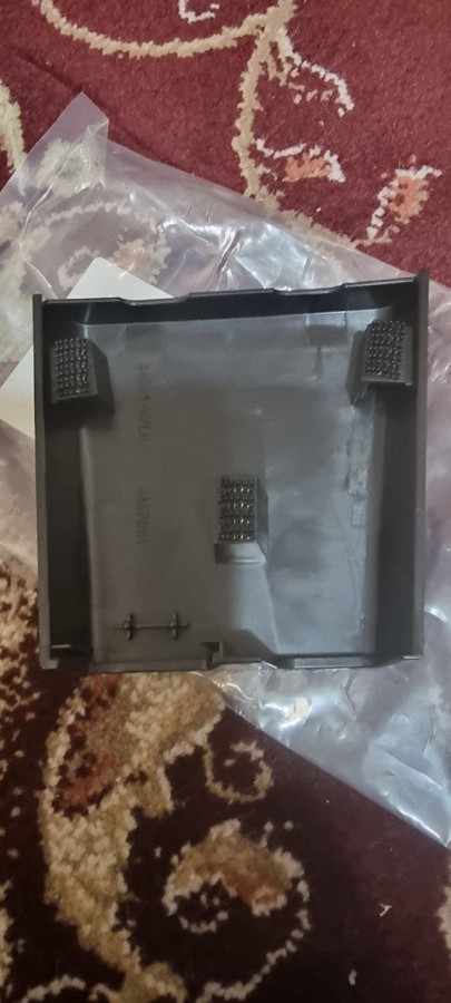

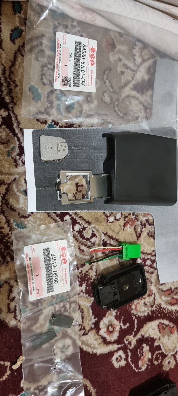

3- some OE parts from megazip including:
- silicon pad: 37324-57L00-000 SHEET, Suzuki
- wiring cover: 84580-57L01-5PK COVER, WIRE HARNESS (BLACK), Suzuki
- velcro fastener of cover : 84513-76F00-000 MALE,GLASS FASTENER NO.2
- and also the sensor itself which I bought back in 2019: 37320-57L01-000 Sensor Assy,rain&amp

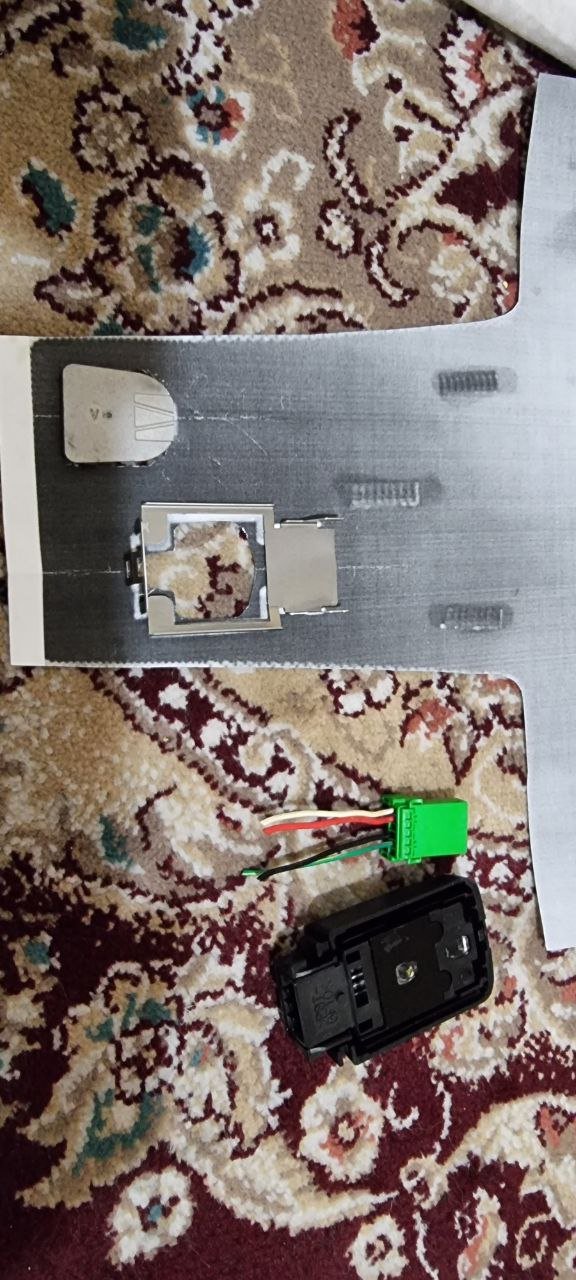

and last but not least:

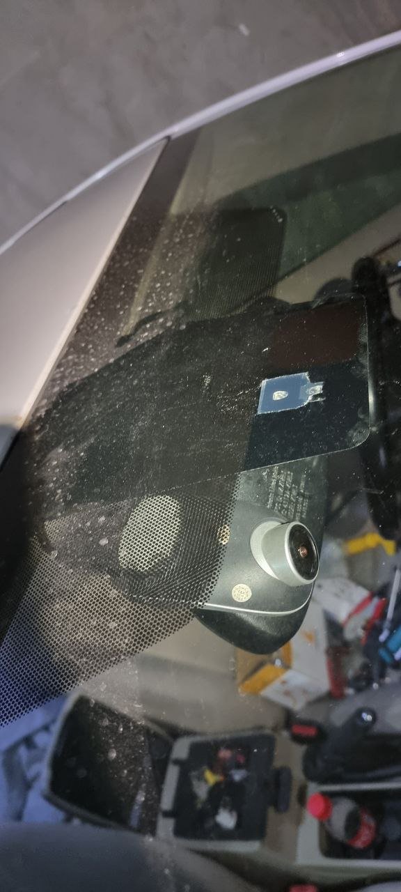

4- create a back plate to install on my front glass like OE and also use glue to mount the bracket and velcro fastener.
