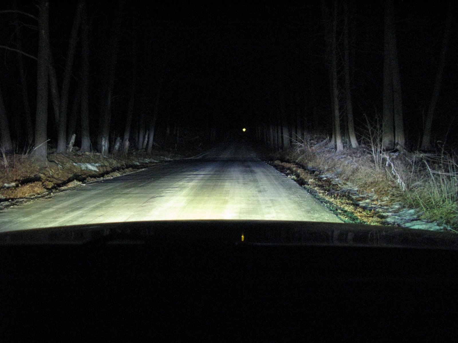

Fog light bulb type and color temperature is really up to personal preference, IMO. While you are right that a color more warm/yellow on the Kelvin temperature scale is technically better to see through fog, not everyone deals with heavy fog to the point that it matters. Also keep in mind that many newer cars are now using factory LED fog lights with emitters that are the same color temp as the headlights (around 6000K). If color temp mattered so much in fog, I don't think they would do this.
The purpose of fog lights aren't to improve visibility down the road as much as help you see to the sides better. The beam for any proper fog light is low and wide. The main purpose is to illuminate the lines on the side of the roads (technically called fog lines) so you keep in your lane in dense fog. Any bulb or color temp that helps a driver through this would be an effective fog light. Now it's believed that warmer/yellow lights helps the human eye see through fog better with less glare so classically, many fog lights were halogen and some even deliberately yellow. Many 90's and 00's Japanese cars had factory yellow fog lights that basically became a "JDM" style signature.
I personally have 3000K (golden yellow) HID bulbs in my fog lights. I love them. They are very bright and illuminate the immediate front and sides of the road very well in dark conditions. However, I don't drive very much in thick fog and one important factor with fog lights is not to have something too bright that causes glare and reduces what you can see in the fog. This is why it is not advised for drivers to use their high beams in fog.
So in the end, I don't think LED vs. HID vs. Halogen matters so much with fog lights. I also don't think the color of the bulb matters so much either. I think it's more about tailoring the best type of bulb and color for the conditions you will use them in. For me, I only really use my yellow fog lights on rainy nights or on dark roads without street lights to boost visibility to the sides of the road. Actual use in fog is a very rare occasion for me.
Below is an old photo from my Kizashi but it demonstrates what my fog lights are like with yellow HID bulbs.
